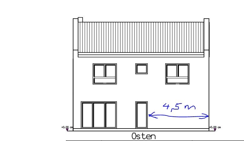

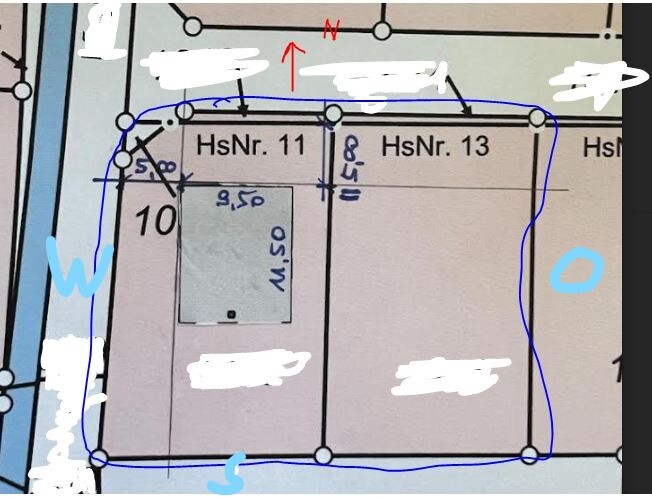

The requested changes have been submitted to the planner. Currently, we are unsure where to best place a double garage (6 x 8.5 m (20 x 28 feet)) on the property. The current idea is to position the garage with the driveway facing north on the east side of the house. We cannot place it directly east of the house, as that would block the floor-to-ceiling kitchen window (see attached graphic). Now the question is how much distance to leave from the house (for example, 4–5 m (13–16 feet)) or whether to push it all the way to the eastern property boundary. That would result in quite long paths to the garage/workshop. I would appreciate any opinions or other ideas.

The requested changes have been sent to the planner. Currently, we are unsure where on the property to best place a double garage (6 x 8.50 m (20 x 28 ft)). The current idea is to position the garage with the driveway facing north on the east side of the house. We cannot place it directly east of the house, as that would block the floor-to-ceiling kitchen window (see attached graphic). Now the question is how much distance to leave from the house (e.g., 4–5 m (13–16 ft)) or whether to push it directly to the eastern property boundary. That would mean relatively long paths to the garage/workshop. I would appreciate any opinions or other ideas. 🙂
Sorry, but you’re thinking about this quite early. I already shared my opinion in post #29. And yes, as you’re realizing now, you can’t plan a house without considering the outbuildings. Even at 8 m or 10 m (26 or 33 ft) distance, the garage will still cast shadows on the kitchen.

It wouldn’t work as you suggested either. In your proposal, the garage would need to be moved 5 to 6 meters (16 to 20 ft) further south to allow for a driveway and to maintain the 5m (16 ft) setback from the street. We also wanted to close off the west and north sides because streets run along those sides of the corner lot. Your suggestion would have left the west side too "open" for us. Originally, we had a floor plan where the kitchen, dining, and living rooms were aligned facing south.

It was important for us to close off the west and north sides since roads run along those edges of the corner lot.
Are the roads heavily trafficked?

No, these are not main roads. However, the sidewalks are quite busy because there are larger apartment buildings at the end of the streets.

No, these are not main roads. However, the sidewalks are quite heavily used because there are larger apartment buildings at the end of the streets.
Well, that's actually what hedges were invented for.
