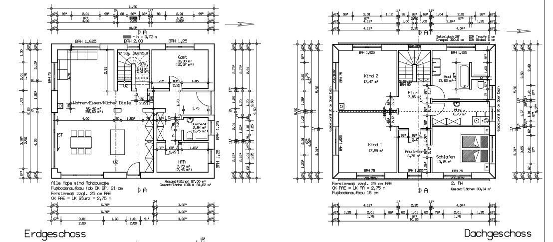

holm667Hello everyone,
We are currently in the schematic design phase with our architect and now have a design draft that largely meets our requirements and that we like. I would be interested to know if you see any potential for optimization or if there are details/distances that seem completely unrealistic or impractical.

Welcome to the forum,
I like your floor plan, compact in square meters and spacious rooms.
I would also skip the fireplace (play area for the kids),
I would attach the island to the bottom as a peninsula,
the sofa facing the garden,
the utility room (still sufficient) gives 2m² (22 sqft) to the hallway, which it needs with 4 people,
just minor details, the house works well.

Essentially a standard floor plan that works well overall. In general, I find it incomplete to review a plan without considering the plot.
What I would consider:
- The guest toilet door opens into the cloakroom: At parties or similar events, someone might still need to use the toilet before leaving home while others are already dressing -> The door will get damaged.
- The centrally positioned bathtub on the upper floor, together with the towel rack, leaves only about 70cm (28 inches) of clearance in the passage to the toilet, which feels cramped.
- The master bedroom with the walk-in closet also feels unnecessarily tight. The closet is 1.01m (3 ft 4 in) plus two times 62cm (24 inches). If you place cabinets or sideboards on both sides, it becomes too narrow and feels like a storage space you have to pass through. If you only put a cabinet along the long wall, you should question the added value of the walk-in closet.

K a t j a schrieb:
There is a shower in the guest bathroom? How large is it?...and above all: How is it planned in relation to the other bathroom fixtures and the window? I can’t quite picture it...SoL schrieb:
In general, I find a floor plan incomplete without considering the plot.I agree. I like the layout at first glance. However, the window sill heights are missing or not readable.SoL schrieb:
Guest WC door opens into the cloakroom: during parties or similar, someone might still use the toilet before going home, while others are already dressing -> someone ends up blocking the door.This is overrated. My bathroom door has opened into the hallway for over 10 years. There have been no collisions with guests leaving the house. Given the bathroom size, it is actually a significant functional advantage if the door opens outward.Nida35a schrieb:
I would attach the island as a peninsula at the bottom,No... there is really enough space for a full island here, which is very practical because there are always two pathways to the kitchen workstations/appliances.K a t j a schrieb:
Looks good. I would probably swap the bathtub and the washbasin in the bathroom and rotate the bed in the bedroom so the headboard is on the upper wall of the plan.I completely agree. The partition wall between the dressing area and bedroom could possibly be moved about 20cm (8 inches) to the right on the plan, with the dressing area/bedroom passage shifted downward on the plan. Swapping the bathtub and washbasin would also allow natural light to fall sideways onto the washbasin.Guest bathroom... I would probably place a smaller, very narrow window along the top of the plan. Then you could have a walk-in shower with a 70cm (28 inches) glass partition toward the toilet. Unfortunately, here too the dimensions are hard to read and mostly guesses have to be made. 😉
Nida35a schrieb:
the couch facing the garden,It probably already does, since I assume the garden is along the bottom of the plan. Though I just noticed the sliding door is on the left side of the plan — the site plan is missing here.Similar topics
