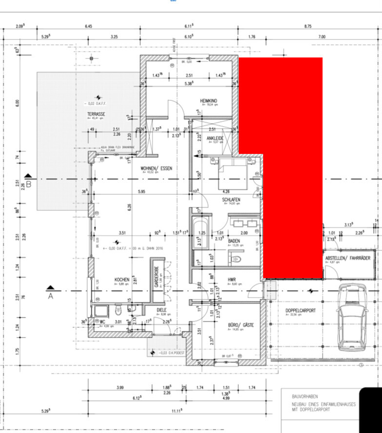

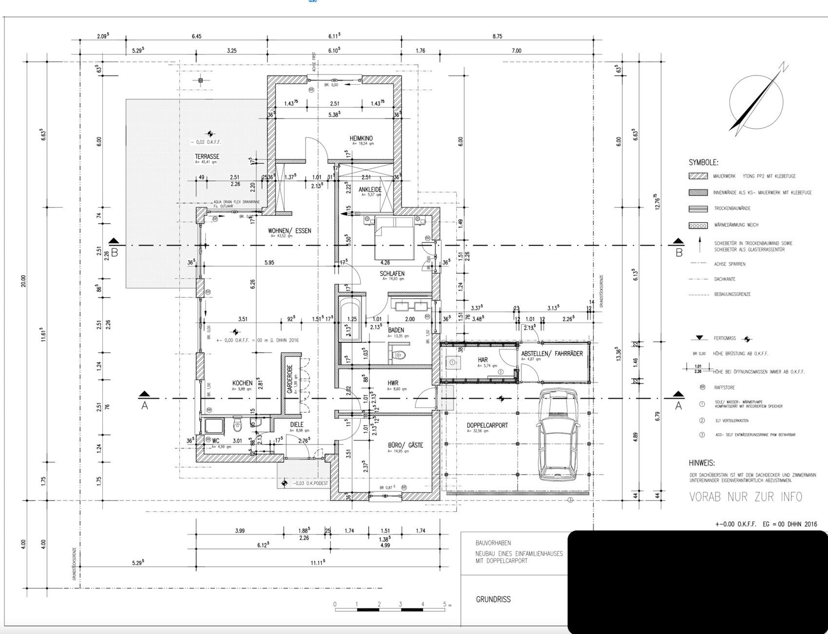

Sorrow87
28 Jul 2022 22:10
It was quiet for a long time regarding the thread I created, partly due to the intensive search for planners and companies. We have found an architect and planned our floor plan together. I would like to thank you again for the many tips. We have taken several of them to heart. We are very satisfied with the design, which includes all of our wishes and will also stay within our budget.
I need to change the thread title because the area is now only about 146 m² (1570 sq ft). The technical room (HAR) with the heating system (geothermal and hot water storage) was placed outside the main house and the actual foundation slab for more effective use of space inside the house. To better accommodate the guest toilet, the kitchen’s southeast orientation was given up. The guest toilet was ultimately equipped more generously than originally planned. After all, it wasn’t even planned by us 😀
We have abandoned our desired fireplace. The chimney shaft is not marked on the plan. It is located in the living/dining area on the interior wall to the bedroom, approximately 1 m (3 ft) above section B.
The ceiling will be insulated as a wooden beam ceiling and finished with plasterboard panels.
The roof will be a purlin roof with a simple standing truss, pitched at 22° (22 degrees), and covered with matte anthracite clay roof tiles.
All other relevant details should be visible on the design.
We would be happy to hear any opinions on this draft from anyone interested.

Würfel*
29 Jul 2022 11:17
I don’t like the layout and placement on the plot at all. The area marked in red is wasted space; you could place the house there and move it away from the neighbor’s southwest side accordingly, so the terrace wouldn’t have to be so close to the boundary. Right now, the home theater has the best spot on the plot. A living room or kitchen-dining area with a large southwest-facing window would be much better positioned there. Anyone familiar with Feng Shui would be horrified. Living room = walk-through room, bedroom = walk-through room with 3 doors. But try drawing in the furniture for the kitchen and living/dining area so we can understand how you envision it.

Neubau2022
29 Jul 2022 12:42
I won’t comment on the floor plan since I didn’t like parts of mine either :-) Since we are also building a 138 sqm (1,490 sq ft) bungalow in the south of Berlin, I can offer you to take a look at it. Maybe you can pick up a few ideas or say, no, I definitely don’t want that 😎
