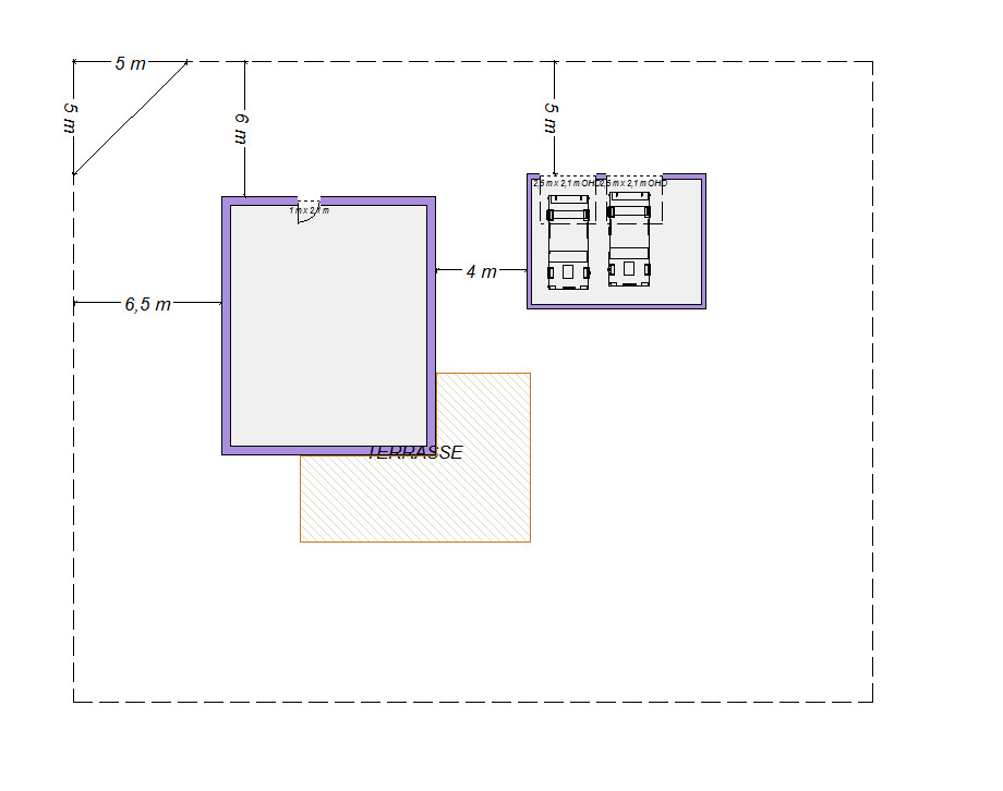

K a t j a22 Mar 2022 14:11
As mentioned, there have been worse situations.
Here is a rough sketch with some dimensions: garage 6 x 8m (20 x 26 ft), house 11.50 x 9.50m (38 x 31 ft).
Site plan: outer boundary, house with terrace on the left, building with two vehicles on the right.
The west-facing sun is basically blocked out – usually the most important part of the day for most workers. Also, the garage seems to be the central building – too prominent for my taste.

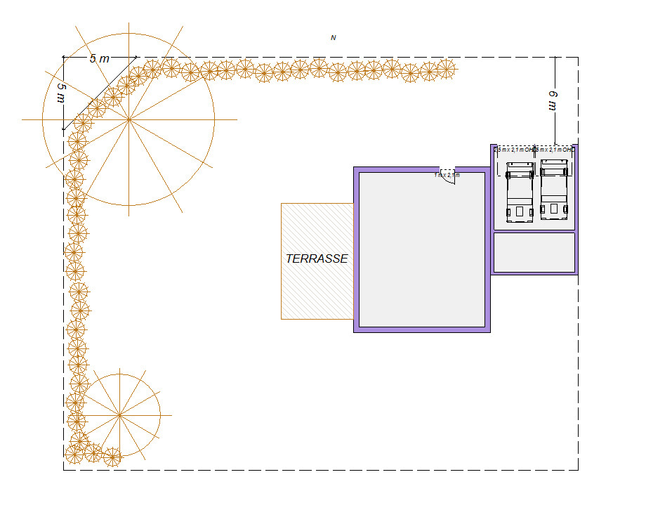

If it were mine, it would probably look something like this:
Floor plan of a house with terrace, garage for two cars, and surrounding grove of trees.
gutentag22 Mar 2022 14:30
I would base the location of the house on the development to the south. Possibly even move the house slightly further north.
