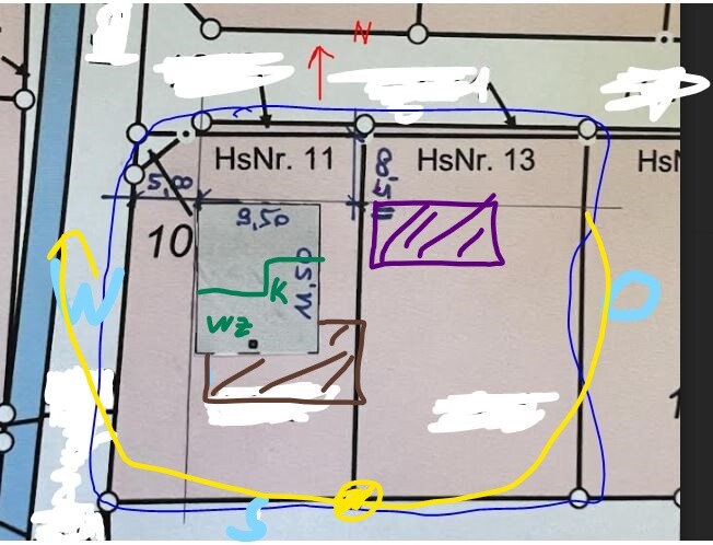

I have attached a drawing again. I have marked the planned terrace in brown, the garage in purple, and the open living/kitchen/dining area in green. If you look at the sun path (drawn in yellow), sunlight should still reach these areas despite this orientation, or am I mistaken?
Site plan: plots house numbers 11 and 13 with color-coded areas and outlines.
K a t j a21 Mar 2022 18:15
Is this supposed to be a single garage placed sideways? I find it hard to imagine fitting the curve there. Or is it just drawn more attractively than it really is?
A double garage is about 6x6m (20x20 ft). That would extend over more than half of your house on the east side, and that doesn’t even include a bike shed or something similar. I’d say that’s only semi-optimal.
It won’t be pitch dark because the southern sun will peek around the corner. But the sunlight still has to pass through the entire depth of the house to reach your kitchen cupboards. That’s just not as bright as it could be. It’s simply a matter of priorities. I don’t quite understand the fear of neighbors’ views. Sure, you have to wait 4 to 5 years until the hedge provides privacy, but what are a few years compared to a lifetime of shade? I also wouldn’t like the location of the terrace. That would be too close to the street for me again. Without a hedge, it would feel almost exposed and unprotected. 😉
But whatever – the customer’s wish is their kingdom. Otherwise, the floor plan is fine.

And always keep in mind the summer, when you might want to get a bit of sun from the west, which is often from the northwest. And then you end up sitting by the street.

I’ve attached a drawing again. I marked the planned terrace in brown, the garage in purple, and the open living/cooking/dining area in green. Considering the sun path (drawn in yellow), there should still be sunlight reaching these areas despite the orientation, or am I mistaken?
No, this is just a sketch. The garage is planned to be 6x8 m (20x26 ft) with the width being 6 m (20 ft). I will create a scaled drawing soon.

Orientation towards the sun in these areas – am I getting this right or misunderstanding something?
holm667 schrieb:
The sun should then be on the south terrace until the evening from the west side (see attachment).
No, you are mistaken. In summer, the sun sets in the northwest. West is around 6 PM. With this setup, your house will cast a shadow over your garden. Especially the east side will be dark in the evening, while the west and north sides get evening sunlight.
Also, placing the living area facing the busy street isn’t ideal. You’re trying to reinvent the wheel.

So, I have now accurately drawn the house and garage to scale on the plot. The house is located 6 meters (20 feet) from the northern boundary and 6.5 meters (21 feet) from the western boundary of the property. The garage is positioned 5 meters (16 feet) from the northern boundary and 4 meters (13 feet) beside the house.
