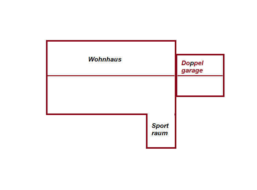

What you should keep in mind with your DIY insulated garage is good ventilation. When training, you will sweat a lot, and this moisture needs to be removed quickly. If you only heat it partially, the masonry stays cold, causing condensation on the ceiling and walls, which can eventually turn into stalactite-like formations. In my multipurpose room, the windows were fogged up after a recent workout.
I would integrate the room into the house. Sometimes you see design solutions where the gable roof on one side is extended lower to create a terrace. Instead of the terrace, you could build walls and windows around that area.

Would it then look something like this?
The only question is whether it would be too tall with a two-story house (ground floor plus one upper floor) with a gable roof. It might be worth drawing a side view or perhaps the roof over the workout room could have a steeper pitch than the regular gable roof?
Thanks again for the inspiration.
