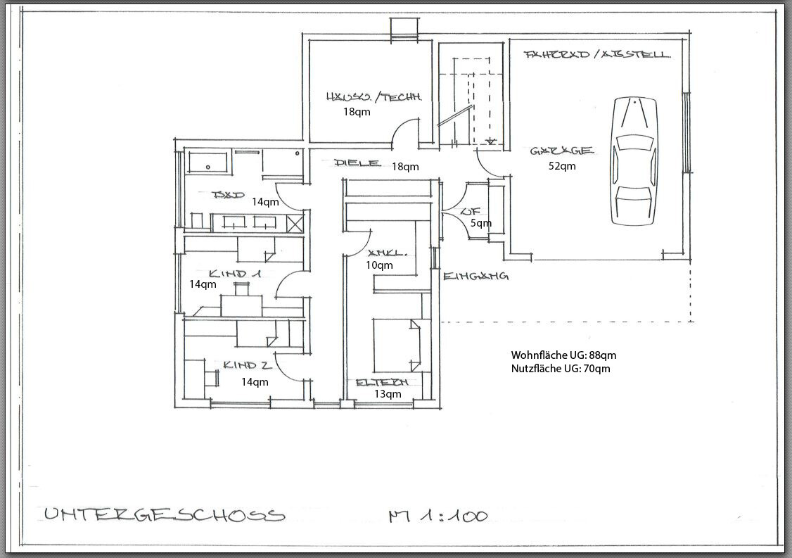

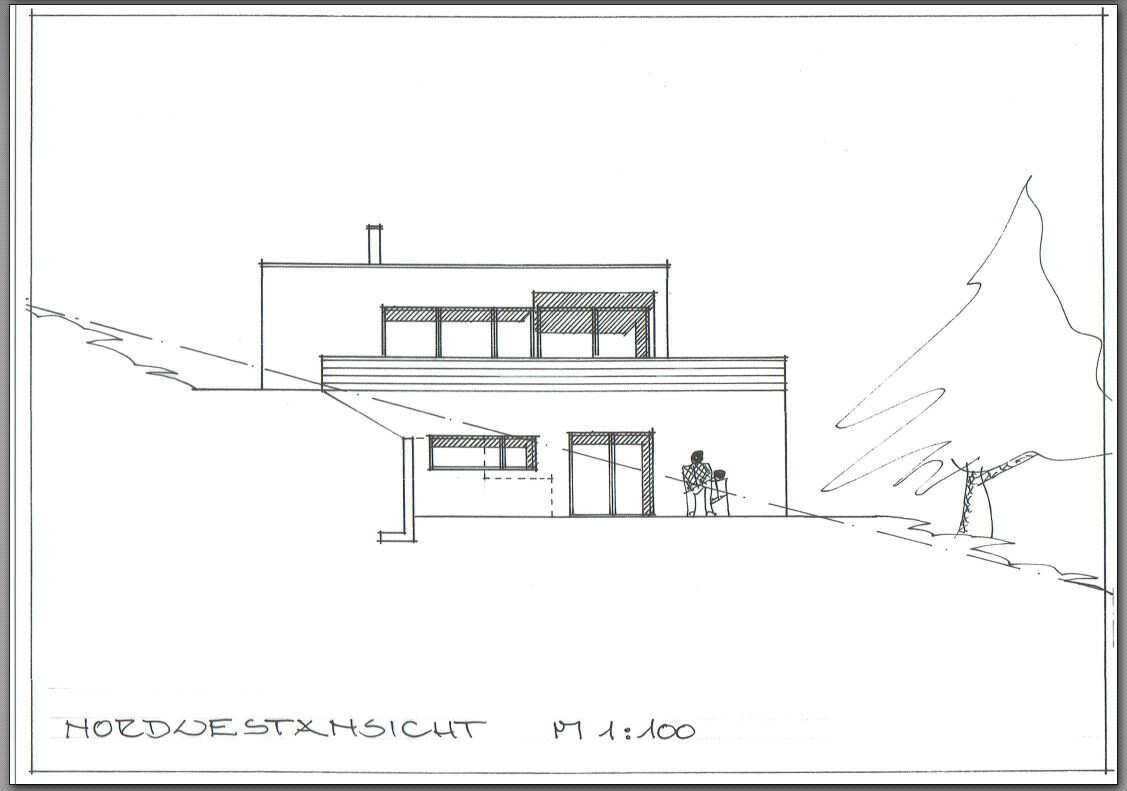

we recently received the first draft of our house from the architect and would appreciate any optimizations, suggestions, and opinions. Overall, the design already matches our ideas quite well. But first, here is the completed questionnaire.

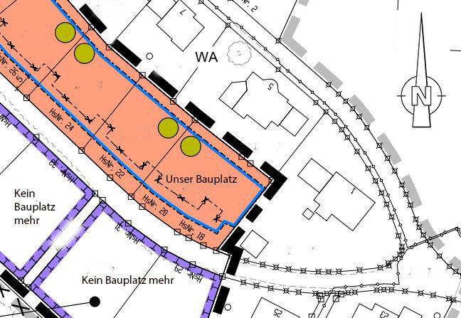

Plot size 856 sqm (already owned/purchased)

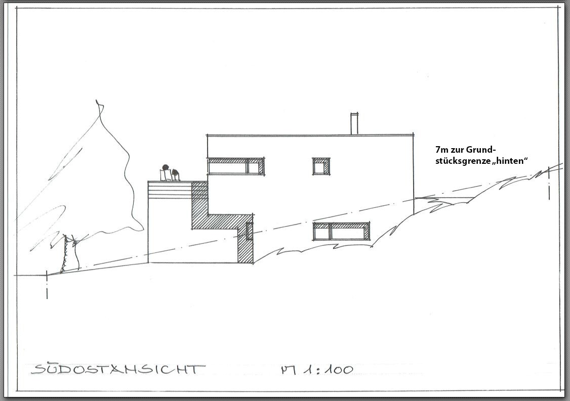

Slope Yes, rising from southwest to northeast. On the west side the slope is about 8 m (26 ft) over 30 m (98 ft), on the east side about 6 m (20 ft) over 30 m (98 ft). Unfortunately, the street slopes downward.
Site coverage ratio 0.35
Floor area ratio 0.7
Building envelope, building line and boundary Marked in the development plan (blue line)
Setback distances According to Art. 6 BayBO

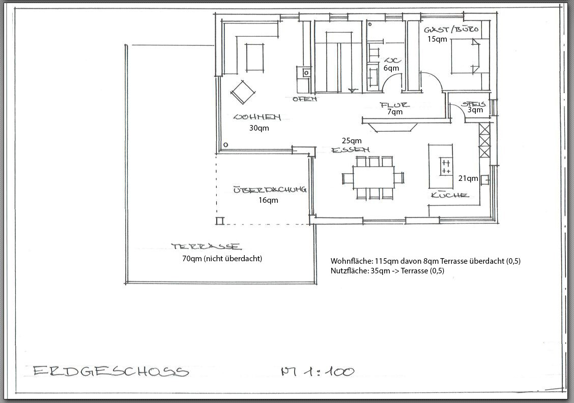

What do you particularly like? Why? Open living/dining area and open kitchen with island, large partly covered terrace (maybe a bit too big), large floor-to-ceiling windows facing south
What don’t you like? Why? Slightly too large and costs too high. Long corridor in the basement ("tube-like"). Children’s rooms possibly a bit small. WC on ground floor somewhat small.
Price estimate according to architect/planner: €470,000 excluding additional building costs and land
Personal price ceiling for the house, including fittings: about €500,000–550,000
Preferred heating system: Air-to-water heat pump with underfloor heating
If you had to give up something, which details/expansions
– could you give up: Change from flat roof to single-pitch roof -> saves about €10,000? Smaller living area
– could you not give up: Large terrace, open and modern style, walk-in closet
Why does the design look like it does now? Fritsch
The architect implemented the requirements well based on images. The modern style, large windows, large terrace, and the ground floor overhang above the basement creating a covered entrance area are all liked.
Thank you in advance for your support.
Have a nice evening.
- How can we reduce the floor plan size? The architect suggests only minor changes at the front on the ground floor to keep proportions.
- We are also considering swapping the bedroom with the office and keeping the children’s rooms in the basement for later peace from partying teenagers. Or placing the bedroom and another room on the ground floor for early years with children nearby and swapping with the office later. Or leaving it as is and maybe swapping bedroom and office later.
- Does anyone have experience with terraces above living rooms? Are they watertight? We are considering having the terrace slightly overlap the ground floor as a roof—would that be too dark?
- Any suggestions for changing the basement corridor? It would be nice to have a side exit at the end of the corridor.
- Any other general optimization suggestions? What do you dislike or do differently?
I don’t think the door to the garage is bad at all and actually quite practical. If it fits, you can go for it. Bending it is not worth it.
There is no smell unless you’re happily working on a classic car and like to keep the engine running. A fire-rated door will be installed in between, which can also pass the blower door test. The standard option is those nice gray cellar doors.
I don’t like the basement level. However, I do like having the entrance directly opposite the stairs. This keeps the private areas private.
The hallway is unacceptable. No matter how I try to rearrange it in my mind, it doesn’t really improve.

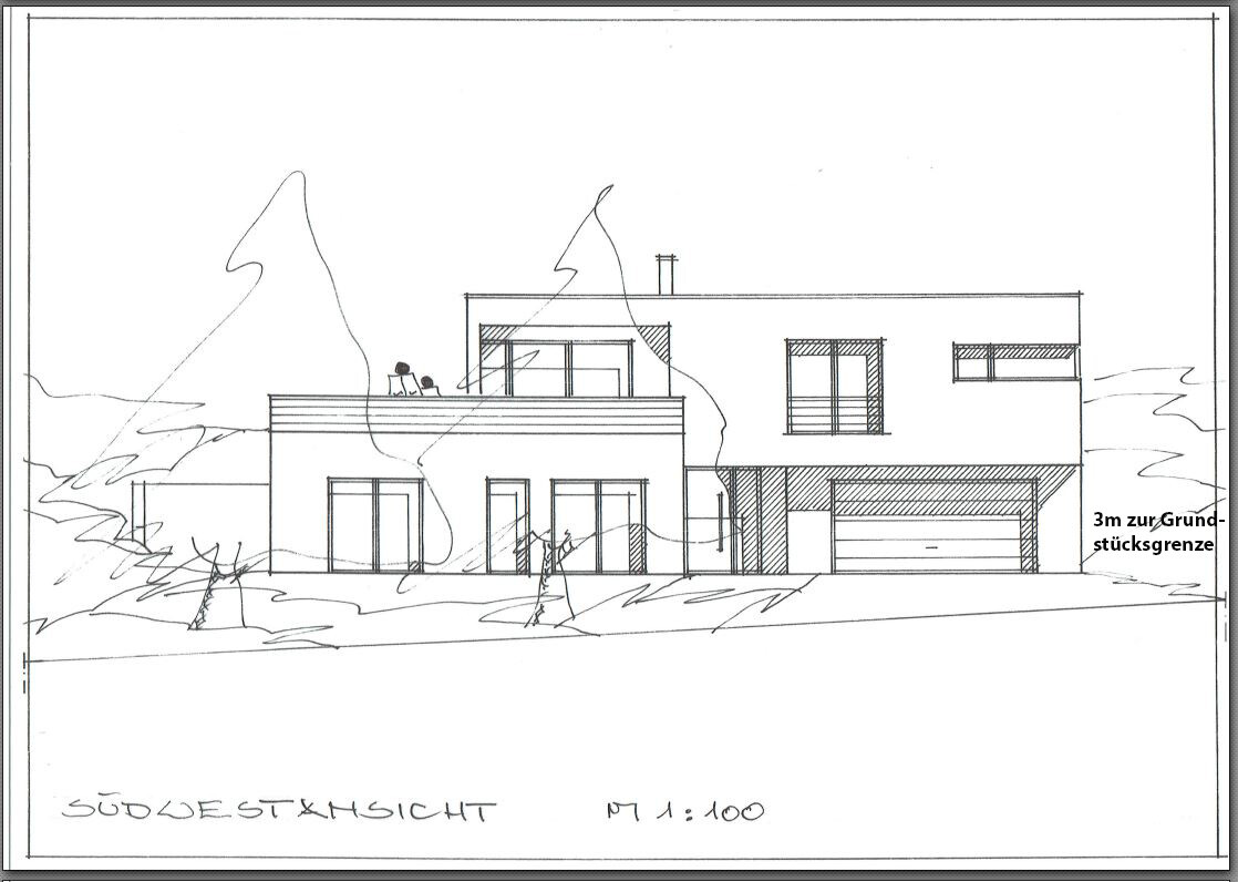

Which type exactly: with the same slope as the terrain, steeper, flatter; built downhill, uphill, or crosswise to the slope; single-pitched (shed roof) or double-pitched (broken gable, also called "shed")?I don’t care. I think a flat roof belongs on a cube-shaped building.
haydee schrieb:
I don’t care. I think a cube should have a flat roof.If it’s not flat, then it’s no longer a cube – and if it doesn’t have three corners, then that’s not my hat.https://www.instagram.com/11antgmxde/
hampshire29 Jul 2020 17:54My conclusion: Pool your money and go for it—if possible. The design works well for people who need little private space but plenty of room for communal living. Yes, even with the long hallway, the door to the garage, and the large terrace. I get the impression that the design process involved good communication and that the architect was not trying to impose their own ideas, but rather aimed to create the right home for the family’s lifestyle.
If funds are lacking or causing sleepless nights, go back to the architect and discuss what can be done. They seem to be a good professional.
haydee schrieb:
If the appearance can be changed, I would try to plan the garage under the terrace and living spaces stacked vertically without any setback. I imagine this could achieve a similar cost saving as the shed roof and might even improve the overall look.
The structural engineering can completely blow your budget. In our case, the retaining wall/hillside exterior wall and the slab were designed with very heavy reinforcement. The floor between the levels also had to be made much more substantial. It ended up being a five-figure expense.
The landscaping depends on what you want. You have an 8 m (26 feet) difference in height. That doesn't disappear because of the house. Every level you add needs to be supported. And 90 cm (35 inches) in one area, 60 cm (24 inches) in another also costs money. Unfortunately, the garage must be located on the east side due to the gentler slope. We would prefer to have the terrace on the west side to enjoy the evening sun. I can’t say much about the structural engineering apart from what the architect has mentioned, but I will definitely bring it up at the next meeting.
We haven’t thought much about the landscaping yet, but I will also address that at the next appointment.
Regarding the roof: We could also consider a shed roof with a 5–7 degree pitch that follows the slope. This would also be beneficial for possible photovoltaic installation. Something similar to the Luxhaus – Pultdach Klassik 257. If it saves money as well...
