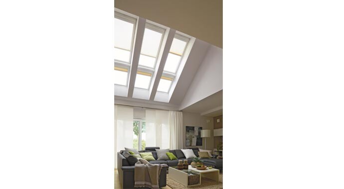

My idea was that no additional room would be planned above this particular space and that it would extend up to the roof. Your trusted architect can definitely manage that.
We have such a room on the upper floor, with a ceiling height of 3.20 - 4.50 m (10.5 - 15 ft).
RomeoZwo21 Nov 2019 16:45
This could look like this. The "standard" ground floor rooms are located beneath the attic (assuming a gable roof house with a ground floor and attic), and one room (sports room) is extended into the attic.
Bright living room with large skylights, gray sofa combination, cushions, and coffee table.
But I also think that around €50,000 for the 18m² (194ft²) with a special ceiling height could be reasonable (€2,780/m²).

Hmm, alright, then you might have to reduce the originally planned ceiling height from 3.20 meters (10.5 feet) to about 2.80 meters (9.2 feet).
Maybe next to the garage after all? Hmm.
