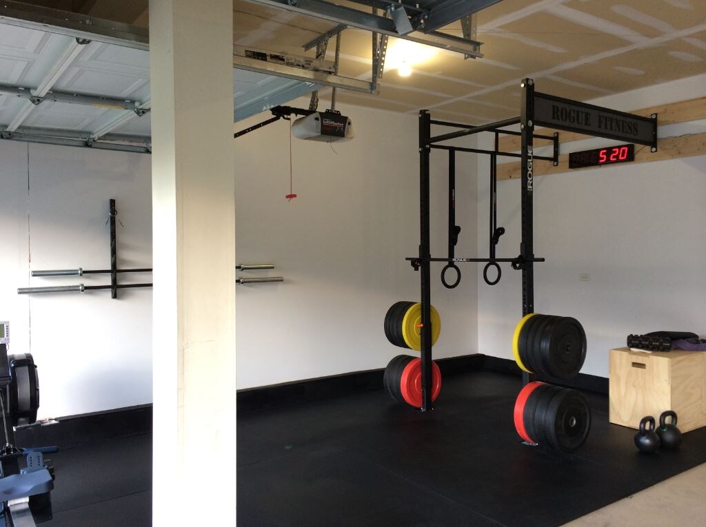

Basically, the room should look somewhat like this. However, not like a typical garage, but as a single room (although with a roller door or a wide door and windows for good ventilation). A single room would also be better for heating purposes, right?
