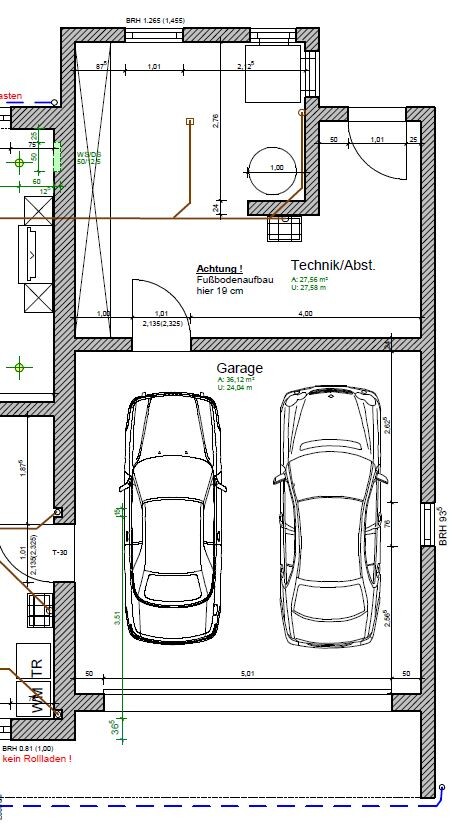

So, as I understand it, this is about setback distances. A building requires a certain distance from the property boundary, usually 3 meters (10 feet). This distance increases proportionally if the house is taller, meaning the difference between one- and two-story buildings.
If you have a two-story house, it must be positioned further away from the boundary. This is related to the height of the external wall facing the neighbor.
Secondly, an exception to setback requirements applies to garages: they are allowed to be built within the setback zone. However, the garage must be considered a separate building.
Your example may already not comply because the part of the building with the utility room and bedroom does not meet the setback distance to the neighbor. If you separate the garage including the storage room, the garage would be considered detached, but I wouldn't want to guarantee that. The size of this unit itself might no longer be permitted either.
Furthermore, I want to emphasize for the third time that you are exceeding your budget. Consider that this garage including the extension will likely cost around 30,000. For every element, you should plan for 5,000 to 10,000, the staircase as well, the 180-cm (71-inch) chimney about 15,000, and every square meter (square foot) around 1,700.
But I’m not a cost expert here.

However, the garage must be considered externally as a separate building. I believe this depends on the interpretation of the respective building authority.
Our architect initially planned our garage on the property line. From the beginning, it was connected to the main building (in the first design without windows on the right side, but unfortunately I don’t have a digital version of that):
Otherwise, I agree with @Climbee and @ypg: Write down your list of requirements and schedule a free initial consultation with an architect. If you get along well with the architect, they might also provide you with a preliminary design. It’s also worth contacting a local general contractor.
You already have the orientation on the plot in mind, which was the main point here. For everything else, I would give the architect or planner some creative freedom.
Jochen104 schrieb:
A T-30 fire door has to be installed there.Exactly!
However, no living area is allowed _within_ these setback zones.
But as I said: partial knowledge is why architects exist!
