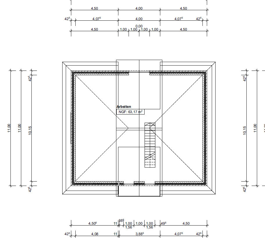

I would suggest experimenting a bit with the staircase. It is positioned in a way that makes the upstairs hallway and the narrow wardrobe area feel like leftover spaces. If the cupboard and staircase downstairs were swapped, the whole layout would feel more spacious. You want a generous villa, which is fine, but the overall impression is spoiled by tight spots.
Putting the kitchen aside for a moment, despite it being non-ergonomic and a counter being preferable to that small table, if I remember correctly, this kitchen is quite far from the previous one. There are also significantly fewer windows there.
Have you furnished the open-plan living area? You wanted a fireplace with seating separate from the TV area; does everything fit comfortably?
The narrow hallway leading to the children’s rooms upstairs feels cramped, although a teenage wing does have its appeal. The orientation of the children’s rooms is a no-go for me. What are your plans for the master bedroom? The master bathroom, in relation to the bedroom and dressing area, is small and functional.
I would recommend consulting a professional planner. Provide your wishes, and they can find the balance between individuality and good marketability.

Hello, we’re back,
We planned to design the bedroom as a kind of suite with a separate seating area. The room divider is meant to hold the TV, which will be mounted on a swivel bracket so you can watch a movie from the bed.
We didn’t really consider a workspace there. The studio in the attic is intended as the home office.
We did and made changes to the layout in the new design accordingly.
We actually like the balcony for getting some fresh air. With its west-facing orientation, it should also get plenty of sun. It measures 3m (10 feet) wide and 2m (6.5 feet) deep. We think the space for two chairs and a small table is more than enough.
The balcony at the entrance mainly serves as a roof over the front door.
Now I’ll attach the further changes, so please keep the comments coming.

I prefer the new ground floor layout; it feels more balanced. The kitchen also looks good. But what I don’t understand is why you need four different seating areas on the ground floor. This unfortunately makes the living room feel cramped again.
I don’t know what kind of surroundings your house will have, but I wouldn’t find a balcony facing the street very appealing for sitting outside.
Edit: Wait, that’s not the parents’ balcony after all. You’re even planning two balconies?
