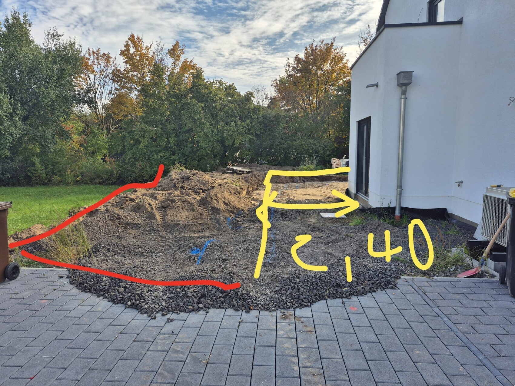

Bauherrin12318 Oct 2025 22:08Hello everyone,
Today, an excavator was here to remove the soil where the terrace will be. It was done a bit generously, and tomorrow we need to submit the plan showing the exact size of the terrace. I will take a final look in the garden tomorrow, then we’ll decide.
The main terrace will be about 8.5m by 4.20m (28 feet by 13.8 feet), and on the side, I’m considering a narrower width, around 2m or 2.40m (6.5 feet or 7.9 feet) maximum. Then it can be connected at the corner.
Anyway, I have two questions:
Would you recommend installing a splash guard along the house facade? On the side, outside the window, there are sections of the house wall measuring 4m and 2m (13 feet and 6.5 feet), and the installers all recommend different things.
The tiler wants to create a slope away from the house wall, without a drain channel. I know an architect who said a drain channel is necessary and definitely no slope, otherwise doors and furniture would wobble. What do you think? The main terrace will be covered; the side terrace will not.
Also, we need to remember that if we want electricity somewhere in the garden, we should run the cable under the terrace to have power at the other corner of the garden.
Is there anything else I should consider or not forget?
Bauherrin12319 Oct 2025 15:11Hello,
How would you build the terrace? I have large slabs measuring 60 by 120cm (24 by 47 inches).
At the front, I am planning 4.20m (14 feet) deep, and the house is 7m (23 feet) wide, but I want it to be at least 8.50m (28 feet) long. I have roughly marked it on the picture: if I build the terrace 2.40m (8 feet) out from the bay window and extend the strip straight along as it appears, I also created a small planting bed in the corner. In total, it would be about 75m² (807 ft²). The idea was to have 3m (10 feet) only in the area of the bay window, and the rest of the strip narrower around it.
Is the terrace too large? I don’t want the whole area to be paved, but with all the corners we’re paving, it quickly adds up to 74m² (796 ft²). I’m also unsure whether I should have a splash guard installed.
