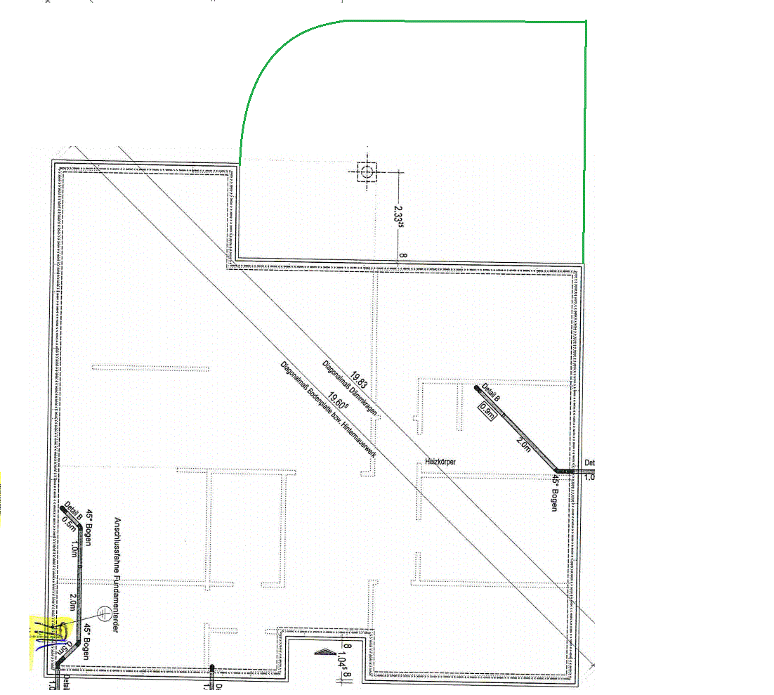

The terrace area will be almost completely exposed to the weather, except for about 4 sqm (43 sq ft) of roofing. This means a slight slope toward the garden will be necessary, as there will be no step at the terrace door.
I'm attaching a plan to give you an idea.
We have already laid RCL-I gravel on the surface, so later we will only need to pour a concrete slab or add sand on top.
Evolith schrieb:
I’m attaching a plan so you can get an idea.It’s a pity I can’t see more of your floor plan here anymore, it seems conceptually much clearer than most of what I usually see. Which house model did you end up choosing, and is it the half-hipped roof as you asked about last time?
