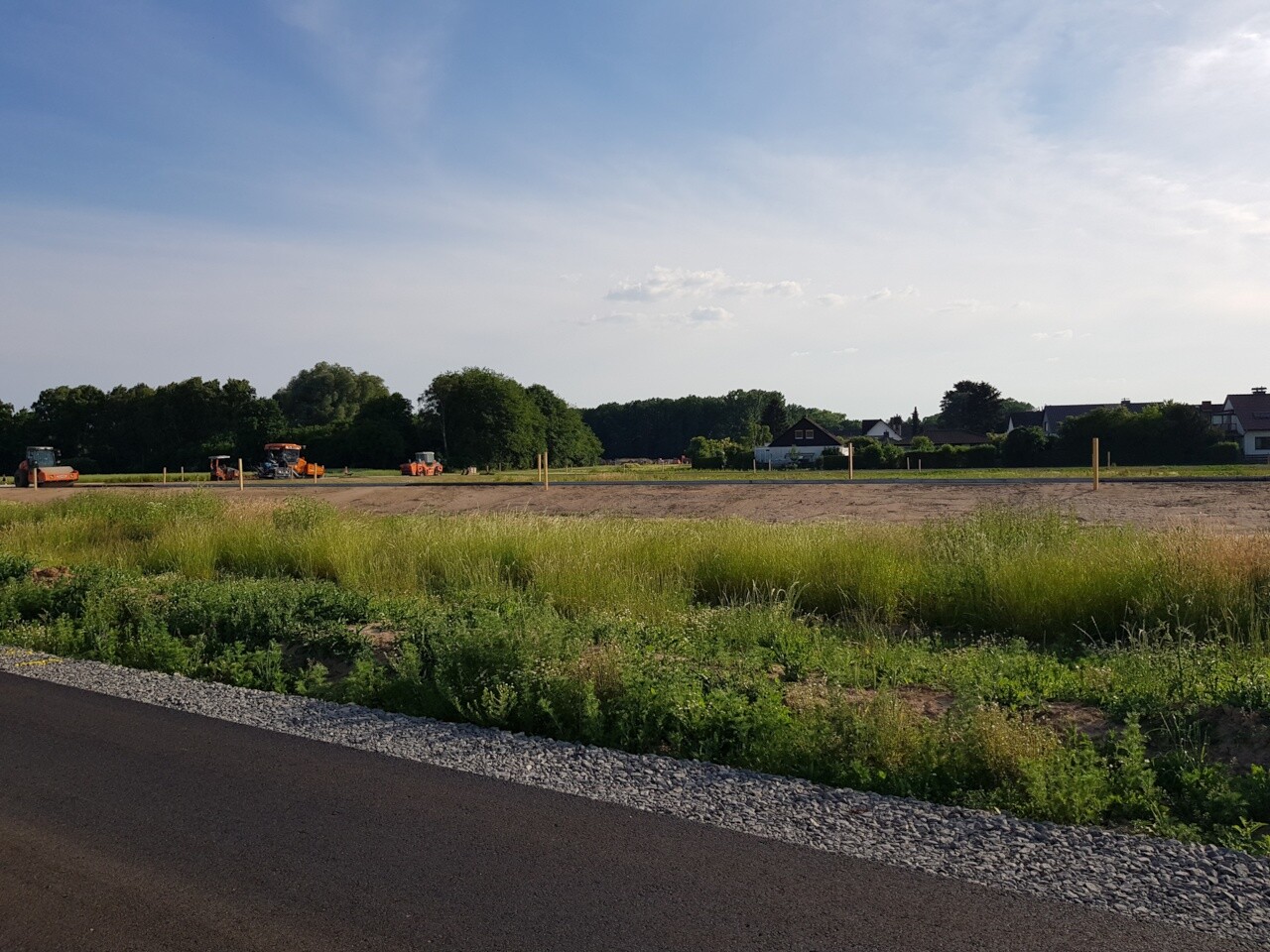

I have attached a photo of the current construction site showing the slope.

What do the sellers say about the elevations? To me, it looks like a construction access road, where additional paving could easily be added, raising the level further. However, the sellers should be aware of the elevation data... it seems like every property is facing this issue.
The finished road is probably still a bit higher than the construction road.
But about 1 meter (3 feet) around is nothing unusual. The foundation slab with insulation and a gravel bed easily compensates for that. You might have extra costs for backfilling around it, but in a new development area, it shouldn't be difficult to find excess material.
I wouldn’t panic about the costs at this point.

We only saw this yesterday and haven’t asked the seller yet. We’re waiting until construction is supposed to start next week. So far, we’ve only had preliminary discussions with general contractors and are roughly outlining the budget. If, for example, a basement becomes an option now, it would be good to know, because we had initially ruled out a basement and that would change quite a few things.
If I understand correctly, the additional costs should be manageable. It would mainly be the expenses for filling next to the foundation slab, and it might be possible to use soil from other projects, such as those excavating basements.
What do you estimate the costs would be otherwise? $5,000, $10,000, $15,000?
