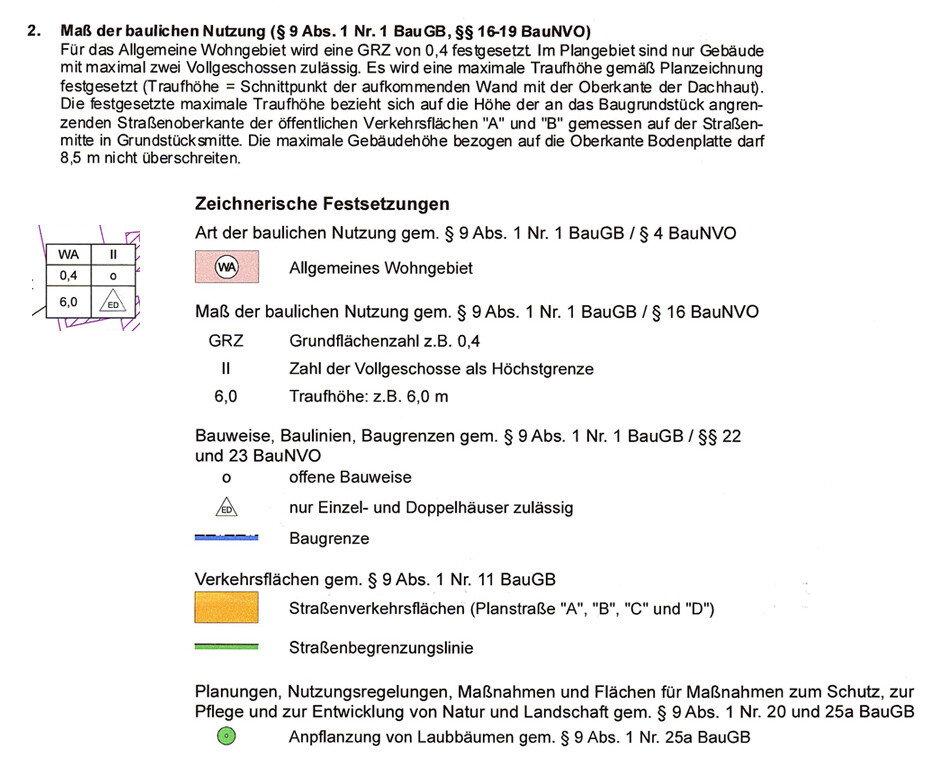

Hello Escroda,
no, that is not everything the development plan says about heights and reference points, but in my opinion, the other details refer to the eaves height.
There are no restrictions on roof types, so yes, flat roofs are allowed (and I guess that’s why they allow a basement plus 8.50 m (28 feet) ridge/building height).
I have attached a collage from my development plan that includes all the important information about my plot within the building area. If you or anyone else needs more information, please feel free to ask. At the moment, this is, in my opinion, all that I received when purchasing the plot or what is publicly available on the city’s website.

Without complete textual specifications and a detailed section of the plan drawing, it remains speculative, but I see confirmation of this in the above zoning plan excerpts: the reference point for building height is the top edge of the ground floor slab, not the basement floor slab; otherwise, the eave height of 6m (20 feet) above street level would not make sense. Depending on the base height, floor height, and roof design (knee wall, roof pitch, hip/gable roof), you have 2m to 3m (6.5 to 10 feet) of height available for a roof with sloped roof surfaces.
