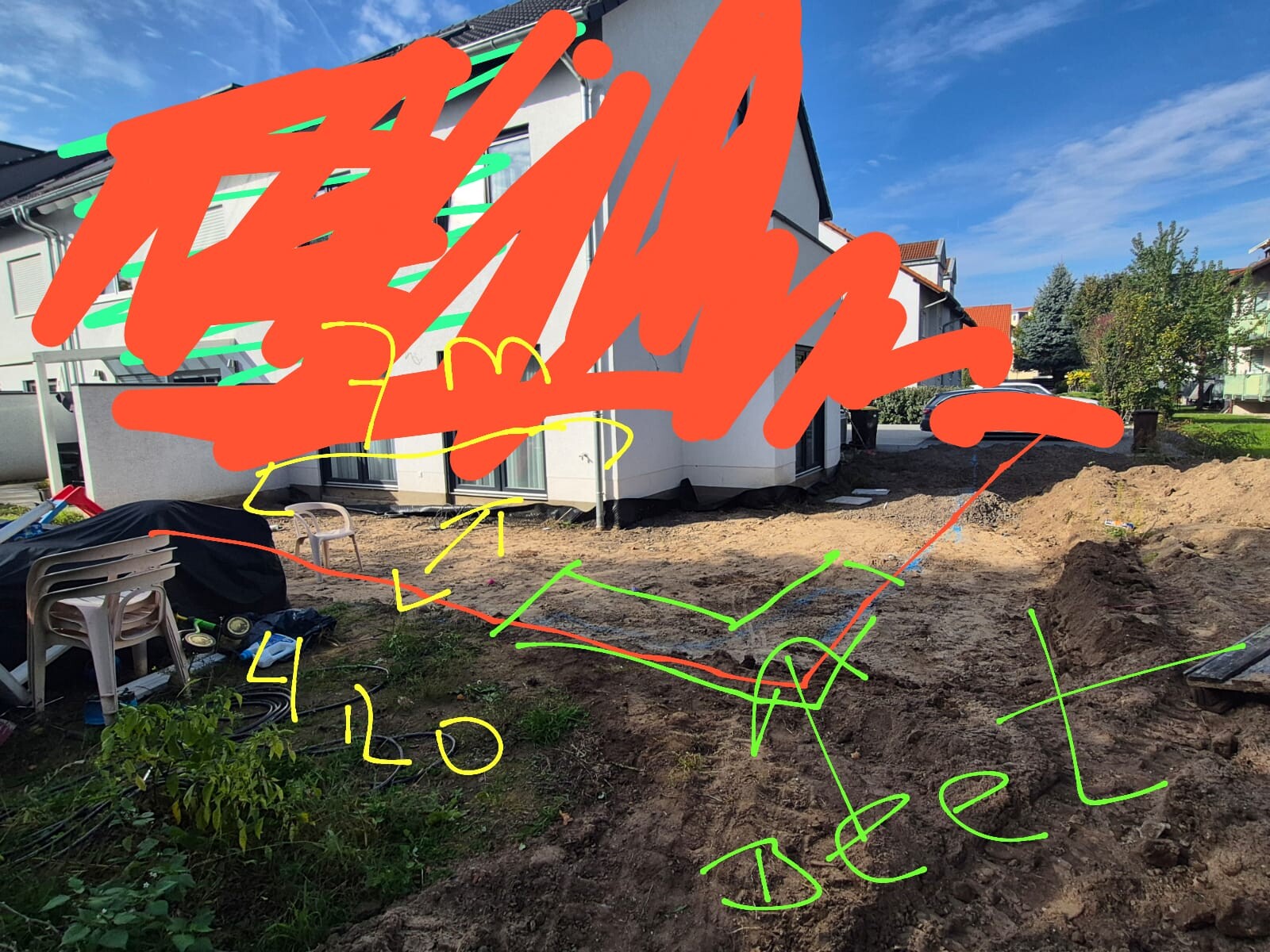

Bauherrin12319 Oct 2025 15:16Bauherrin123 schrieb:
how would you build the terrace? I have large slabs measuring 60 by 120cm (24 by 47 inches). So, at the front, I plan to build it 4.20m (14 feet) deep, and the house is 7m (23 feet) wide, but I want the terrace to be at least 8.50m (28 feet) long. In the picture, I’ve marked it out: if I extend the terrace 2.40m (8 feet) out from the bay window and stretch the strip straight along, as it looks. In the corner, I’ve also created a small planting bed. Overall, it would be 75m² (807 sq ft). The idea was to have 3m (10 feet) width only in the area of the bay window, and narrower strips elsewhere around it.
Is the terrace too large? I don’t want everything to be paved, but because of the corners we want to pave, it quickly adds up to 74m² (797 sq ft). And I’m unsure whether I should have a splash guard installed.One more picture, here you can see how it is supposed to look... B

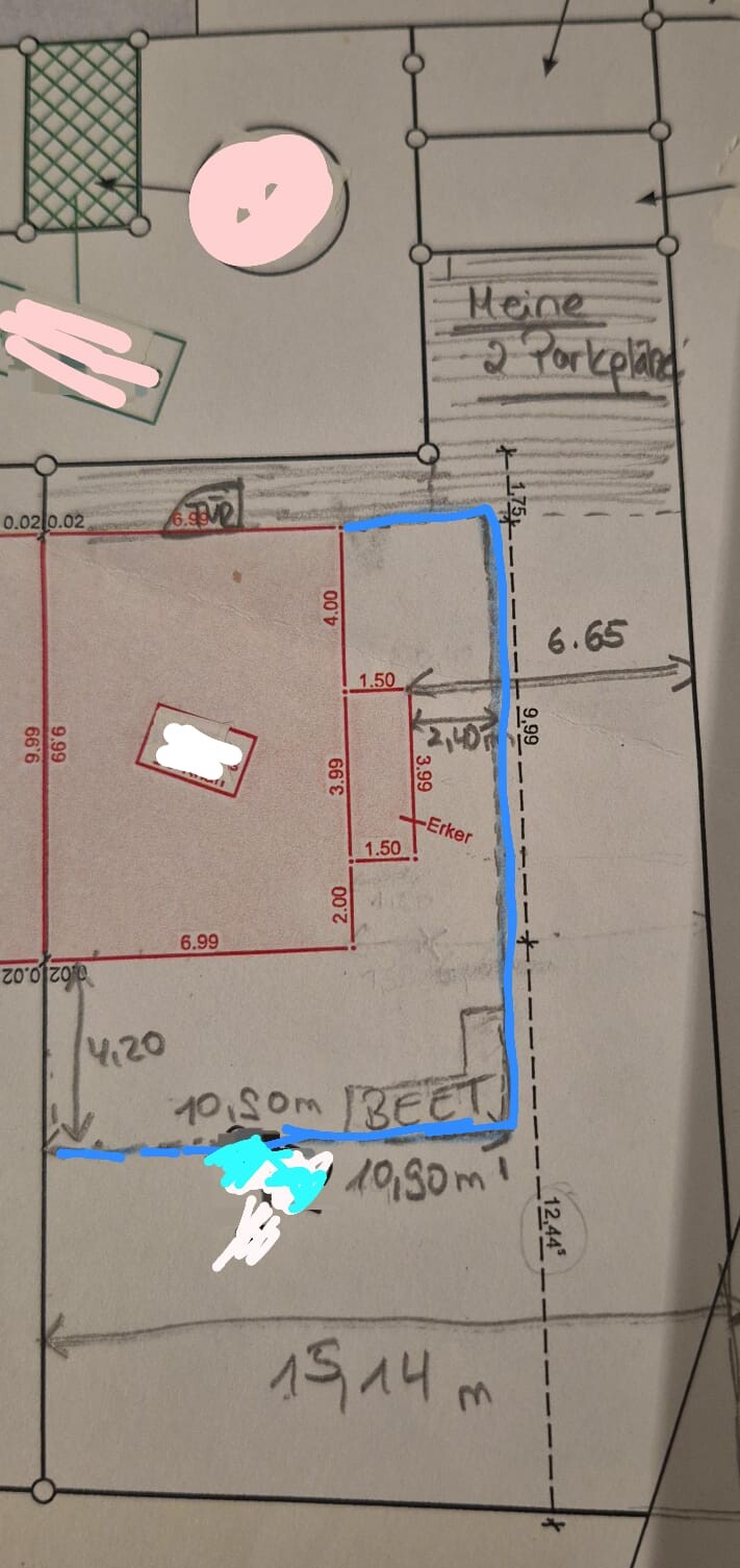

Bauherrin12319 Oct 2025 20:29Okay, I’ll upload it shortly.
The terrace is marked in blue. I’m not yet sure about the exact size of the flower bed. The proportions are not 100% accurate but should be roughly correct. The idea was whether to build the terrace like this or to extend the terrace from the bay window to 3m (10 feet), but then make the connection between the two narrower and different. I definitely want the flower bed, but I’m not sure if it should be like this or arranged differently.
Bauherrin12319 Oct 2025 21:01It would be great if someone could give me feedback by tomorrow. On Tuesday, I have to decide what I want. Also, where the tiles should be installed—120 by 60 cm (47 by 24 inches)—and whether I want a splash guard. This would only be around the bay window.

It would be great if someone could give me feedback by tomorrow. Well... your data is currently quite sparse... Where exactly are the patio doors located? Where is north, or is the plan oriented north? I don’t have all users’ data memorized. Also, I don’t yet understand why you want the terrace to extend across the entire length of the house. What are you expecting from that?
EDIT:
With a terrace depth of 420 cm (165 inches) and tiles measuring 60 x 120 cm (24 x 47 inches), the 420 cm (165 inches) should ideally be divisible by 60 cm (24 inches) so that no cutting is needed. The best approach is to create a detailed installation plan for this.
