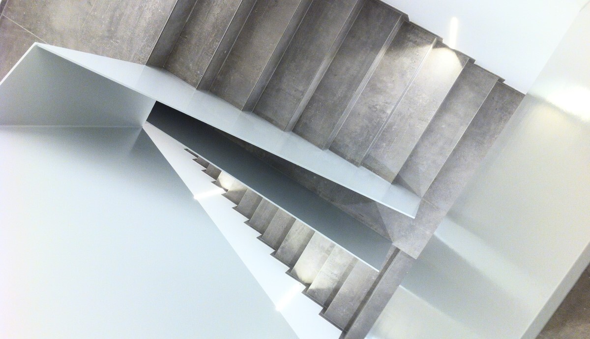

I am currently marking all the electrical boxes and switches. Now I have reached the staircase and was wondering whether a standard 60mm (2.4 inches) electrical box for the lighting should be installed there or if something special is needed. I looked around online but didn’t find a clear answer. Either the lighting looks cheap or it is very expensive (over 100 euros per piece).
Do you have any recommendations for me? I am also open to some kind of downlight.
