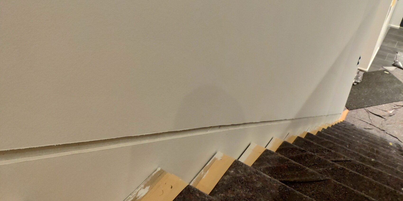

We will install a continuous light strip about 5cm (2 inches) above the steps for our straight staircase. The cost is around 40€ for the recessed aluminum profiles, 50€ for the LED strip, and 20€ for the 24v power supply... quite reasonable. It should be ready this weekend, and I can share some photos then.

KingSong15 Nov 2018 17:39
Mottenhausen schrieb:
This option seems easier to implement than, for example, 10 separate lights with individual power feeds.
I just don’t know how to make a perfectly straight groove along the entire length. There must be absolutely no bends or waves, as that would be immediately noticeable with LED strips.
Feel free to share more information and photos if you manage to install it. That’s exactly the solution I have in mind!
That depends on the wall construction you have. We have a timber frame house with drywall. It was simple for us—I used a 3m (10 ft) straightedge for the 5m (16 ft) staircase, placed it on the edges of the steps, and ran a router set to the correct depth along the surface of the straightedge. The result is a perfectly fitting groove in the wall. Now I just need to install the trim and LED strips this weekend.
