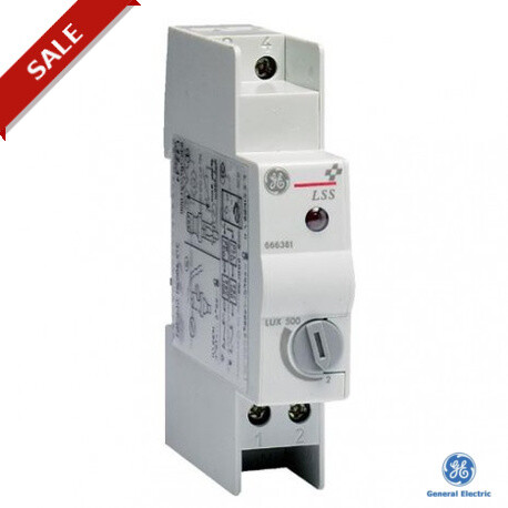

Obstlerbaum25 Jan 2019 22:03More is never a problem, but what do you plan to do with the five wires?
Our switch setup:
1) Photocell mounted on the west exterior wall.
2) Two-core control cable from this to a twilight relay inside the circuit breaker panel by General Electric, which also contains the circuit breaker.
3) The device’s sensitivity can be adjusted with a dial, allowing it to switch on at bright light, almost never, or somewhere in between.
4) From the relay, three wires go to 5 LEDs, each rated at 1.3 watts, located under the eaves on the main entrance side. It switches them on and off: on at sunset, off at sunrise.
5) They stay on all night; 5 × 1.3 watts doesn't consume much power. Karsten
