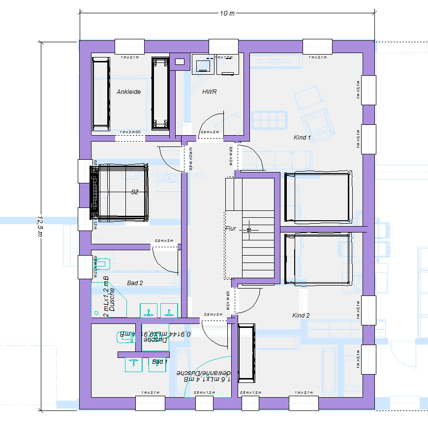

Negative points in the submission plan:
  • Ground floor + upper floor
    • Staircase between ground and upper floor is not properly dimensioned
  • Ground floor
    • Staircase unsuitable, takes up too much space; entrance to living area is through the kitchen
    • Access from garage to house does not fit due to height differences
  • Upper floor
    • Staircase unsuitable, room layout and a dark hallway with hallway width only 1.10 m (3.6 ft)
    • Balcony extends across the entire house length

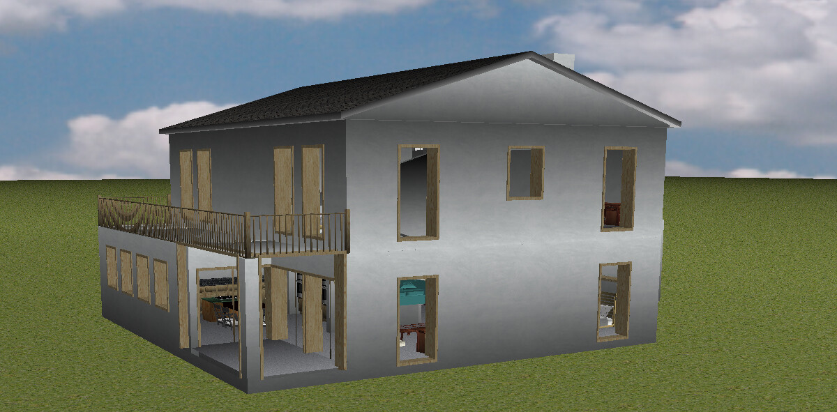

      • See east elevation under the image “View all sides”
        • The balcony was extended because the upper floor protrudes 70 cm (28 inches) beyond the ground floor, covering the resulting overhang. In the previous plan, the balcony was only above the bay window.

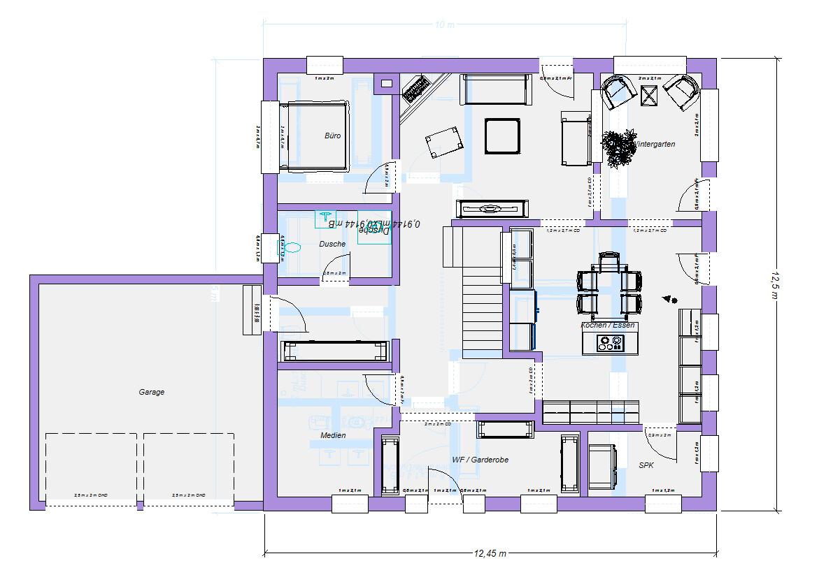

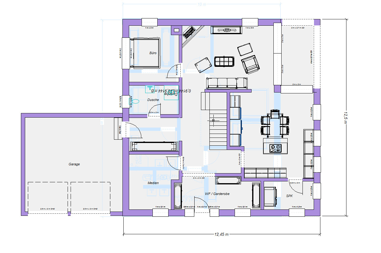

Our specific requests:
We like the ground floor and its room layout quite well. However, the half-landing staircase should be replaced by a space-saving alternative.
The staircase was placed centrally to allow the desired rooms to be created.
  • Keep the technical room in the marked position for connection reasons, near the turning circle.
  • Keep the front door position as shown – access from the garage plus guests parking in front of the garage.
  • Central staircase to maintain short walking distances.
  • Type of staircase: corner staircase with quarter turns (1x or 2x 90° turns) or straight staircase. Spiral staircases are not desired.
  • Modern house with an open kitchen and living area.
  • Home office.
  • Guest toilet with shower.
  • Pantry for freezer, food, and beverages.
  • Large children's bedrooms, preferably on the south side.
  • Room for a walk-in dressing area.
  • Separate entrance to the master bedroom, not through the dressing room.
  • One master bathroom and one children’s bathroom.
  • Small utility room (approx. 6–8 m2 (65–86 ft2)) on the upper floor for washing machine and dryer.
  • Tiled stove; the chimney flue should not run through the children’s bedrooms. Preferred route is through the bathroom or utility room.

kaho67410 Jan 2018 11:40
kaho674 schrieb:
Oh dear, where to put the newfound freedom?
How about a conservatory?
Floor plan of a house with kitchen/dining area, living room, office, shower, garage, conservatory, and garden.
