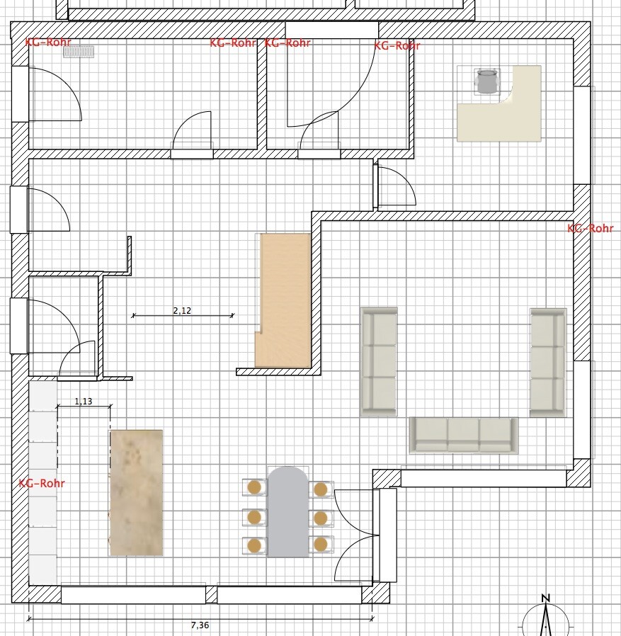

I would like to start a new thread regarding the initial design planning.
Previous thread: Single-family house – Opinions on our design
https://www.hausbau-forum.de/threads/Einfamilienhaus-Meinungen-zu-unserem-Entwurf.25622/
Here are the main points:

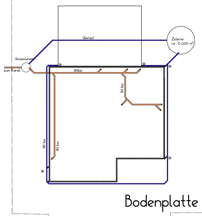

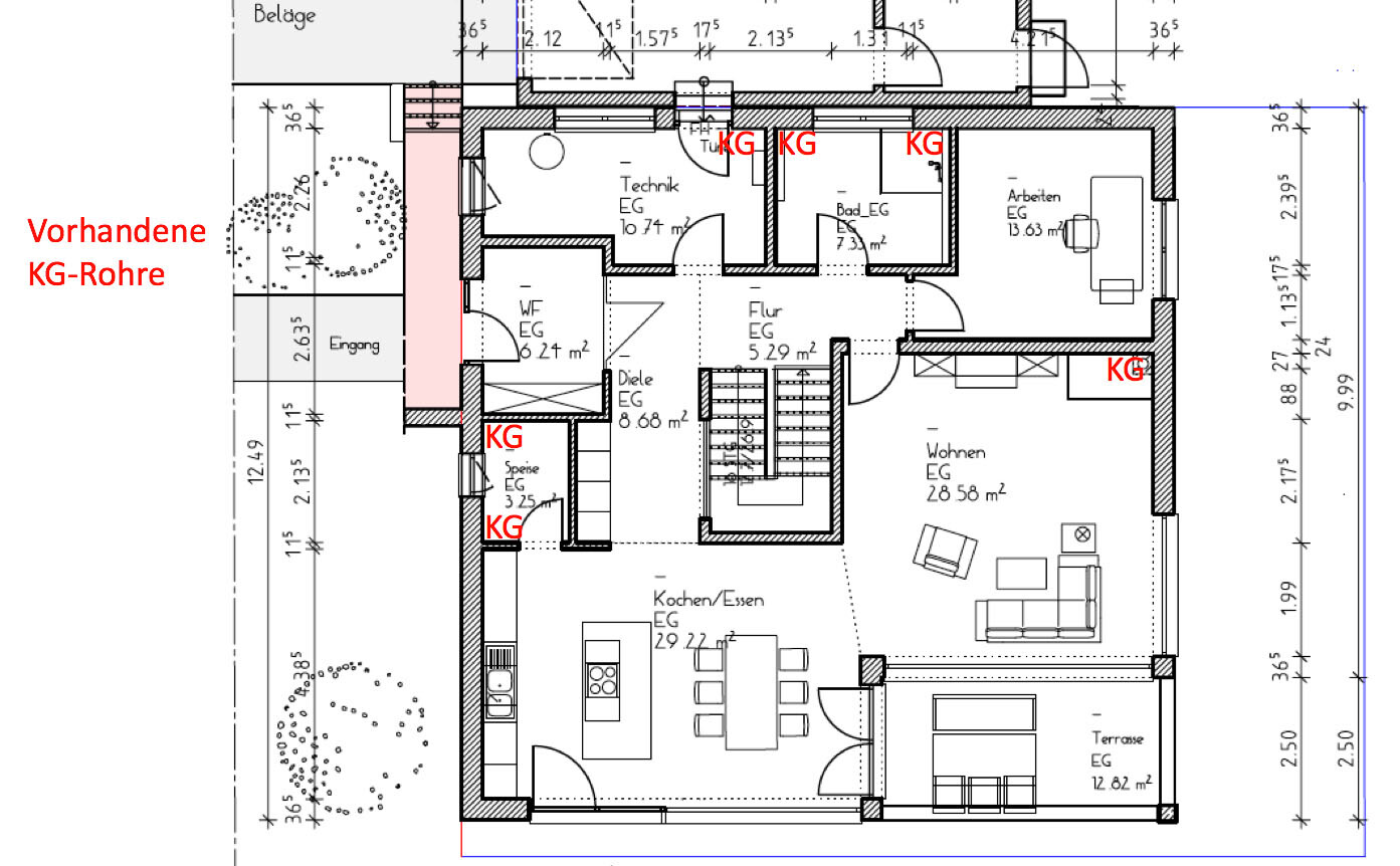

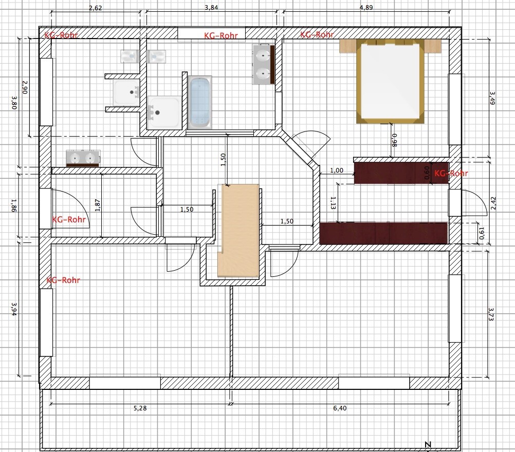

The foundation slab is already in place: 12.49 x 12.49 m2 (41 x 41 ft2) and 30 cm (12 inches) thick.
The foundation slab was inspected for quality by an energy consultant and a structural engineer – no issues were found.
The locations of the underground drainage pipes are marked in the image titled "Foundation Slab - Drainage Pipes."
The house is planned to be built on the existing foundation slab. Demolition is not planned.
The house needs to be constructed as a one-story plus attic (E+1) with a gable roof at a 22° pitch.
The original submission plan from the previous owner was applied for but has not been received yet.
Our own submission plan from the architect exists but was mostly rated as unsatisfactory.
Negative points in the submission plan:
Our specific requests:
We like the ground floor and its room layout quite well. However, the half-landing staircase should be replaced by a space-saving alternative.
The staircase was placed centrally to allow the desired rooms to be created.

How can I improve the layout of the house?

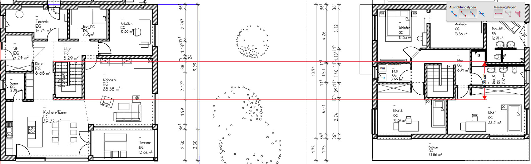

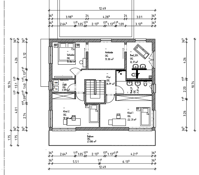

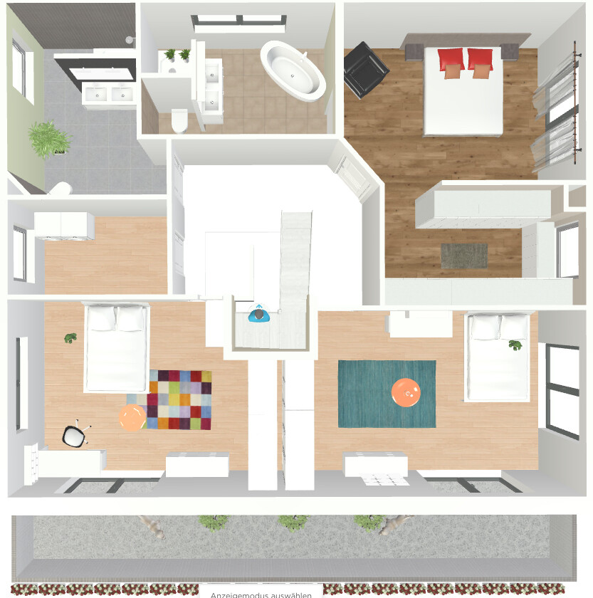

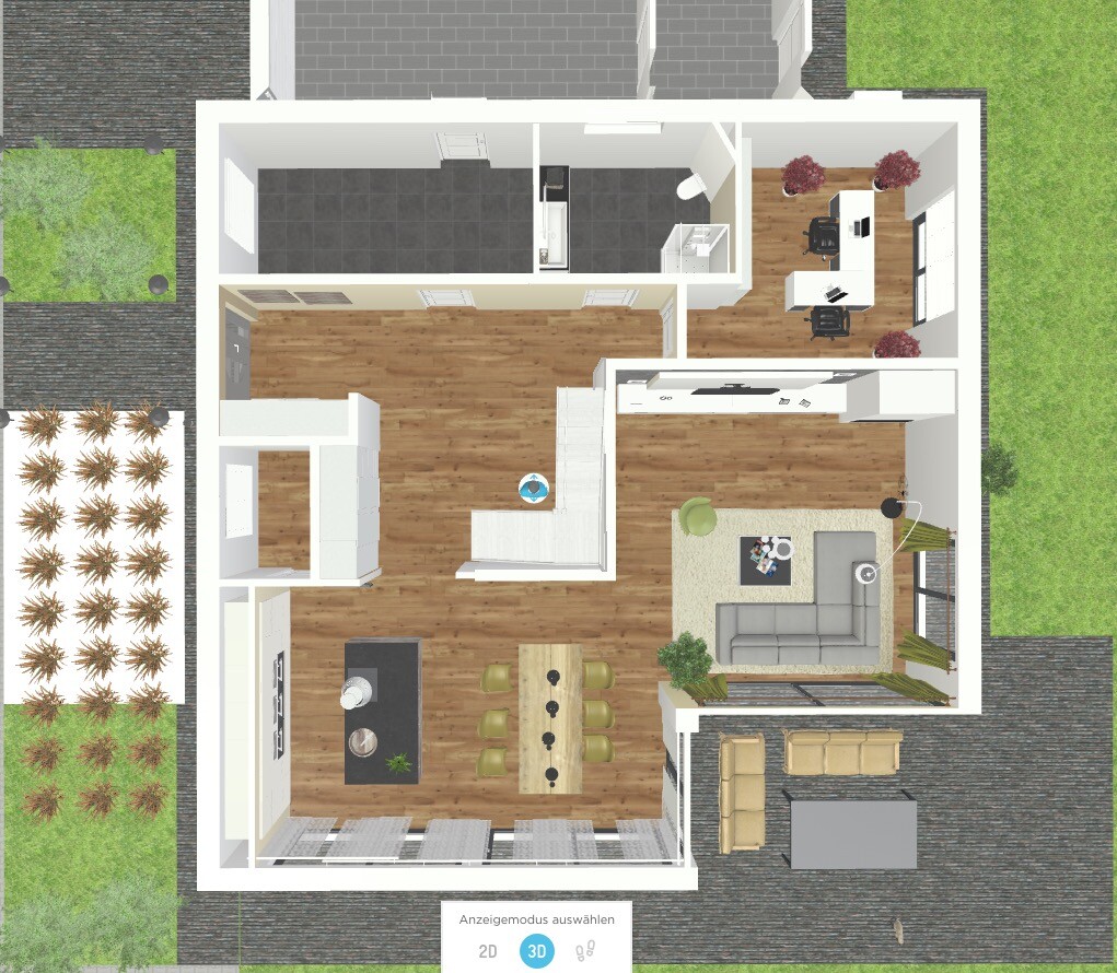

- Ground floor + upper floor
- Staircase between ground and upper floor is not properly dimensioned
- Ground floor
- Staircase unsuitable, takes up too much space; entrance to living area is through the kitchen
- Access from garage to house does not fit due to height differences
- Upper floor
- Staircase unsuitable, room layout and a dark hallway with hallway width only 1.10 m (3.6 ft)
- Balcony extends across the entire house length

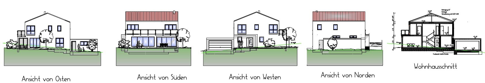

- See east elevation under the image “View all sides”
- The balcony was extended because the upper floor protrudes 70 cm (28 inches) beyond the ground floor, covering the resulting overhang. In the previous plan, the balcony was only above the bay window.

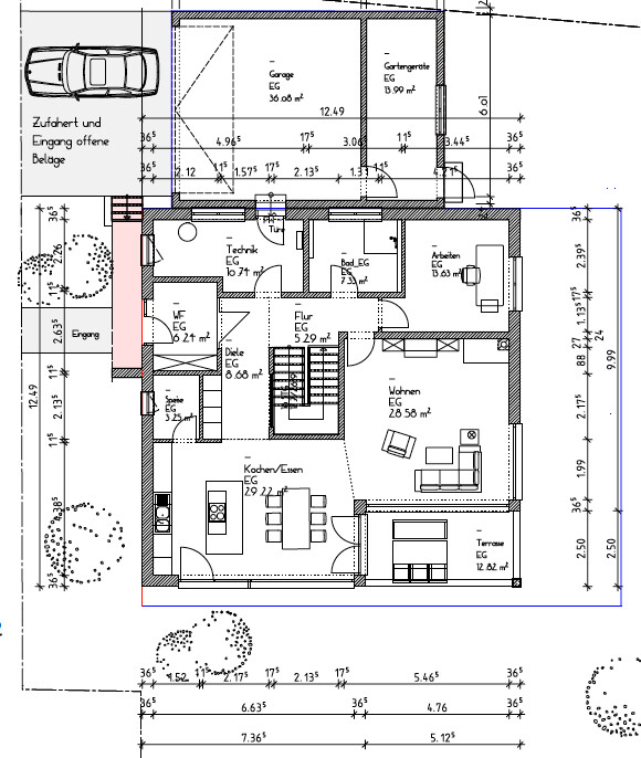

- Keep the technical room in the marked position for connection reasons, near the turning circle.
- Keep the front door position as shown – access from the garage plus guests parking in front of the garage.
- Central staircase to maintain short walking distances.
- Type of staircase: corner staircase with quarter turns (1x or 2x 90° turns) or straight staircase. Spiral staircases are not desired.
- Modern house with an open kitchen and living area.
- Home office.
- Guest toilet with shower.
- Pantry for freezer, food, and beverages.
- Large children's bedrooms, preferably on the south side.
- Room for a walk-in dressing area.
- Separate entrance to the master bedroom, not through the dressing room.
- One master bathroom and one children’s bathroom.
- Small utility room (approx. 6–8 m2 (65–86 ft2)) on the upper floor for washing machine and dryer.
- Tiled stove; the chimney flue should not run through the children’s bedrooms. Preferred route is through the bathroom or utility room.

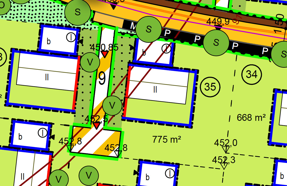

• Development plan / restrictions
Plot size: Parcel 35, 775 m2 (8,835 ft2)
KFW 55 standard
Slope: Yes
Site coverage ratio: 0.35
Floor area ratio: 0.80
Building envelope, building line, and boundary: see site plan
Edge development: No
Number of storeys: 2
Roof style: Gable roof, 22° pitch
Style / orientation: South - southeast
Maximum dimensions/limits: Building maximum = 14 m x 10 m (46 x 33 ft) plus single-story extension with max. length 10 m (33 ft), max. depth 3 m (10 ft)
