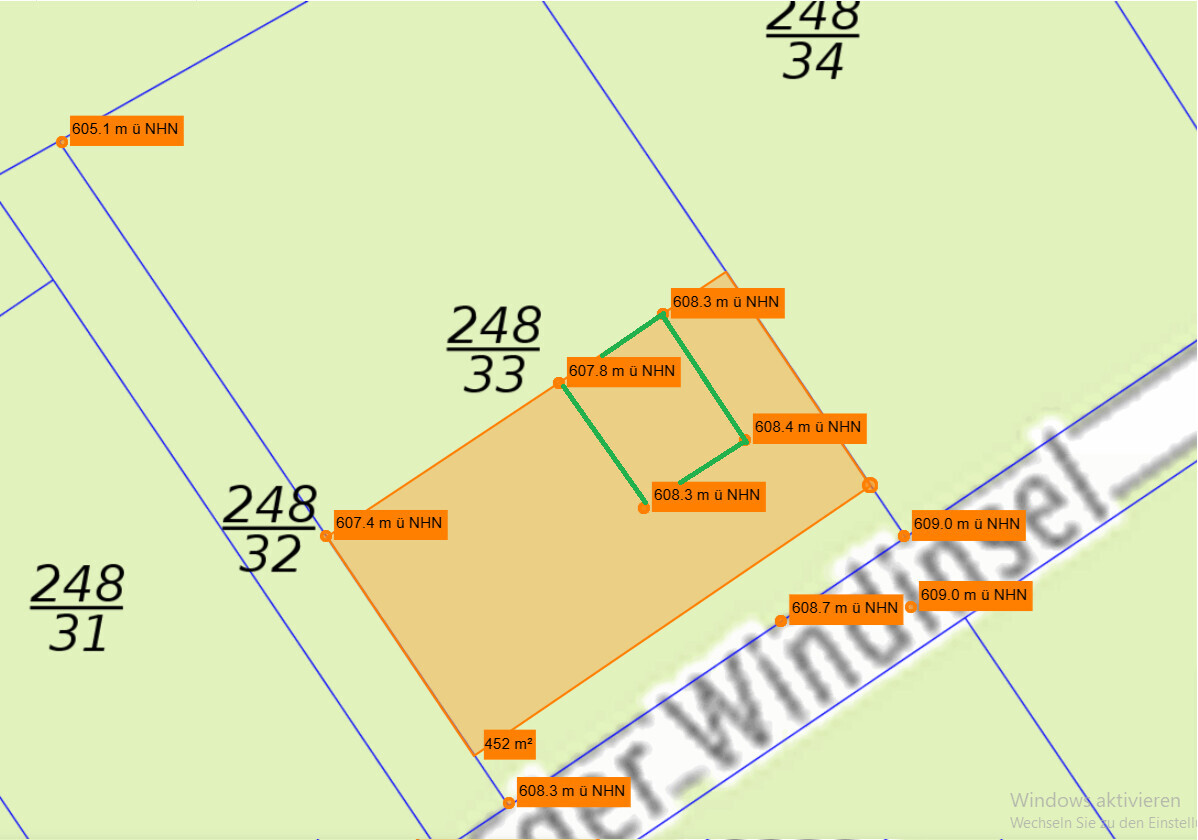

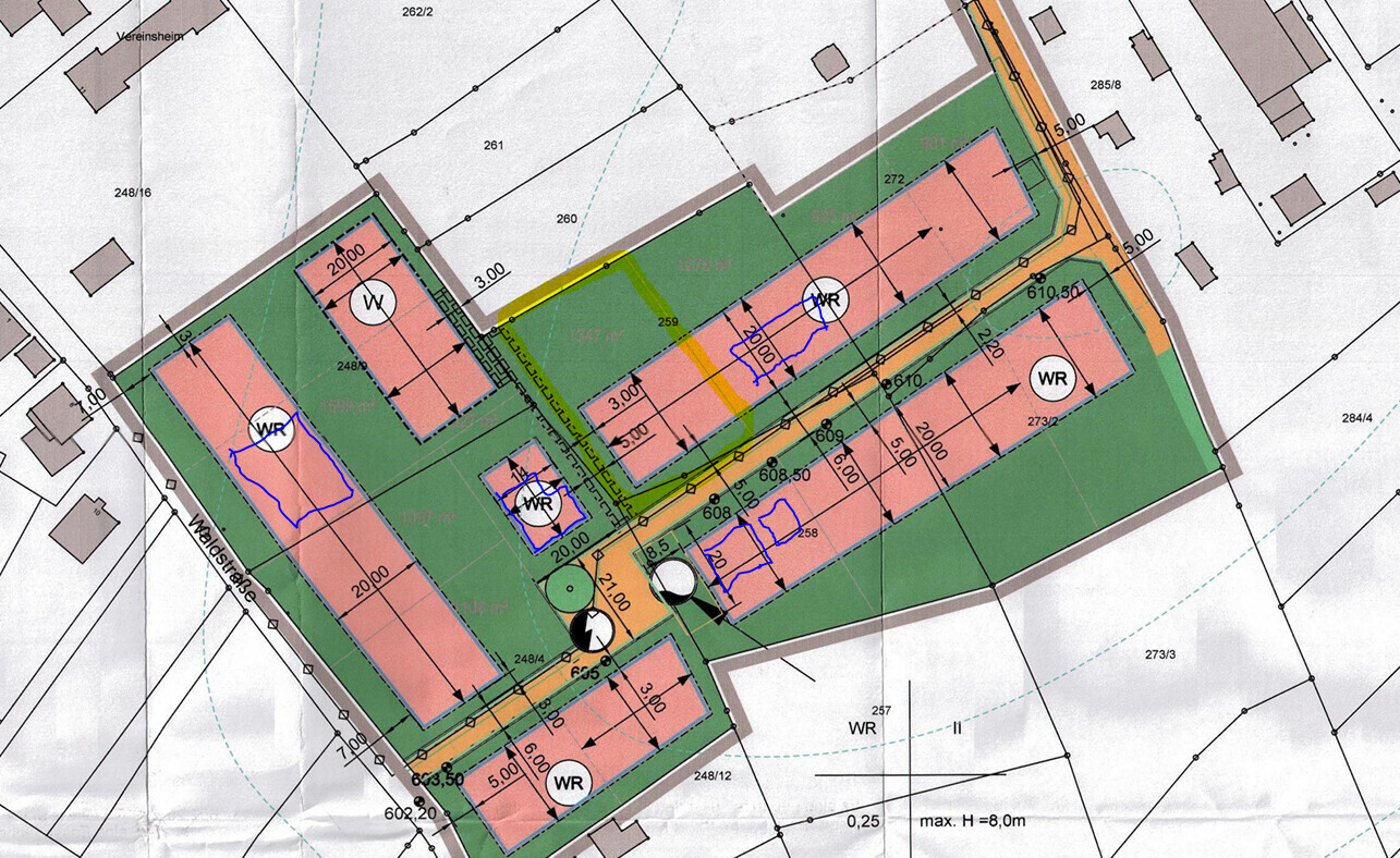

The development plan shows our plot circled in yellow, with existing buildings marked in blue. The beautiful view faces southwest to northwest, and we were lucky that the neighbor chose a bungalow in the viewing direction. To the left of the plot runs a small municipal path to two meadow plots behind our property, beyond which there are garden areas. For the elevation points, I have roughly overlaid the building zone (orange) and the external footprint outline of the house (green). We know that the design will require an exemption regarding the specified roof pitch. We are optimistic because three neighbors in the development area have already implemented flatter roof pitches and even roof shapes (mono-pitched roof instead of flat roof on outbuildings). The county office just smiled about the 2-degree deviation, while the city was more cautious and referred the matter to the permitting process for decision.
Lageplan eines Baugrundstücks mit Gebäudeflächen, Straßen und Grünflächen.
Lageplan eines Baugrundstücks mit Grundstücksnummern und orangeem Gebäudeumriss

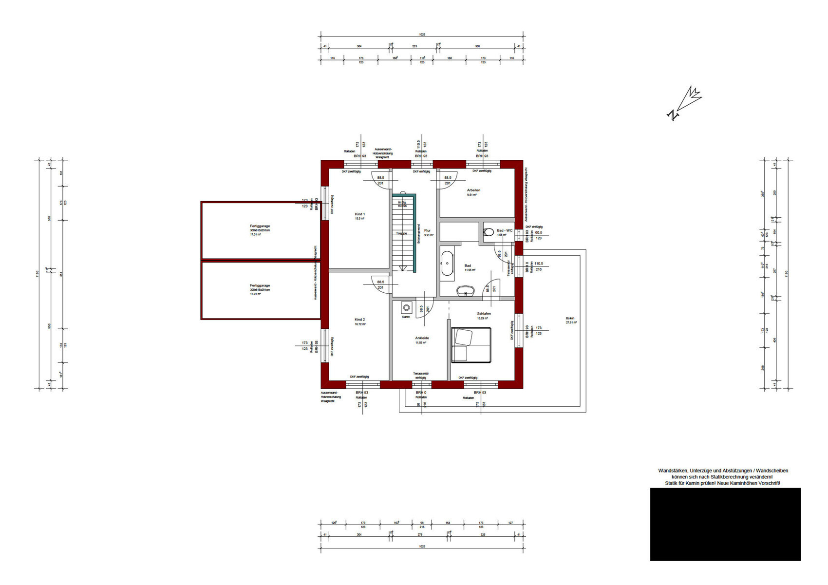

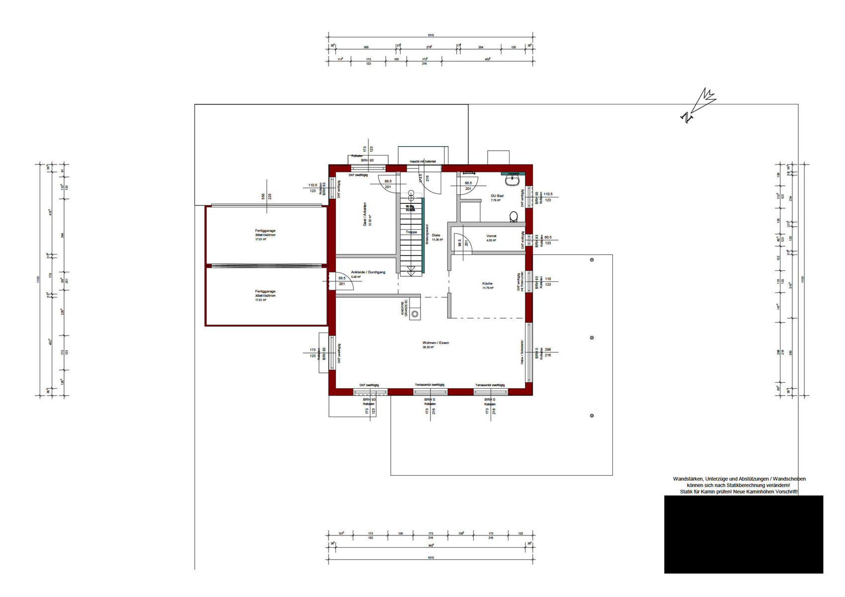

2D-Grundrissplan eines Hauses mit roter Außenwandumrandung, Keller, Küche und Treppen
Detaillierter Grundriss eines Hauses mit Wänden, Türen, Treppen und Maßlinien.
Detaillierter Grundriss eines Einfamilienhauses mit Zimmern, Treppe, Bad und Terrasse.

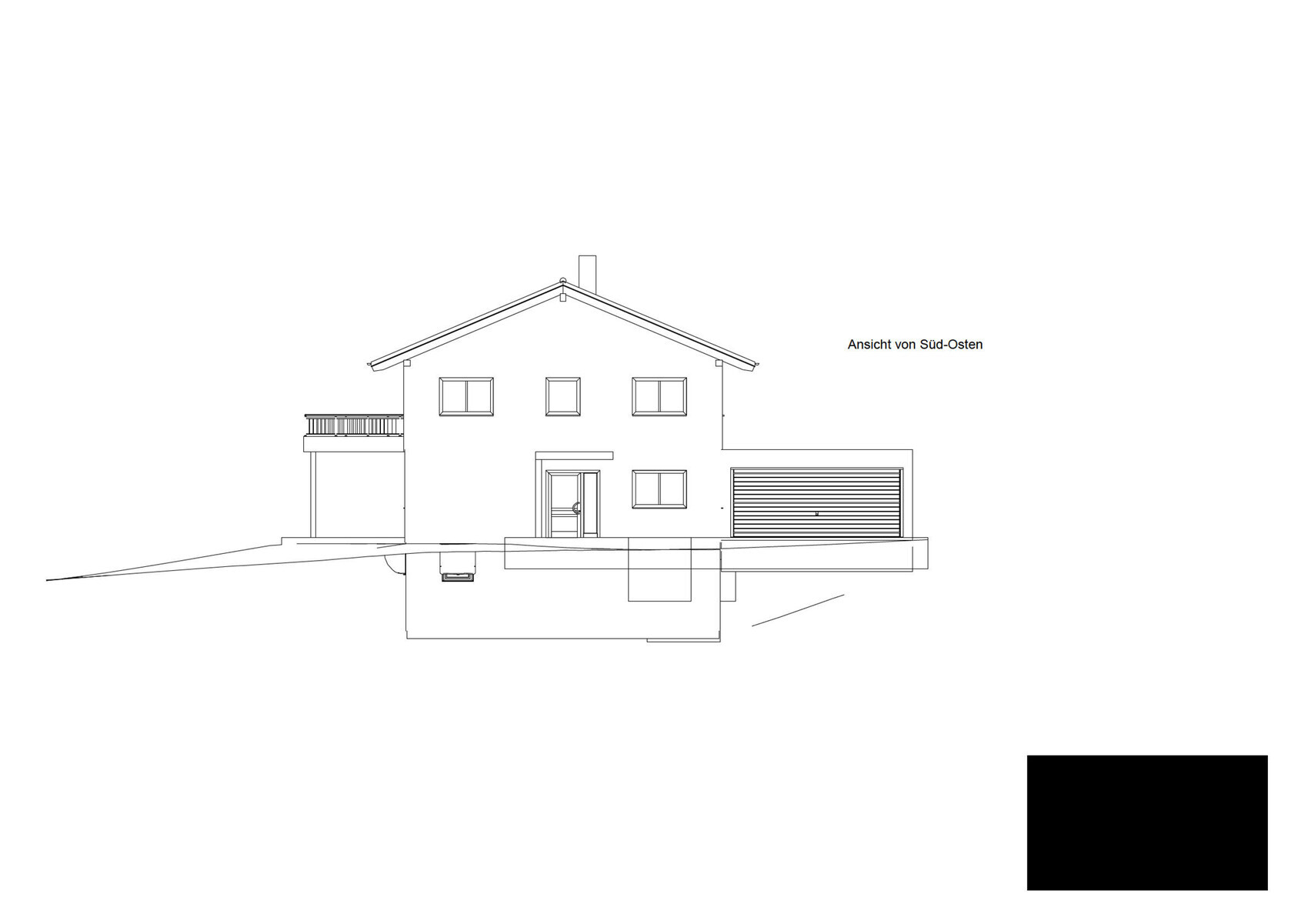

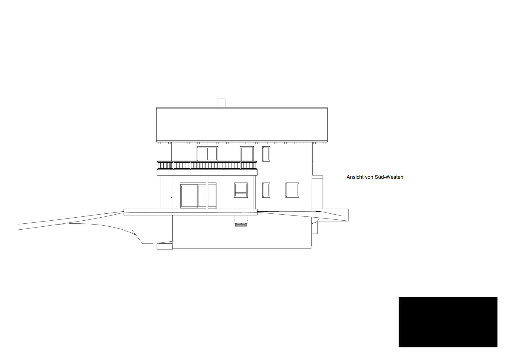

Außenansicht eines zweistöckigen Hauses, Süd-West-Ansicht mit Balkon
Architekturzeichnung eines Einfamilienhauses, Ansicht Südost mit Garage

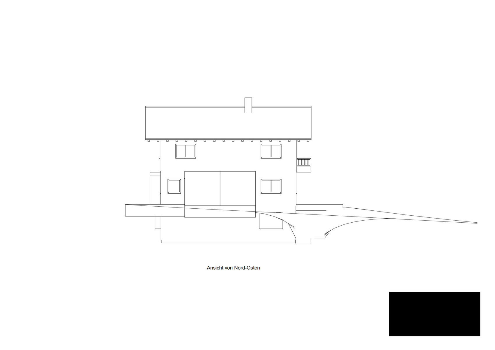

Architekturzeichnung: Hausansicht Nordost mit Dach und Fenstern

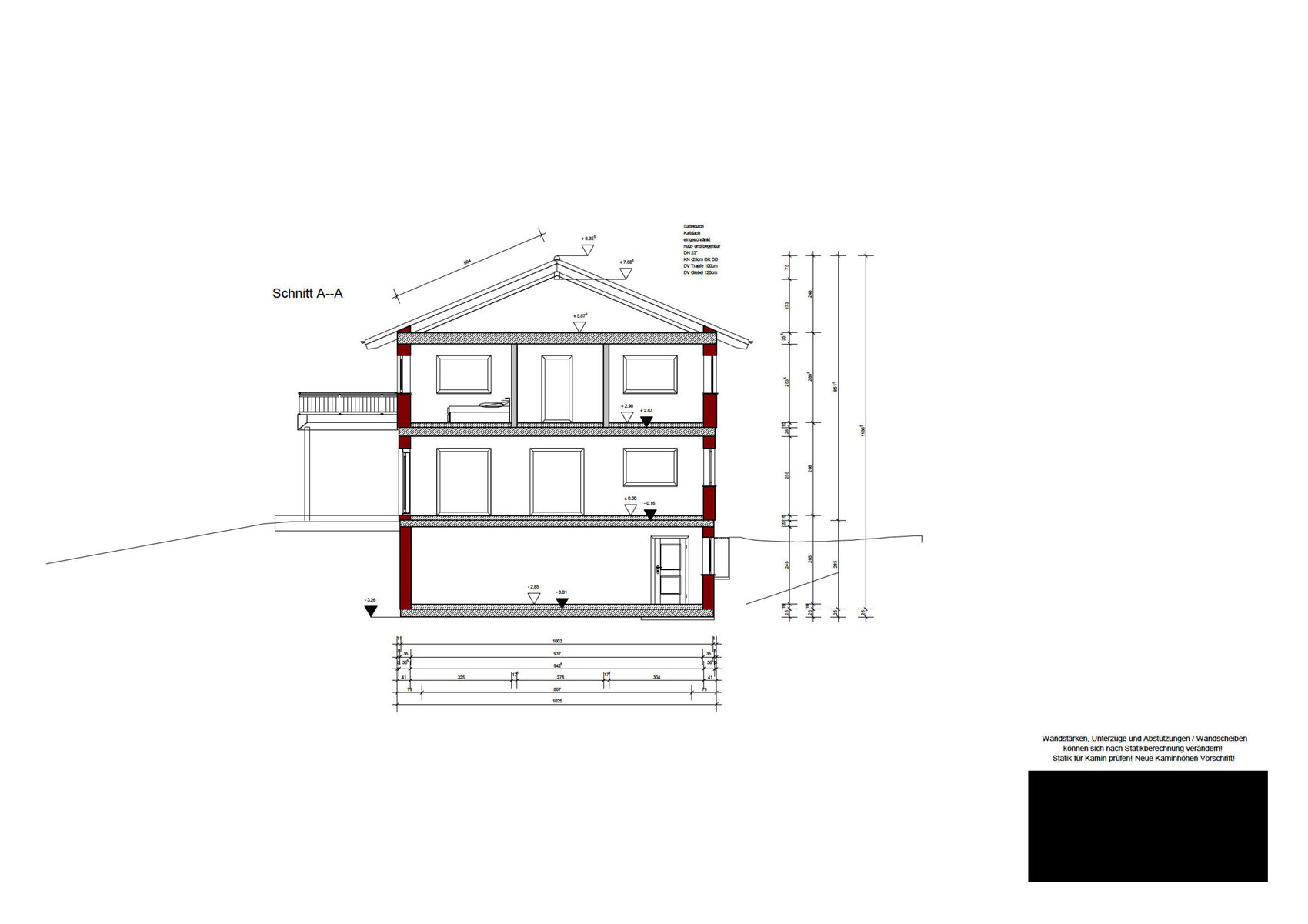

Querschnitt eines mehrgeschossigen Hauses mit Rohbau, Fundamenten und Dachkonstruktion

Overall, this is a nice design. One or two views don’t appeal to me, and the pantry is very narrow.

1. Upper floor: Suppose the children have diarrhea. Then they either have to go downstairs to get to the bathroom or pass through the dressing room and master bedroom.
What I mean is: I would make the bathroom accessible from the hallway, not from the master bedroom. Also considering the walking routes: in my opinion, the bedroom should not be a passageway so that people don’t accidentally wake each other up.
2. The pantry seems extremely narrow to me. Narrow rooms are hardly usable. Unfortunately, I can’t make out the exact measurement, as the image isn’t large enough here. Consider shelf width plus space for moving around; plan generously so you don’t accidentally knock things off the shelves when carrying items.
3. Room orientation: Is there a reason for this? I read something about a nice view to the southwest, yet the main living area is planned to face northeast, which tends to be darker in terms of natural light. The same goes for the upper floor: the office faces south, while the children’s room faces north.
There might be good reasons for this. But based on what I read (including the nice southwest view), these reasons are not clear to me.

I’m not a floor plan expert and usually hold back on questions like this. However, as a somewhat experienced family person, I find the lack of a wardrobe (a space under the stairs is never enough for a household of five) problematic. You could consider swapping the utility room and the dressing rooms.
Having the upstairs bathroom only for the parents seems quite unfair to the children. Do it the other way around: an upstairs bathroom only for the kids, and they have to go downstairs. Not so appealing anymore, right?
It’s also not very practical. If you have more children, diaper changes will also need to happen in the kids’ rooms upstairs. Having to carry water and other supplies over long distances isn’t ideal.
So, why exactly do you want it this way? Do you want privacy just to use the toilet, or only for showering and freshening up?
In principle, it would also be possible to create a guest toilet accessible from the hallway and keep the shower area exclusively for yourselves.
And what about when the kids want to shower and there are guests? Do they always have to carry all their clothes with them to avoid running naked into the guests? And where do the guests go to the toilet while the child is showering? Or a teenager?
