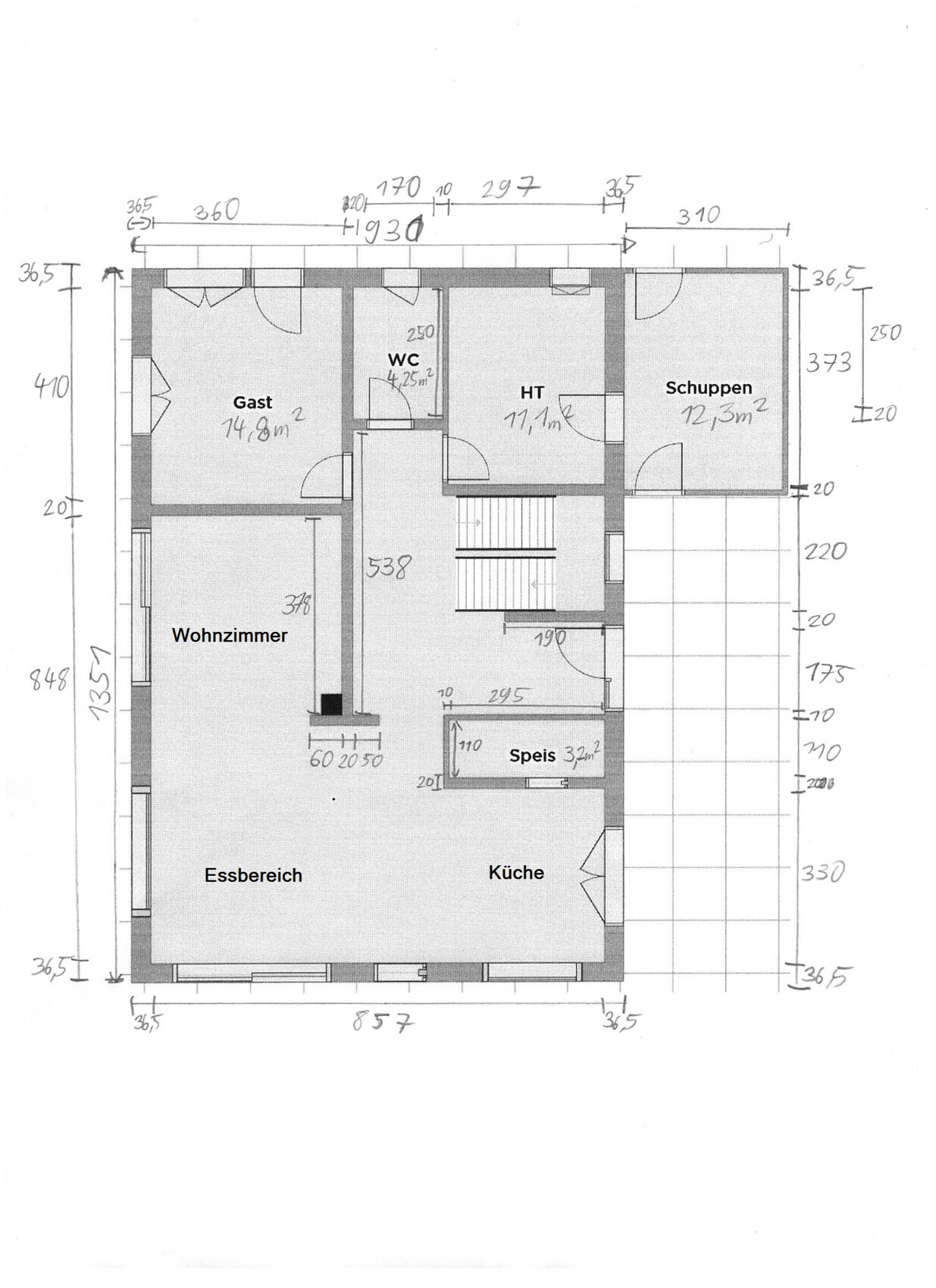

Questions about the floor plan:
- Is the plot well used?
- Is the entrance area too narrow at 175 cm (69 inches)?
- Are the rooms arranged practically for a family of 4 to 5?
- Do we have enough storage given that we lack a basement and the attic is quite low?
- Is it a big disadvantage in terms of sound transmission that the two children’s rooms share a common wall?

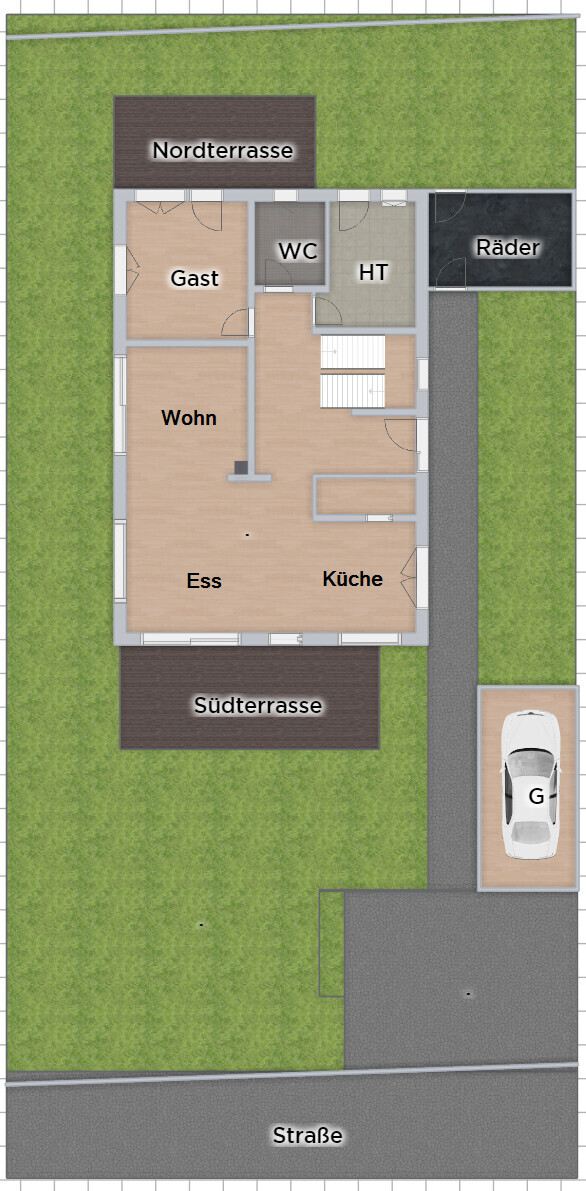

Can you share a site plan including the proposed house?
I don’t like the layout of the house, garage, bike room, and long driveway.
A simple copy and pencil sketch is enough.
The technical room so far back will really increase costs. You pay for every meter the lines need to be buried.
Do the bicycles have to be stored so far back?
Ground floor
The shower doesn’t fit in the bathroom.
The cloakroom doesn’t fit in the entrance area.
Pantry: how is the freezer supposed to be positioned? Keep in mind it needs quite a bit of space to open.

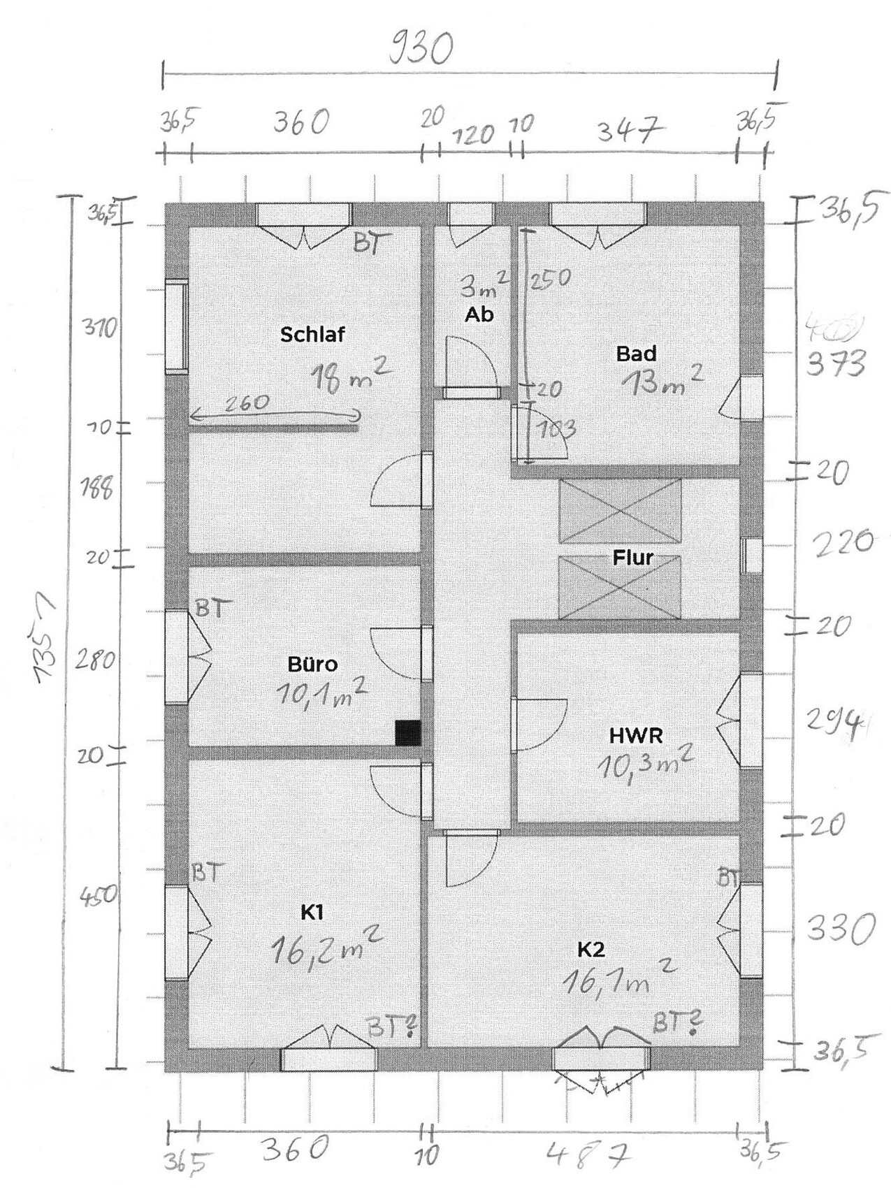

Upper floor
Replace the small storage room with a built-in closet.
Then move the bathroom door 60 cm (24 inches) north; this way a closet can fit behind the door.
It would be beneficial to swap the laundry room and stairs on the upper floor.
The hallway is very narrow and long.
Ground floor
Upper floor
hausbauer7 Sep 2019 20:54haydee schrieb:
Can you share a site plan with the submitted house? What do you mean? Neighboring buildings?
-> What would be a better option if you want a south-facing garden or at least south-facing living rooms? Ideally, we would have a double carport directly on the street, but that probably won’t be approved.
A copy and pencil are enough.
The technical room (HT) is so far back, it really adds up. You pay for every meter the pipes have to be buried.
Do the bikes have to be stored back there?
-> No, I just don’t know where else to put them.
Ground floor
The shower doesn’t fit in the toilet. -> Thanks for the note; the guest bathroom will probably have to be widened by several 10cm (several 4 inches) into the technical room.
The cloakroom doesn’t fit in the entrance -> That was also a concern of mine, not sure how to solve it, perhaps opposite the entrance?
Pantry: How should the freezer be arranged? Note that it needs quite a bit of space to open. -> It will probably be located in the kitchen, also because of heat dissipation.
Upper floor
Then move the bathroom door 60cm (24 inches) north, so a cabinet fits behind the door. -> Good idea.
It would be beneficial to swap the utility room and the staircase on the upper floor. -> It was like that before, but I switched it so the route to the front door is not even longer (the entrance on the ground floor would then move further north).
The hallway is very narrow and long -> I prioritize nice living spaces over a wider hallway upstairs. But maybe the house should be 10-20cm (4-8 inches) wider to gain some space here.
