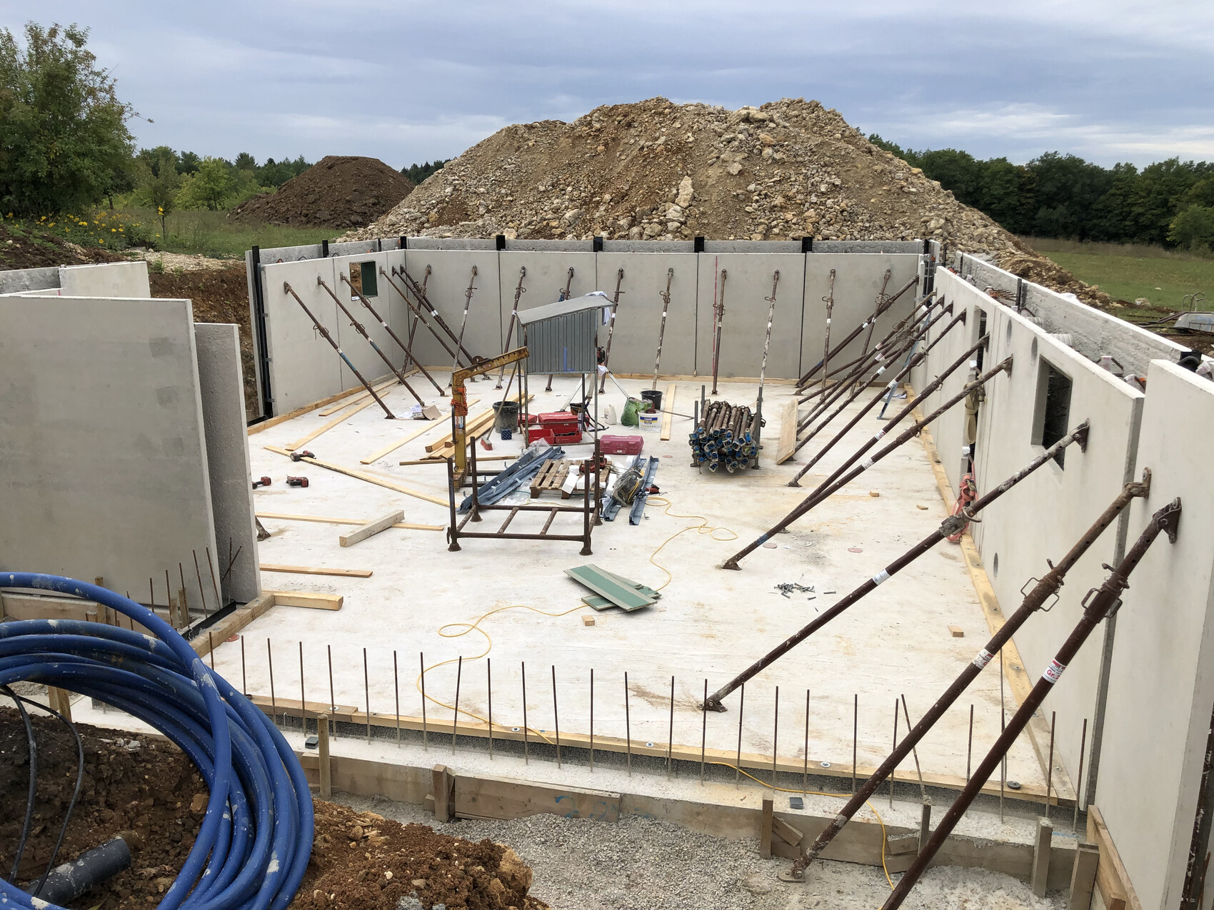

Hendrik198013 Sep 2022 21:32
Thank you for the quick response! That was exactly my wife's concern—that the floor would gradually become sandy over time, and we would always track dirt upstairs. The base slab was definitely leveled with a concrete screed (see photo).
Construction pit with concrete walls, supports, tools, and wooden planks; excavation in the background.
Is it possible to lay tiles directly on the base slab? How thick is a screed layer without insulation? I'm just wondering if there might be issues with the height (for example, at the stairs).
OWLer13 Sep 2022 21:33
Bare concrete slab without screed and no plaster on the (interior) walls?
That will be… rustic.
Have you ever seen raw concrete slabs? Quite uneven and irregular. Ours was very wavy, with inclusions, air bubbles, and so on. In addition, the sand-lime brick walls were resting on some kind of mat. You’ll see all of that, and it will stay visible permanently. Also, you won’t have the insulation that is usually laid under the screed.
i_b_n_a_n13 Sep 2022 21:45
... the staircase is somehow calculated based on the reference heights set by the clients. On the ground floor, this will probably be the finished floor level, and in the basement the top of the raw base floor? If so, the staircase will likely need to be adjusted (at least it should) if you decide to go with screed plus tiles after all. Otherwise, you accept varying riser heights (warning: tripping hazard).
Tiles can be laid in the pantry (I’ve done that before ;-) or glued. I’m not sure if they can be placed directly on the base floor, but what would happen? This will determine your build-up height (and also your costs). My recommendation: have the screed done, then handle the rest yourself gradually...
The flooring expert of the forum @KlaRa is, I believe, enjoying a well-earned retirement (abroad on the beach? 😉). But maybe he’ll get bored sometime and want to chime in? Fortunately, I’ve been out of the construction business for over 30 years and never really knew everything anyway 😕
Hendrik198013 Sep 2022 21:46
OWLer schrieb:
Plain concrete slab without screed and no plaster on the (interior) walls?
That will be... rustic.
Have you ever seen raw concrete slabs? Quite uneven and crooked. Ours was very wavy with inclusions, air bubbles, etc. In addition, the sand-lime brick walls stood on some kind of mat. You’ll see all of that forever. Plus, you don’t have the insulation that the screed is usually poured over.
That doesn’t really bother us. We actually find the raw concrete visually interesting. Our slab is quite smooth and we also don’t have mats under our walls. Our main concern is really about the medium- to long-term cleaning.
