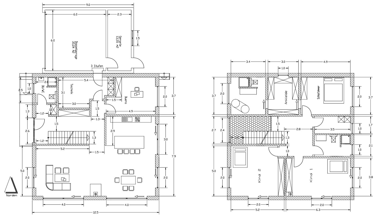

I have found a mistake in my version 3. The chimney in the children's bathroom runs through the door area. So, mirroring the chimney with the door will correct it.
Regarding the hallway area in the attic version 3: Basically, I am not a fan of such large hallway spaces. Personally, I prefer to allocate these areas to the rooms. In your case, due to the still spacious rooms, I can indeed imagine this hallway with a nice stair railing as an interesting feature.
matte1987 schrieb:
Why are you accessing the parents’ area through the bedroom when it can be easily done from the dressing room? I agree with you, but in my view, such details are better addressed during the revision of the building permit / planning permission plans. However, the phase of the preliminary design needs to be closed now—otherwise, we’ll end up in a back-and-forth of changes that cause more delays than progress. I believe the Pareto optimum has clearly been reached here.
Furthermore, I fully agree with Onkel Dagobert (today 08:11 in the green forum).
Hello, here is the latest design. Thanks for all your tips.
I have tried to incorporate your ideas and suggestions as much as possible.
Ground floor --> Is the hallway width of 1.50m (5 feet) too narrow?
--> Does the corridor without a gallery look too closed-in or dull?
You already mentioned that it might be unnecessary, but we want the house to have visual appeal as well.
--> Access for Child 2 to the hallway (the suggestion was to place it on the left side of the plan) seems too far from the master bedroom.
For example, if the child gets sick at night, we might not hear or notice it.
--> How could the corner at the entrance to the utility room/office be softened? Too many corners?
A separate entrance is necessary in case a family member moves in later.
--> Do you see a possibility to add a pantry (e.g. in the utility room/office)?
--> The fireplace is on the exterior wall because I could not find a better location. Also, this way the fireplace would be visible from all sides.
--> Would you add a door from the master bathroom to the hallway? For example, as a second emergency exit (fire safety, etc.)
If you find the floor plan acceptable so far, I would now commission the draftsman.
Thank you all.

MBS2201 schrieb:
--> Does the hallway look oppressive or boring without the gallery? Actually, it's the opposite: the height makes it feel narrower.
MBS2201 schrieb:
--> Would you add a door from the master bathroom to the hallway? Yes.
MBS2201 schrieb:
However, the house should also have some visual appeal. All the more reason to avoid that unnecessary shaft.
MBS2201 schrieb:
Ground floor --> Is the hallway width of 1.50m (5 feet) too narrow? No.
MBS2201 schrieb:
If you think the floor plan is acceptable so far, I would now commission the draftsman. That is the architect’s task.
