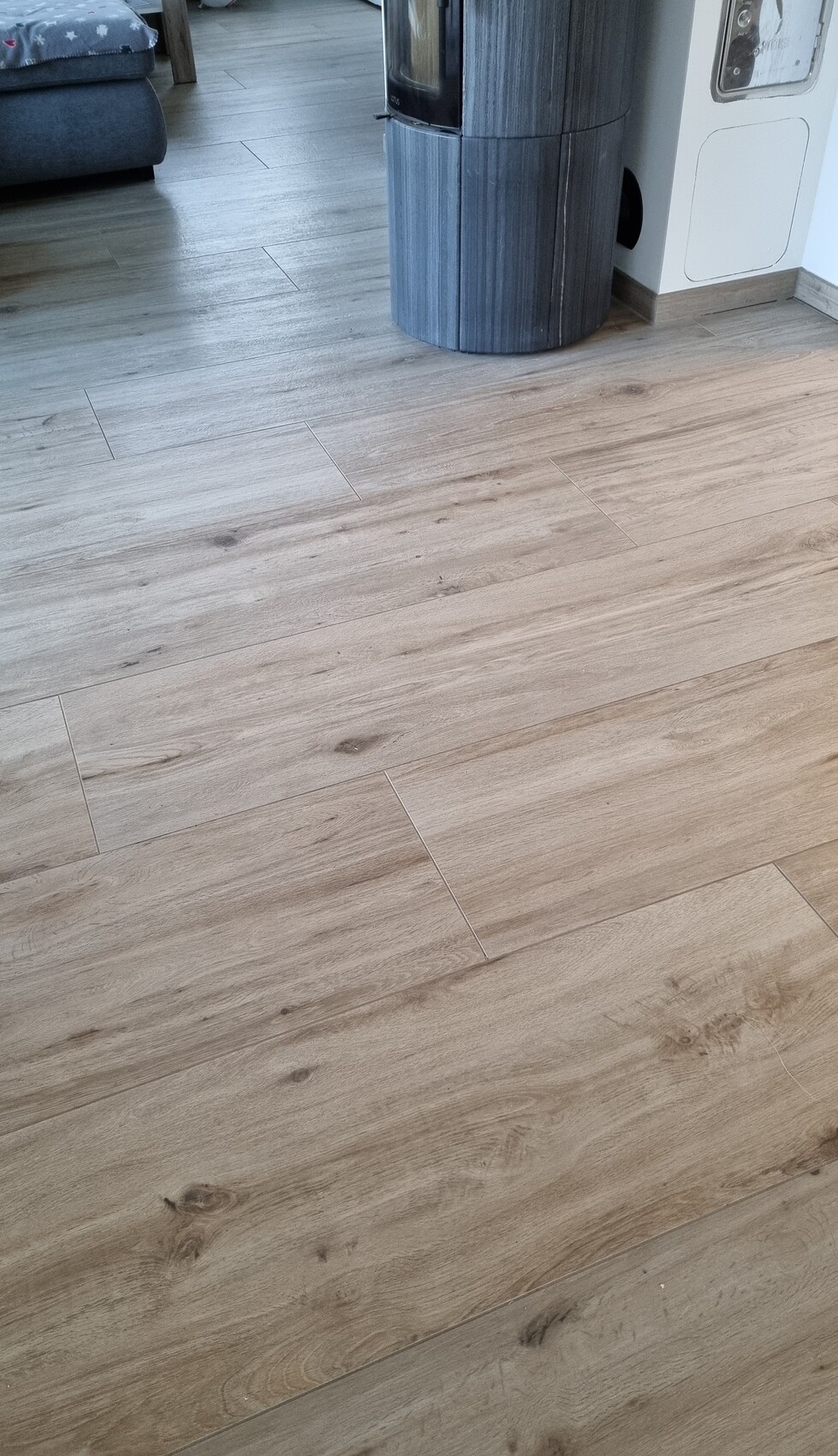

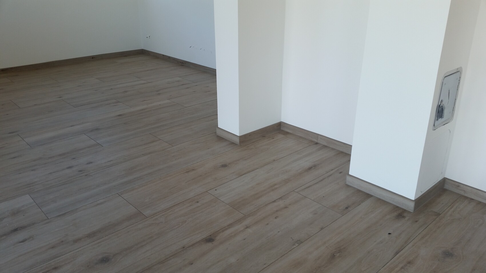

Fuchur
18 Nov 2021 08:38
Living room floor made of light wood, round dark floor vase next to white cabinet, sofa on the left.
Empty room with wood laminate flooring, white walls and columns; wall with inspection hatch.
The color is generally difficult to capture in photos; in reality, the floor has a slightly less yellow tint. It is Marazzi Treverktrend Rovere Naturale 150 x 37.5 cm (59 x 15 inches).

The color is generally difficult to capture accurately in photos; in reality, the floor is a bit less yellowish. It is Marazzi Treverktrend Rovere Naturale 150cm x 37.5cm (59 inches x 15 inches).
Looks good. How wide are the grout joints? I’ve also been considering Marazzi 😎

18 Nov 2021 09:57
