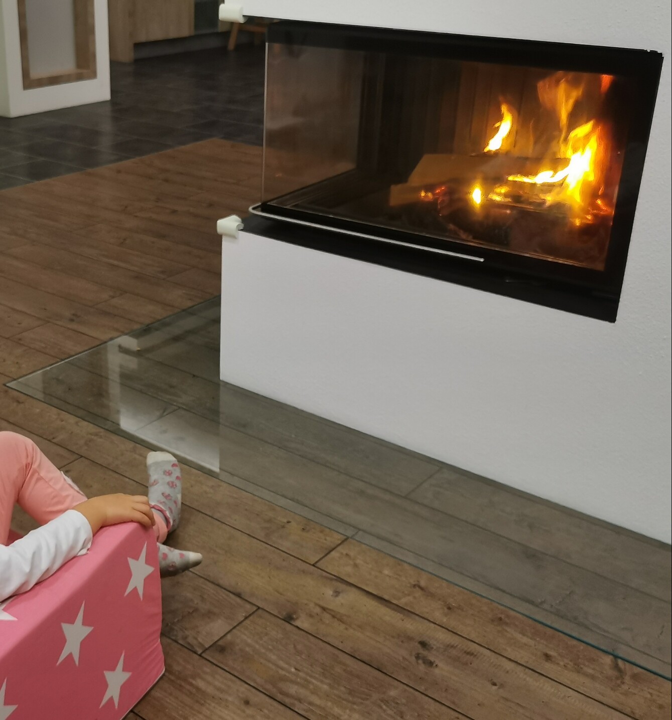

have you already installed the flooring, or are you still in the planning stage (I might have missed it, sorry if this was already answered)?
We also have vinyl flooring and had the screed around the fireplace lowered by 2cm (1 inch). This allowed us to recess the glass plate and avoid having a threshold.
Underneath is the standard vinyl.
Just as @Isokrates suggested.

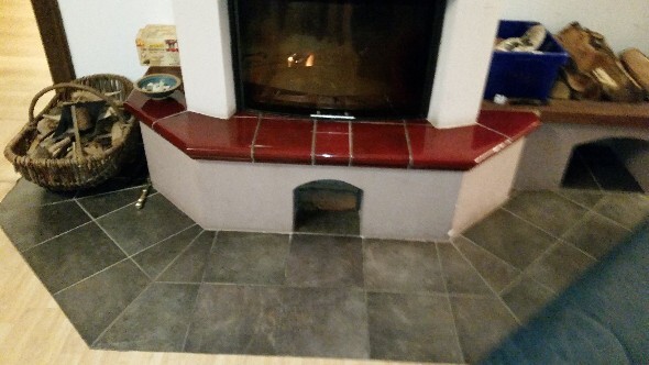

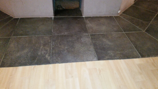

Tiles installed recessed after laminate flooring. The transition joint is the challenge then...

chand1986
23 Nov 2021 17:46
karl.jonas schrieb:
Tiles installed before laminate flooring, recessed afterward. Then the transition joint becomes the challenge...
That’s what I meant by contrast. It looks nice that way.
