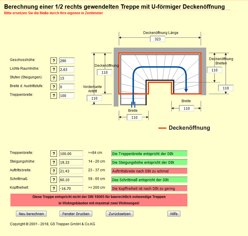

You didn’t provide the dimensions for the stairs, although we asked for them. So, if I calculated correctly, it looks something like this:
Absolutely unacceptable.

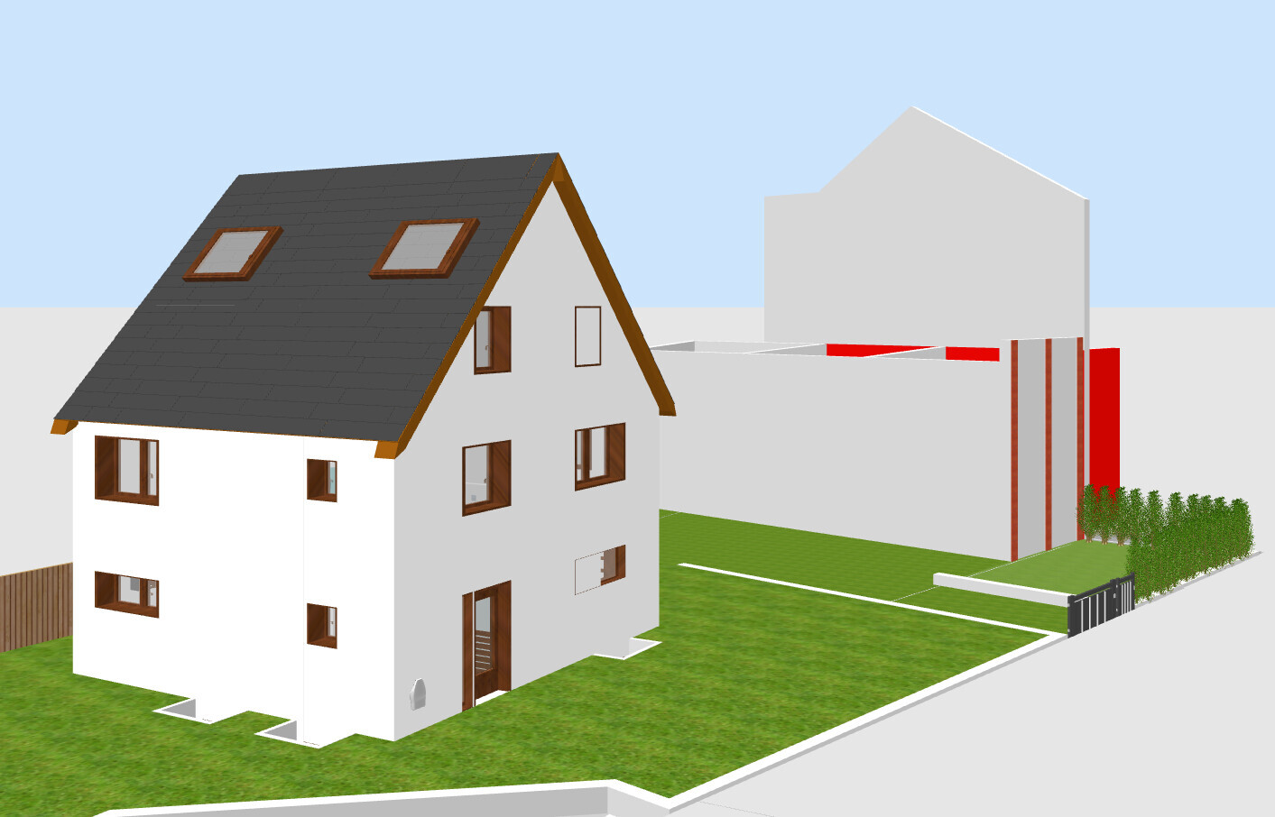

There is a significant difference between a 45° and a 50° roof pitch – please check the regulations on required setback distances for details:
At least in Bavaria, the following applies:
(4) 1The depth of the setback area is determined by the wall height; it is measured perpendicular to the wall. 2Wall height means the distance from the ground surface to the point where the wall meets the roof covering, or to the top edge of the wall. 3The height of roofs with a pitch greater than 70 degrees is fully included, while for roofs with a pitch over 45 degrees, one third of the roof height is added.
For your 50° roof, one third of the roof’s wall height is therefore added. I don’t have the site plan in mind right now, but since it will already look like a tower anyway, this could become a tight fit.

I started reading the Saxon building code on the topic and found this on roof pitch: "The depth of the setback is determined by the wall height. It is measured perpendicular to the wall. Wall height is the distance from the ground surface to the intersection of the wall with the roof surface or the upper edge of the wall. Roofs with a pitch less than 70 degrees add one third of the wall height, otherwise the full roof height is added. Sentences 1 to 4 apply analogously for roof structures. The resulting measure is H.”
For me, this results in three possible calculations:
- (“only” the height of ground and upper floors * 0.4) + (height of gable wall (without ground and upper floors) * 0.33 * 0.4)
- (“only” the height of ground and upper floors * 0.4) + (height of gable wall (without ground and upper floors) * 0.33)
- complete gable wall height * 0.4 (because it’s the gable side – but I found no info on this)

You didn’t provide staircase dimensions, although we asked. If I calculated correctly, it looks like this:
Completely unacceptable.

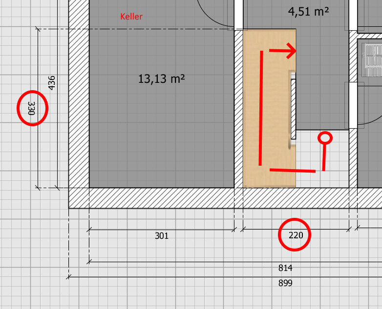

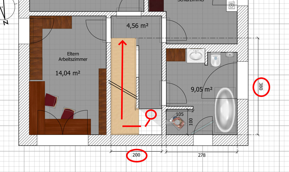

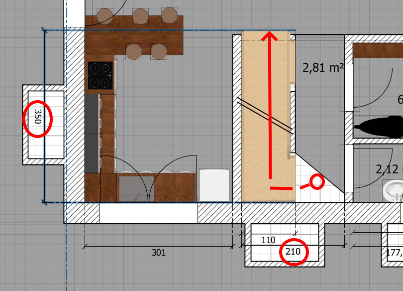

If you do want to help: I have attached three pictures of the stairs. I already had some dimensions on them before, which you didn’t notice. Now I probably have almost all necessary measurements. Important: The landings at the top are decisive, and I drew in the currently longest (in terms of stair length) possible layout at the bottom. This is limited by headroom under the stairs and roof, especially on the first floor where access to the WC is. A change is possible there too.
If the stairs on the upper floor start with a double turn at the bottom, the stairwell would need to be 10cm (4 inches) wider.
