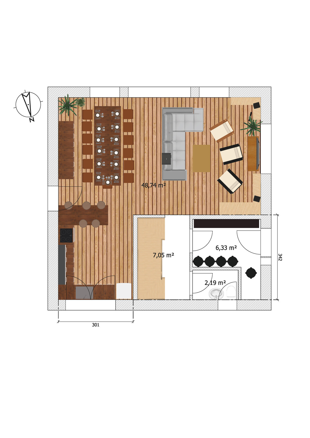

We are currently working with an architect on the design of our single-family home. Since we have three children, the house should accommodate several future scenarios. These include:
Plot:
Since the plot already has a building, and we want to keep the rear building (it is fully shaded by the apartment building, is in reasonable condition, and might provide future expansion potential—at least suitable for workshops and storage), and since the plot is not very large, we decided on a tall house with a small footprint.
About the house
We have already developed a fairly comfortable floor plan with our chosen architect. Our biggest concern is accidentally planning a wall or something else 5 cm (2 inches) too far to the left or right and then being unable to fit our furniture. I would appreciate it if you would be interested in looking over the current design and giving feedback.

I would like to revisit the current ground floor layout draft. There haven’t been any comments on it yet. Is it because it is even worse than the previous one?
Is it conceivable to shift this staircase on every floor by 1-2 steps upward in the plan?
Always upwards in the plan:

grericht schrieb:
I would still like to return to the current ground floor layout draft. There haven’t been any comments on it yet. Is it because it’s even worse than the last one?
It only makes sense if all floors are shown.
Please also mark the parking spaces for the cars so that the walking routes are clear.
What about the area in front of the existing building? It looks like it is paved. Can that be removed and added to the garden? Possibly making the house 2m (6.5 ft) longer to compensate?
I will only be able to complete all floors tonight. Unfortunately, my software won’t be able to properly represent the stairs.
The rooms on the attic and the top floor will basically stay the same, except the bedroom will get access from the corridor, become a bit larger, and the built-in wardrobe will be removed.
A bathroom with a shower will be added on the top floor aligned with the stairs.
Regarding the plot: yes, it is concreted and can/should be cleared again. Currently, there is a driveway there. It will probably remain for now (house renovation takes priority). The car, which is only used about once every two weeks anyway, will be parked in front of the rear building.
Whether a parking space will be created in front of the house during the construction phase is still undecided. The plan is to have a parking space at some point at the latest.
For us, the bigger issue is the bicycles. They are used daily, so they need to be quickly accessible while still being secure. Maybe even a bike ramp down to the basement =)
