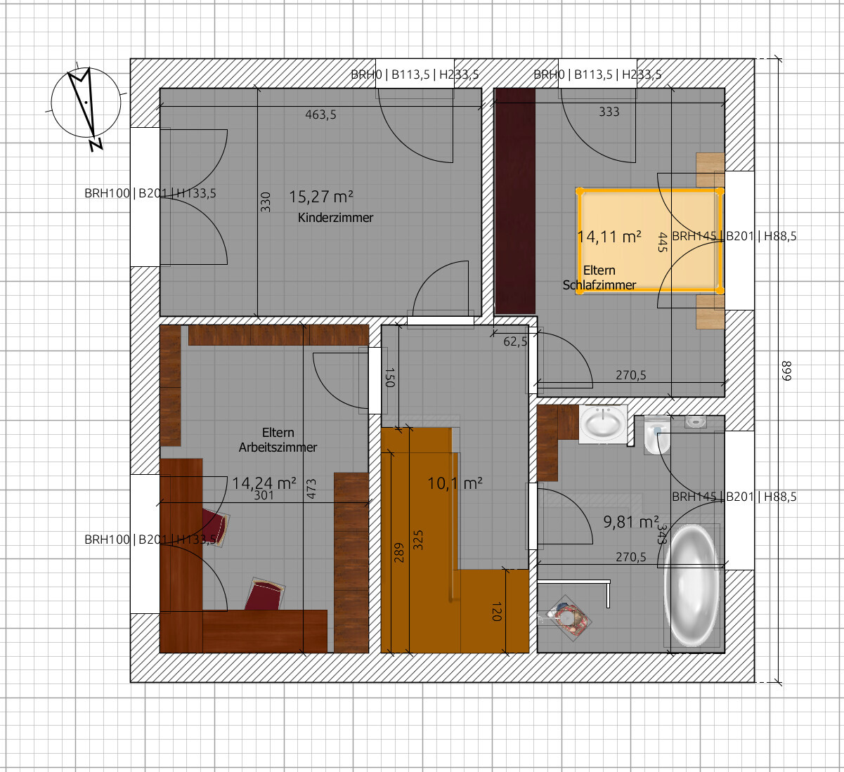

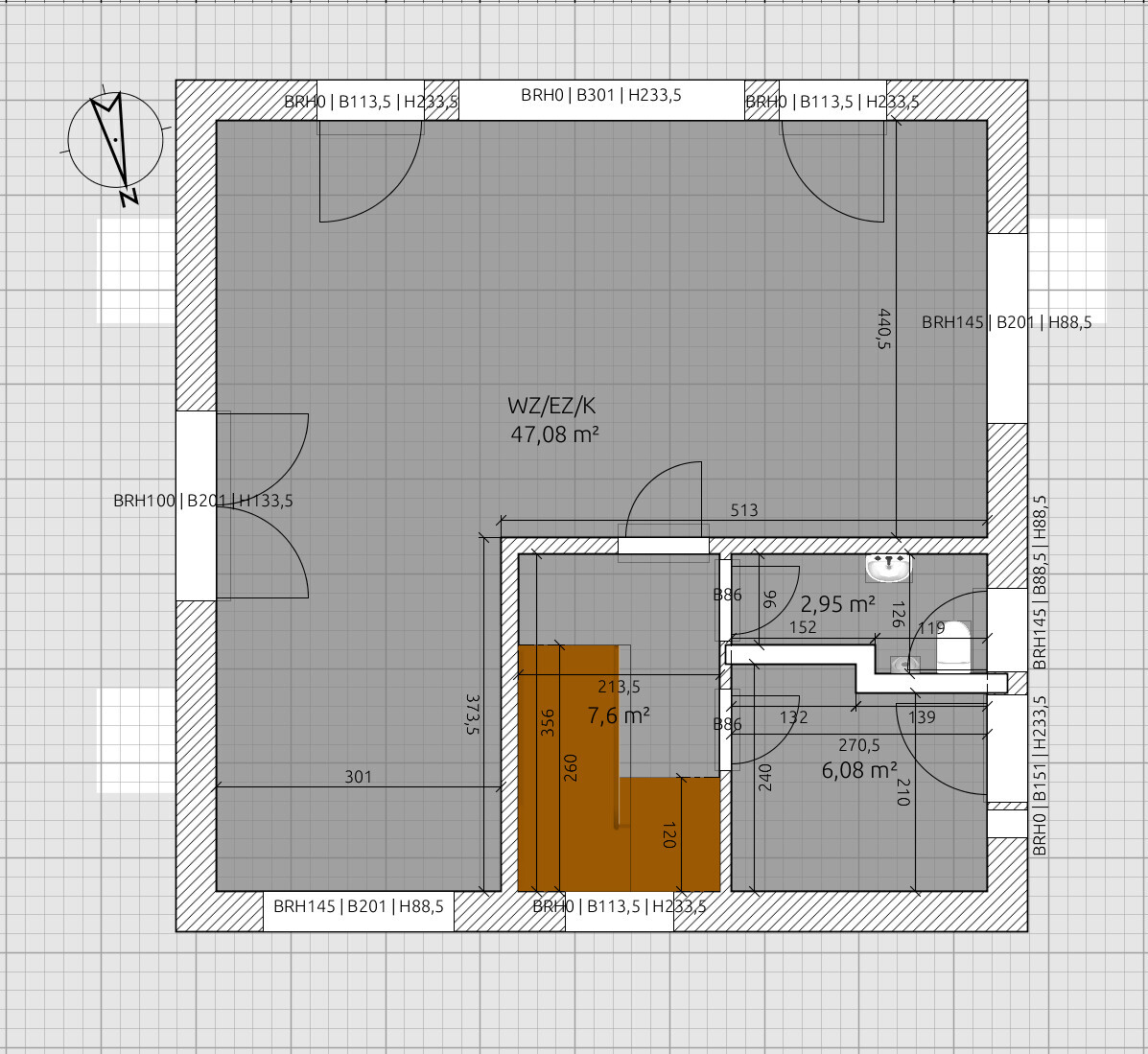

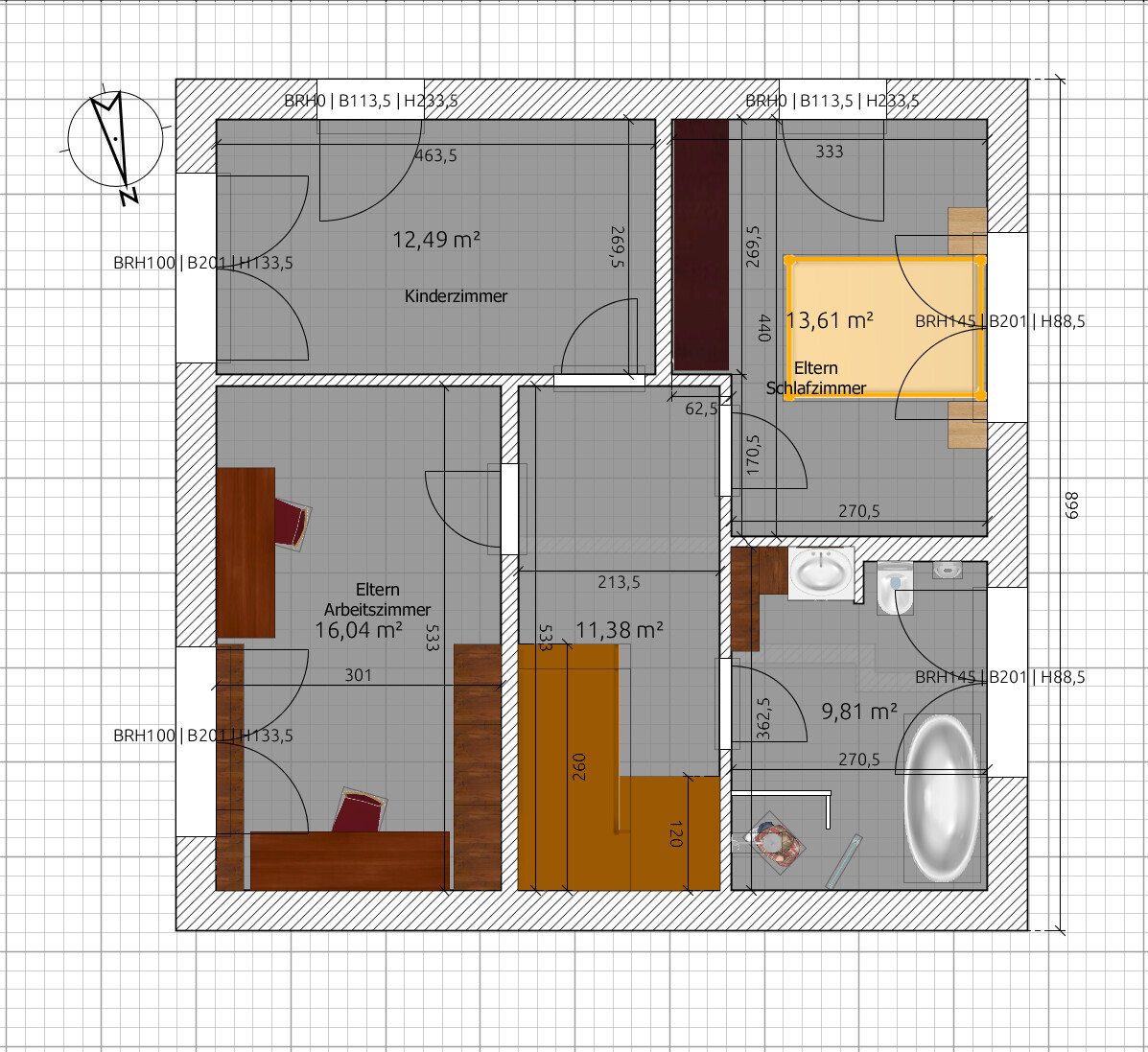

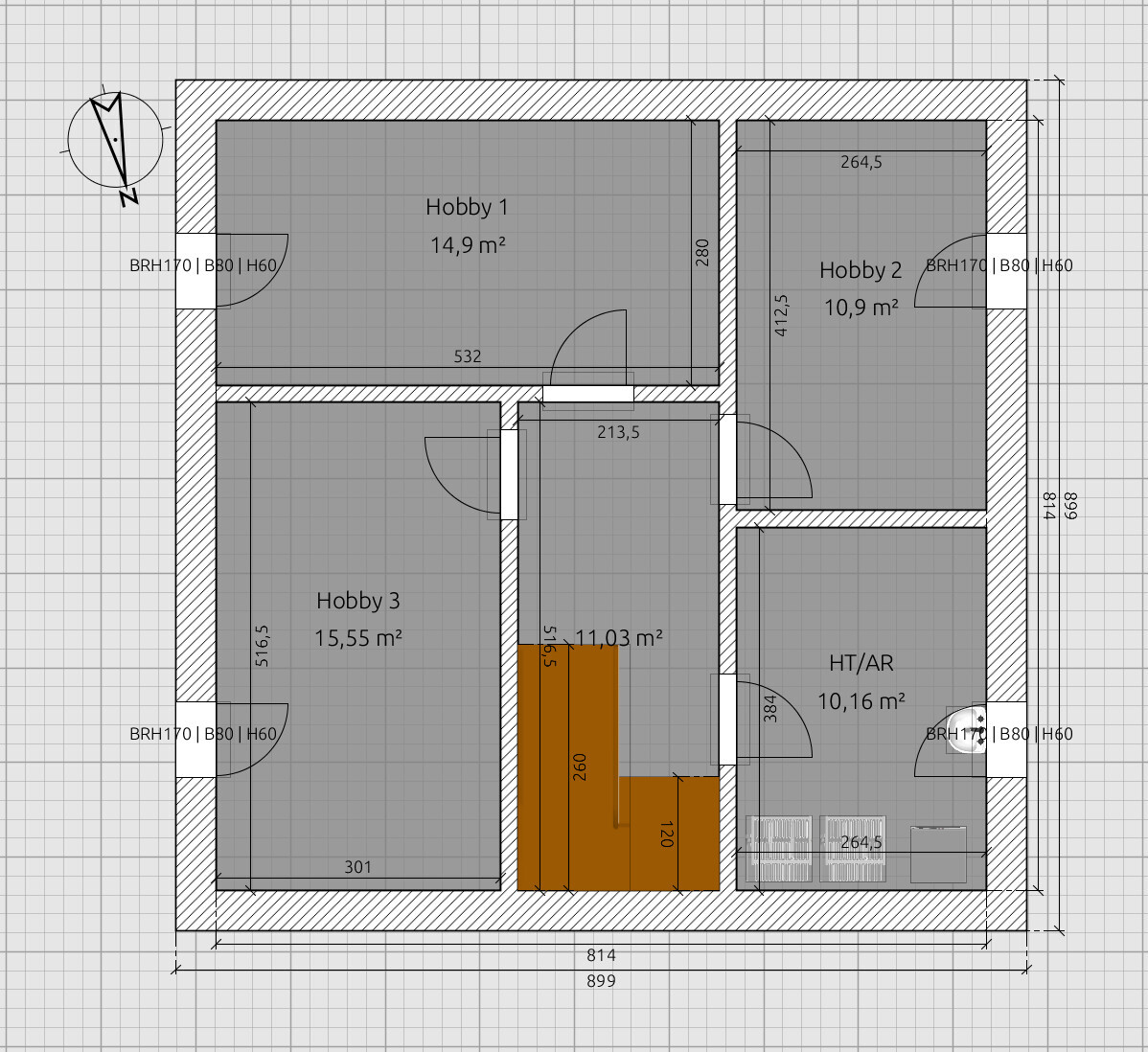

Here is the architect’s proposal.
There are two children’s bedrooms in the attic.
All other rooms, except for the cloakroom/entrance area and bathroom on the upper floor, are labeled.
Grundrissplan eines Hauses mit mehreren Hobbyräumen, Türen und Fluren
Grundriss eines offenen Wohn-/Ess-/Küchenbereichs (47,08 m²) mit Treppe.
Grundriss eines Apartments mit Kinderzimmer, Elternschlafzimmer, Arbeitszimmer, Bad, Flur.
Grundriss eines Apartments mit zwei Räumen, Bad, Küche, orange Treppe, Nordpfeil, Flächen in m².

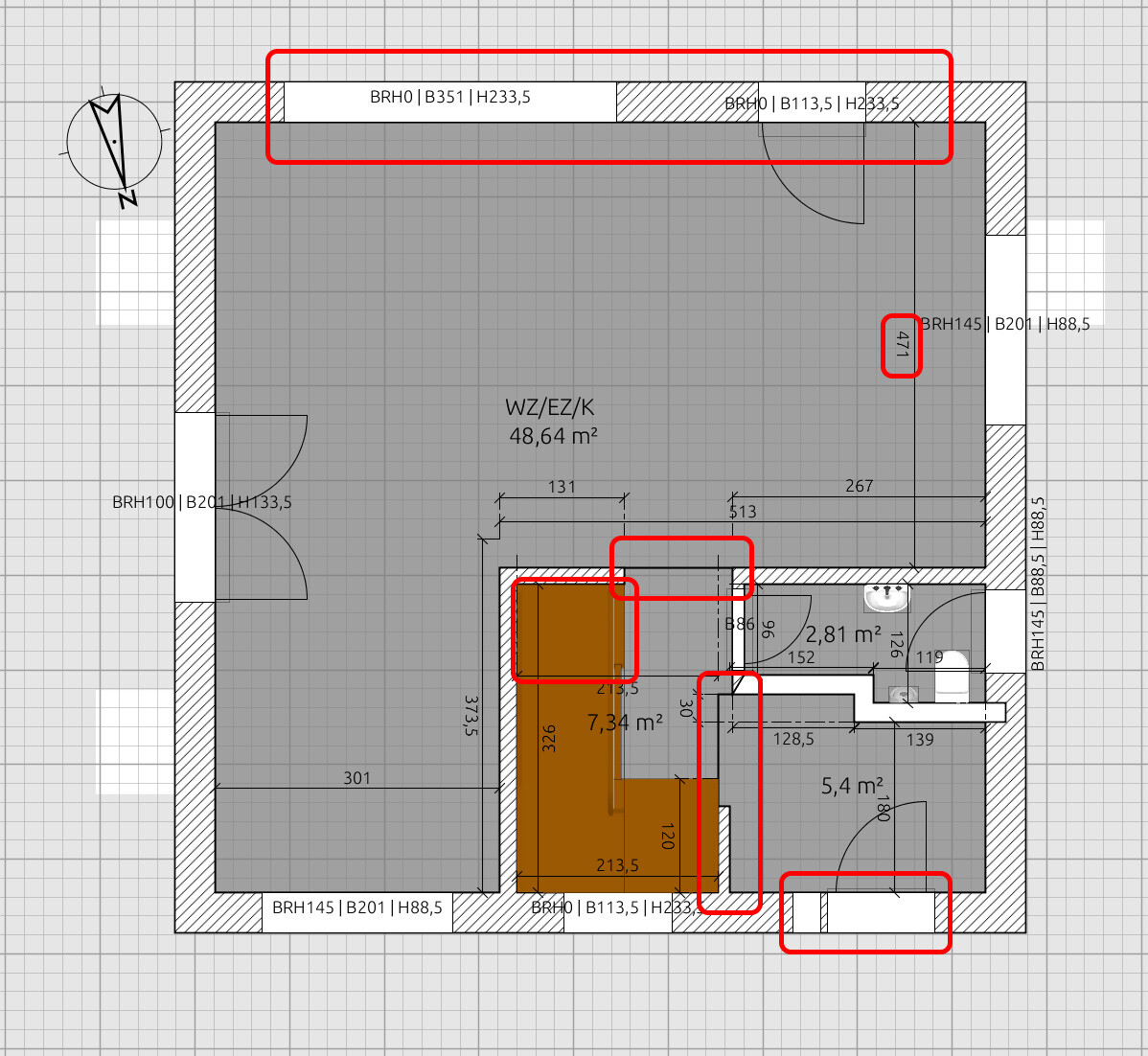

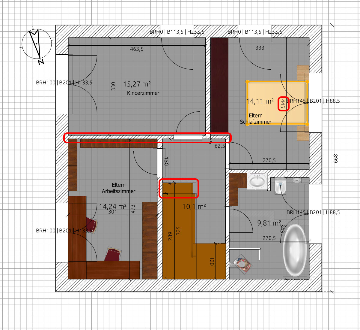

And here are our reported change suggestions
Floor plan with three hobby rooms (Hobby 1–3) and heating/storage room; central orange staircase area
Floor plan of an apartment: open living/dining/kitchen area 48.64 m² (523 sq ft), bathroom 2.81 m² (30 sq ft).
Floor plan of a flat with children’s room, master bedroom, study, and bathroom.
Floor plan of an apartment: two large rooms, bathroom, kitchen, hallway; orange staircase in the center.
grericht
18 Nov 2019 19:07
Here again with the marked changes
Floor plan of a room layout: Hobby 1, Hobby 2, Hobby 3, HT/Storage room with dimensions and red markings.
Floor plan of a living/dining area with open kitchen, doors, walls, and dimension details.
Floor plan of an apartment: children's room, parents’ home office, parents’ bedroom, bathroom, hallway.
Floor plan of an apartment layout with rooms, doors, stairs; orange staircase, red bathroom area.

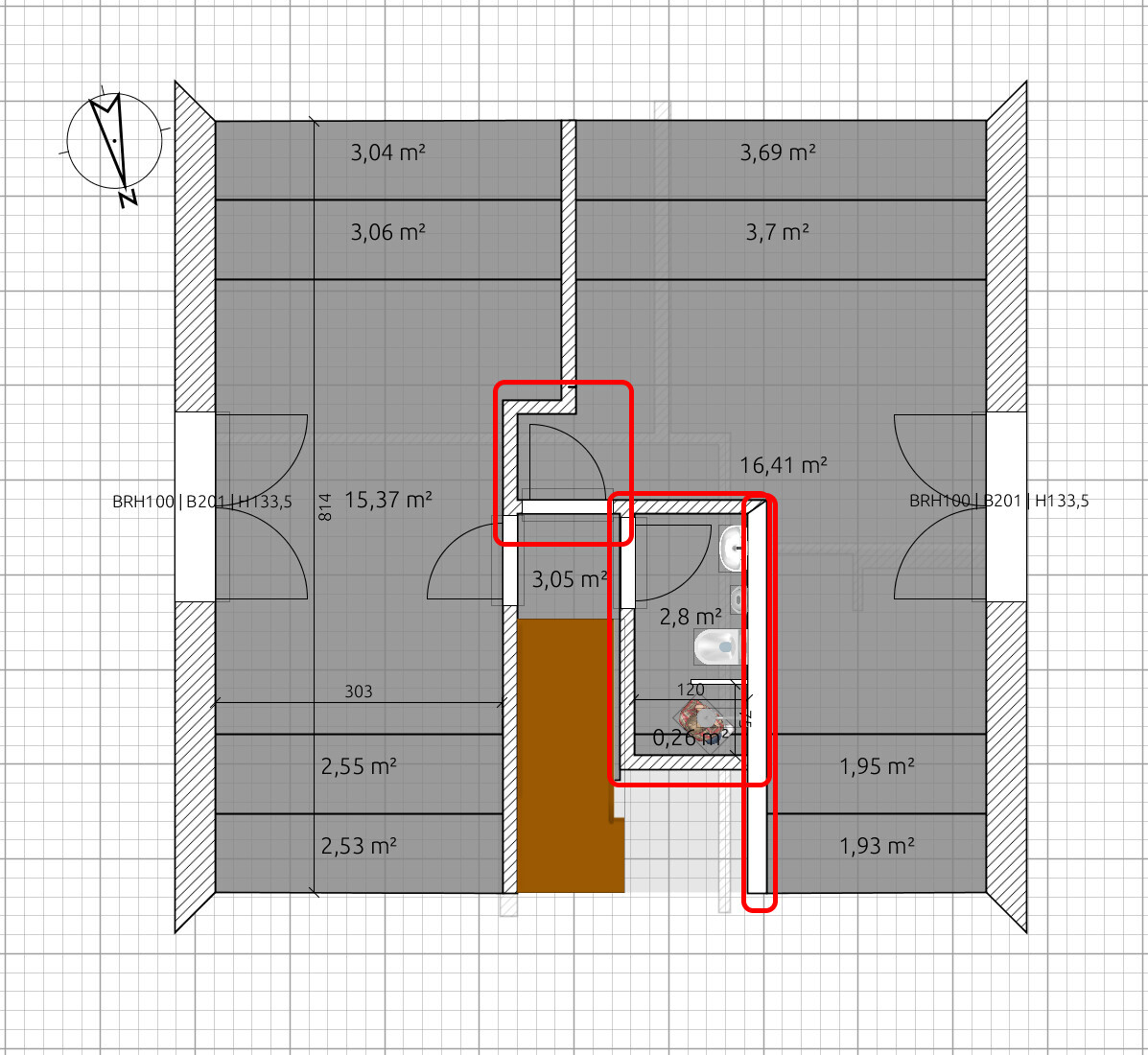

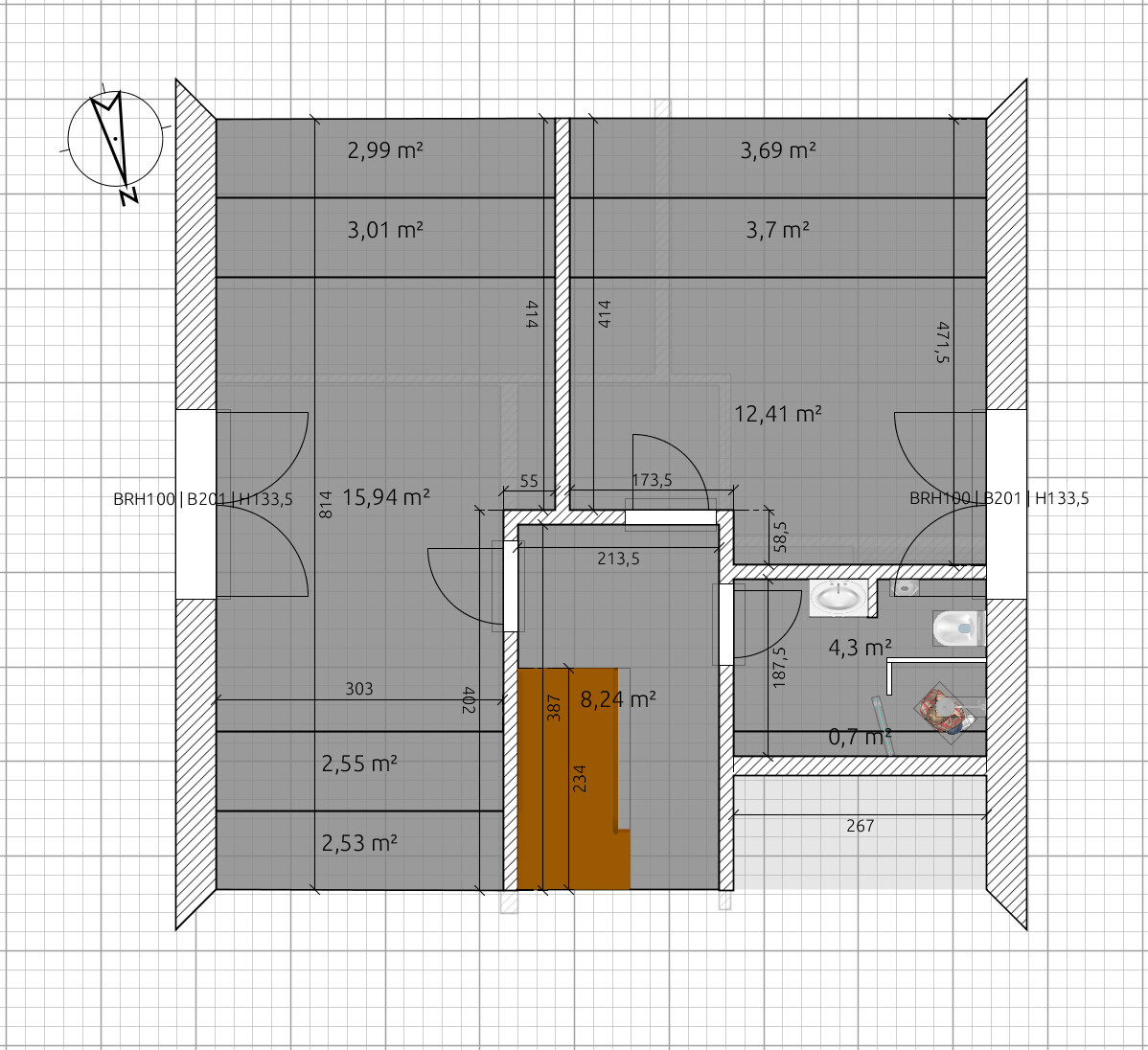

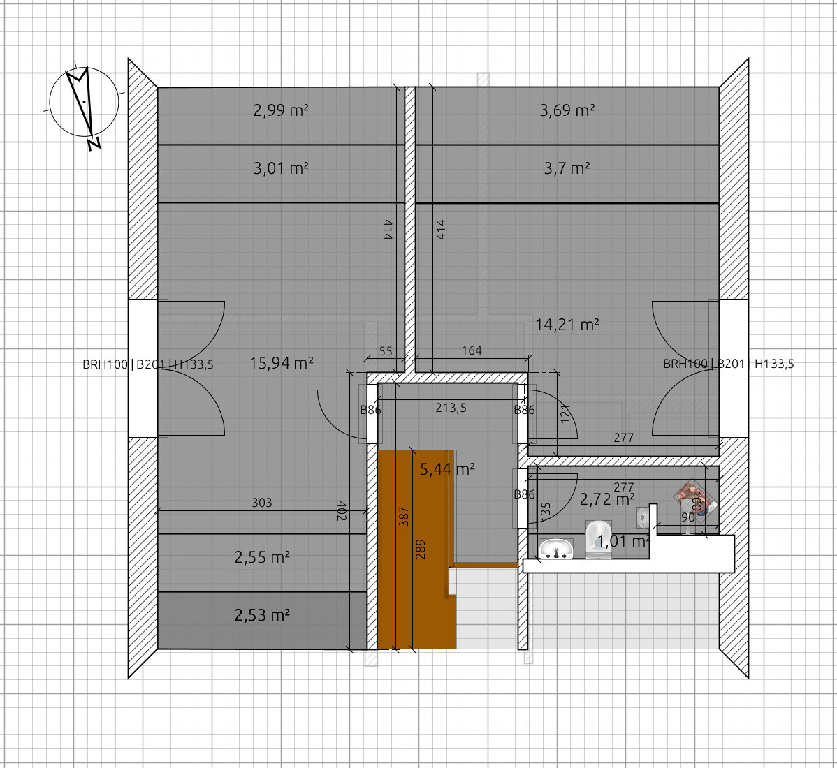

Here is an alternative proposal for the bathroom in the attic, once with markings and once without.
Floor plan of an interior space with several rooms, doors, bathroom, stairs, and area specifications in m².
Floor plan of a building with room sizes; red markings highlight the stairwell and sanitary area.

Why is there no door between the hallway and the open-plan room? You should try furnishing the open-plan space. I find that quite challenging.
The master bedroom is very tight with a rough construction dimension of 333 cm (131 inches). The bed with frame is about 210 cm (83 inches), and a wardrobe with doors is about 66 cm (26 inches) (Pax with sliding doors), leaving only 57 cm (22 inches) for passage.
Attic floor – where is the sloped ceiling? Does the shower fit in the corner? If the 2 m (6 ft 7 in) line is supposed to be there, it might become very cramped.
A site plan with the garage marked would be helpful to understand why the entrance door was moved. That immediately reduces the wardrobe space by 90 cm (35 inches).
