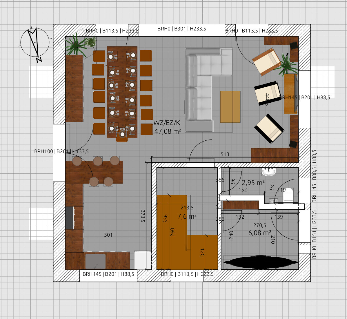

But that’s with the spiral staircase mentioned above. The architect’s design is only 440cm (14 ft 5 in) wide, so 30cm (12 in) less.
The sofa is very large. Ours will probably be significantly smaller!
EDIT: The shelving unit in the bottom right of the living room is still aligned to the width from the architect’s design. So it would also work with 30cm (12 in) less.
Open floor plan: kitchen, dining table and living area with sofa, armchairs and side tables.
grericht
18 Nov 2019 21:40

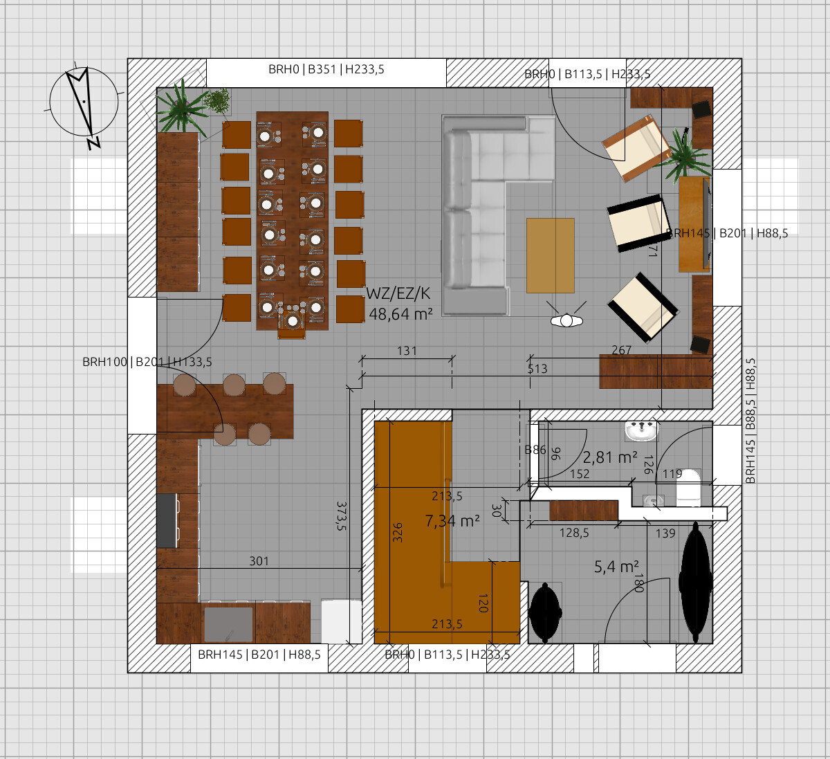

Here are the furniture details from the architect's design again. As mentioned, the sofa is really large.
The two floor-to-ceiling windows on the right and left cannot be opened. Originally, two sliding doors were planned, but we decided against that. Now, there is the glass sliding door measuring 351cm (138 inches) to the dining area, and "into" the living room just a regular floor-to-ceiling window, to avoid too much light in the living room. In our version, the sliding door opens on the right side—essentially from the "alley" between the sofa and the dining table.
