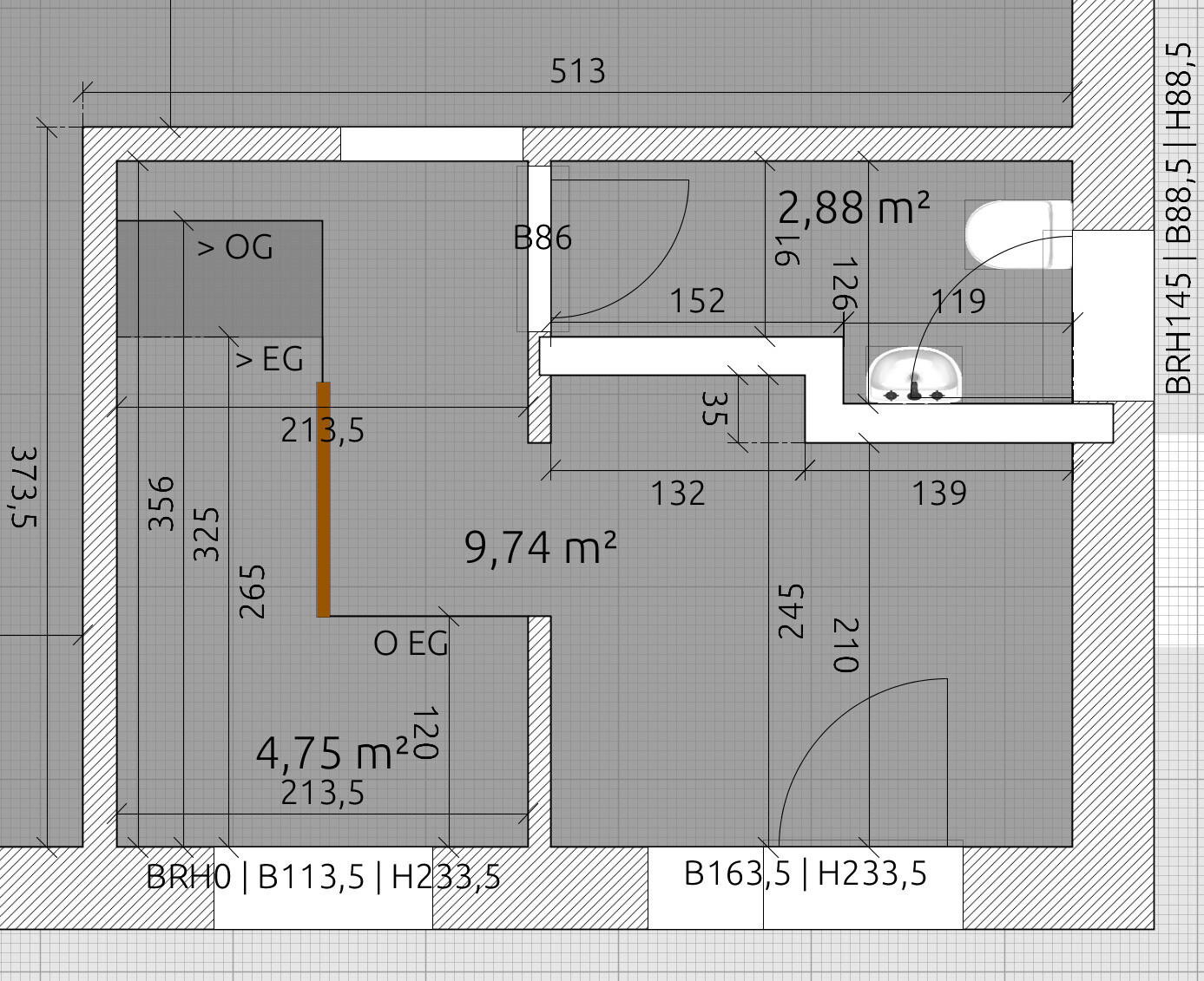

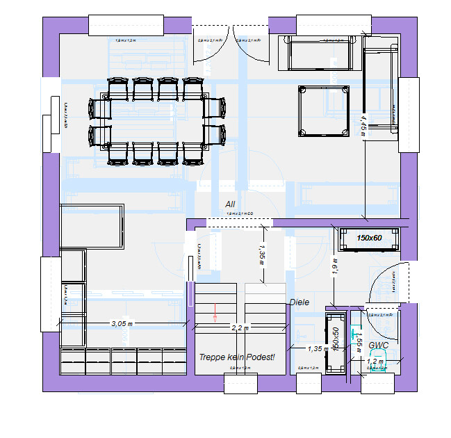

Firstly, your window placements won’t work because you need beams on the ground floor. Those must be supported somewhere on the exterior wall. But you have windows everywhere there...
Secondly, take a look here: this layout is much more practical since it avoids creating a bottleneck inside the house or an installation that could be inconveniently positioned in the center.
Thank you very much! I have recreated your design for myself. See the attachment.
Has the problem you described been resolved in all three versions? I have no knowledge of structural engineering, but the architect initially planned it this way?!
kaho674 schrieb:

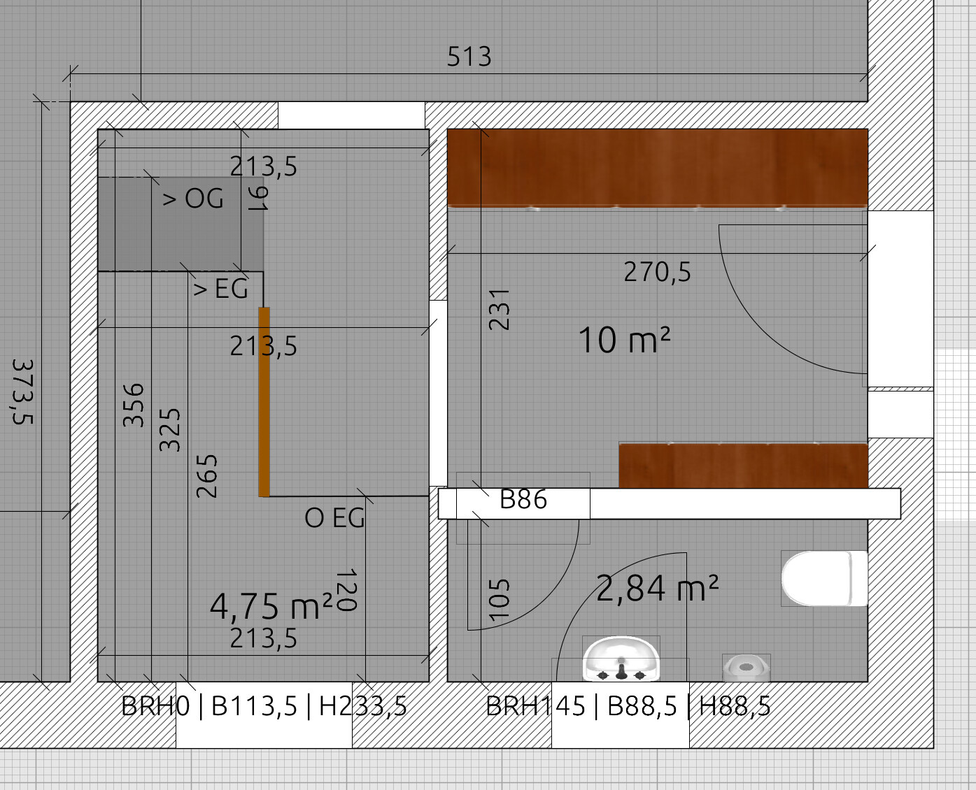

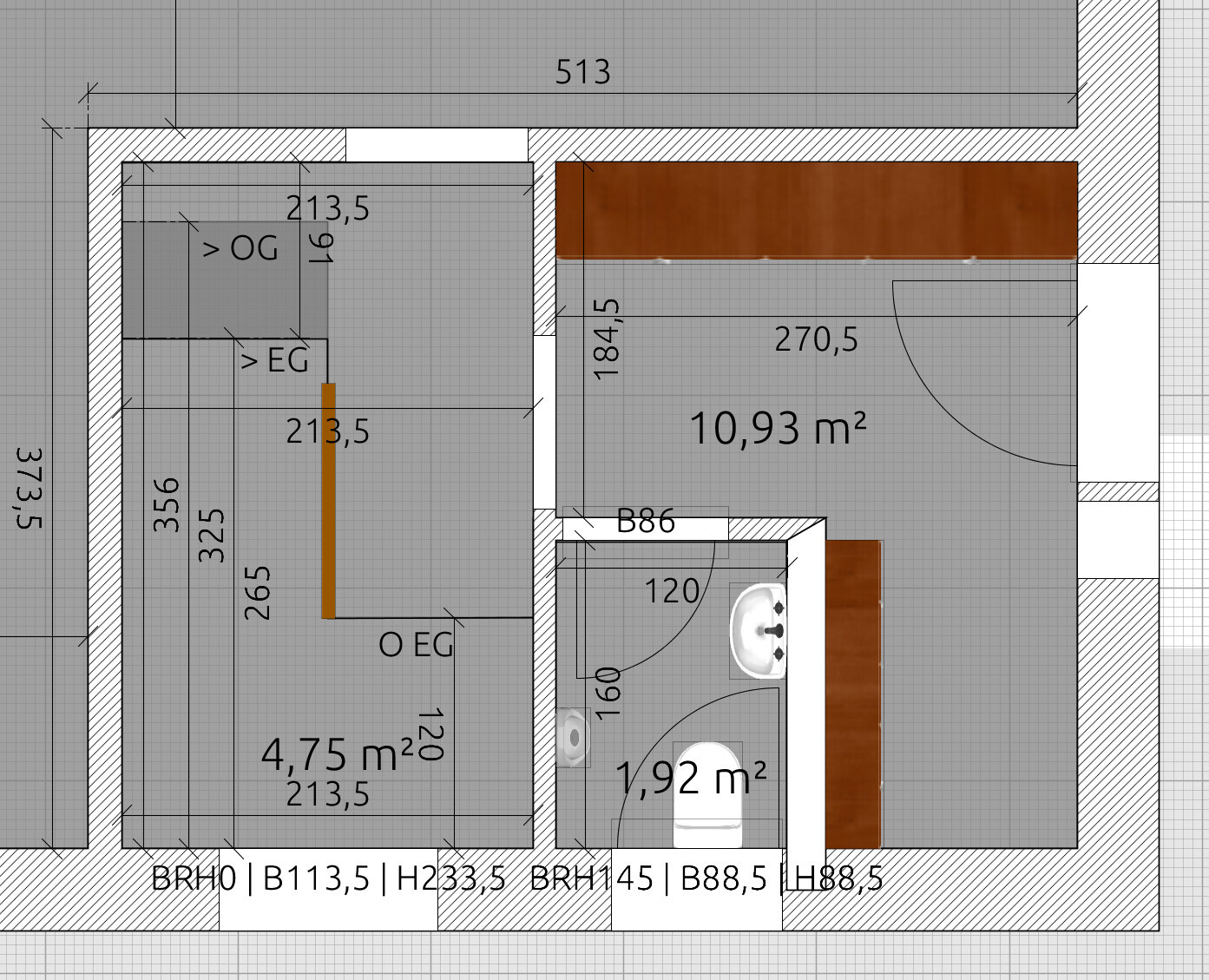

Revised proposal for the hallway from #108 regarding the dimensions:
If necessary, swap the WC and the 50cm (20 inch) cabinet. I would prefer it this way. But no one can go against your self-imposed (quirky) rules.
For the new shoe obsession, one could possibly add a vestibule/entrance area including a shoe cabinet as a subordinate element in front of the entrance. You would need to check the exact regulations for "subordinate element" in your municipality.
Thank you! I have now integrated it into my plan again. See the attachment. As I’ve said before, we absolutely want to prevent having to walk through the "shoe dirt zone" with clean shoes on (except my wife, all of us go barefoot). I believe this request isn’t that unusual and is common in other designs as well. We really won’t give up on this. We have also considered a covered entrance. However, I would prefer to keep that more as an optional “roof only” idea and not deal with it in excavation and foundation planning. It seems possible either way.
There are now three possible layouts: one from the architect, one from ypg, and one from kaho674. Both new ones are significantly more straightforward but have the drawback that the wardrobe has to be passed through on the way to the WC. I don’t think this is a problem since, in both cases, there is the option to park dirty shoes beforehand. In short: I like both better than the previous version (which was developed solely because we firmly requested that the WC not be accessed through the wardrobe).
I have moved both WCs to the limit on the small side, I think. The urinal fits better in ypg’s design. The "extra wardrobe" in kaho674’s plan can be really useful but could also become messy quite quickly. At the moment, I think I prefer ypg’s version. There, the entrance door just doesn’t quite line up smoothly under the window above (neither flush left nor right)—this also applies to kaho’s plan, though there is more room to adjust there.
All three variants could be open to the corridor or can be nicely separated by a wall and sliding door.
Floor plan of an apartment: two rooms, bathroom, doors; dimensions and brown furniture.
Floor plan: bathroom (WC/shower), living/kitchen area; door arch; dimensions in cm; 10.93 m² (118 ft²).
Floor plan of an apartment with several rooms, doors and area measurements in m².

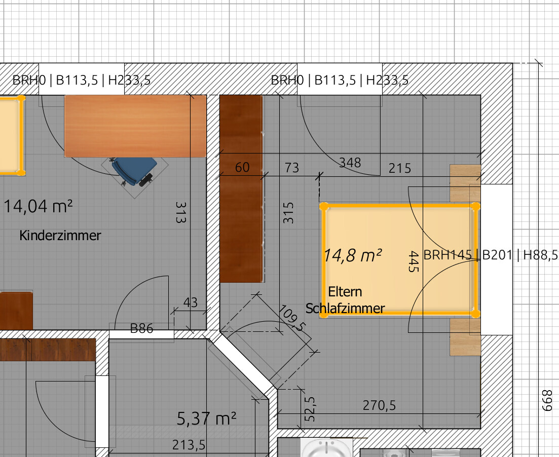

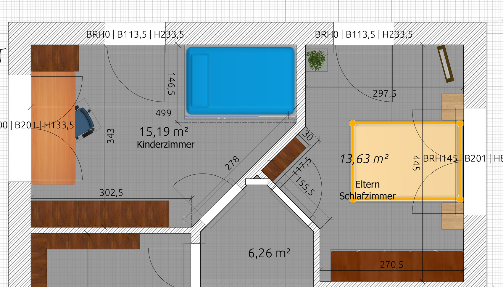

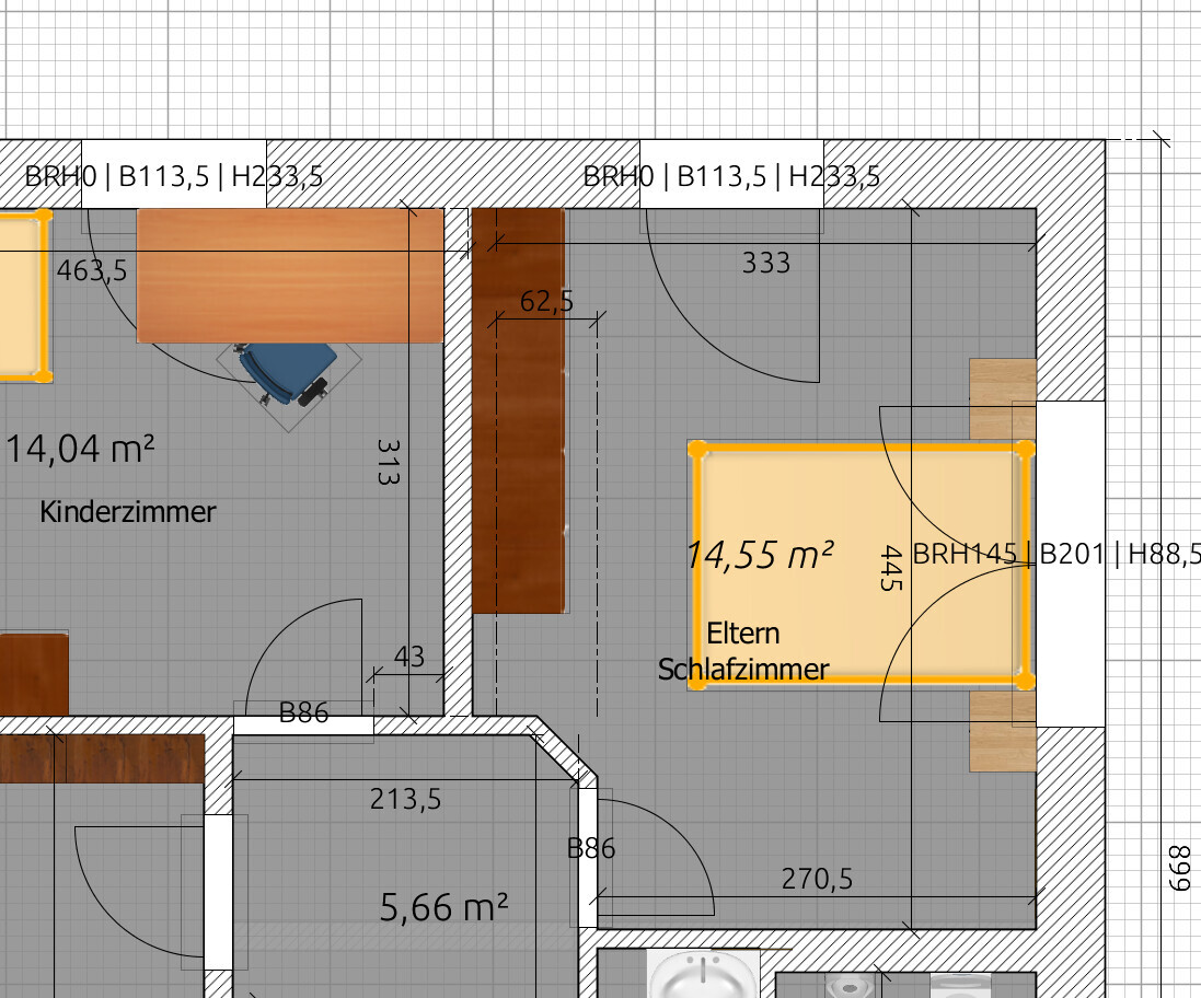

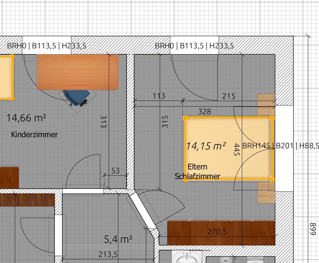

Here are three bedroom layout options that should help with relaxation.
In one option, two narrow doors had to be installed, and in another, one narrow door was used, which I find unattractive. I am not sure if these options are even structurally feasible.

Oh, by the way: The goal was to be able to place a shelf or cabinet on the wall behind the door in the children's room if needed. But I think that is not a very high priority.

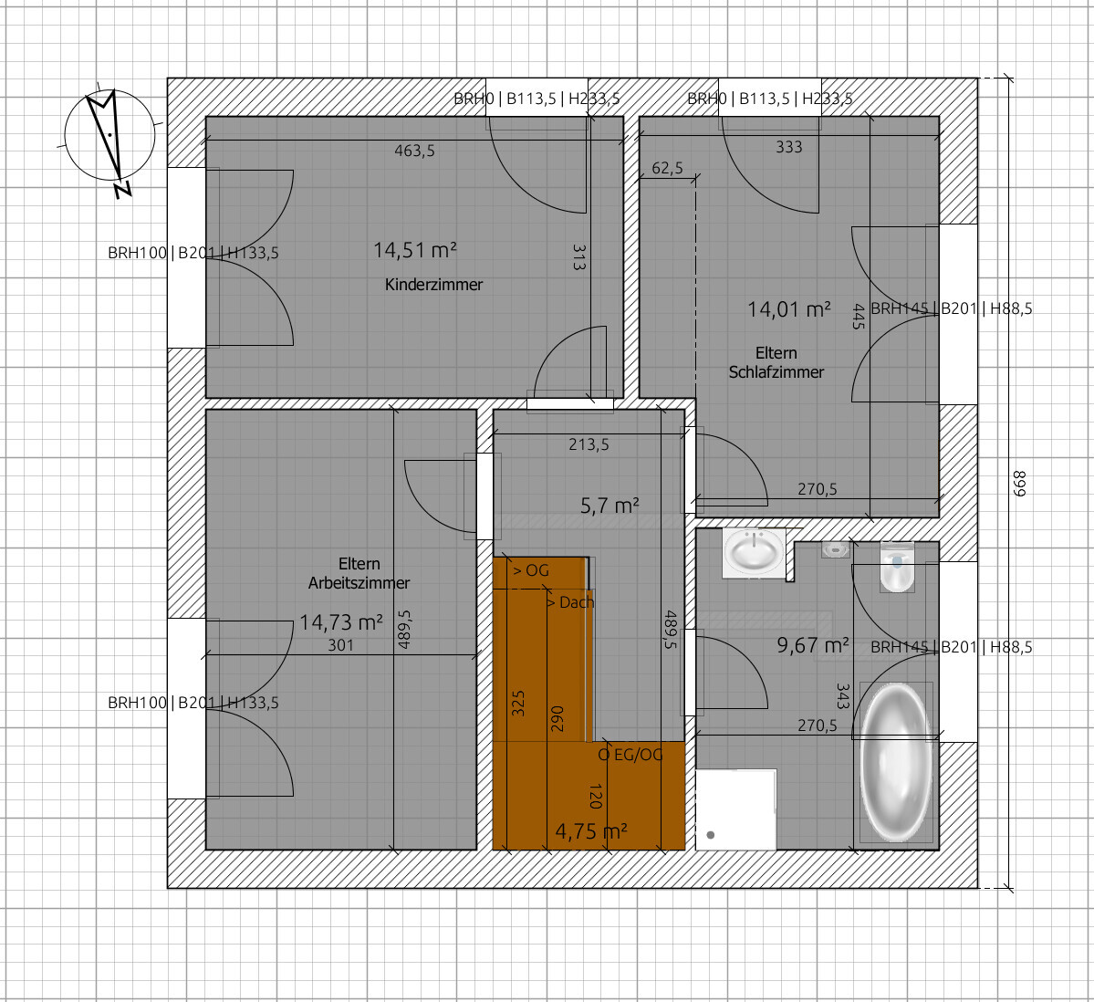

We are now slowly moving into detailed planning. We haven’t made much progress with the bedroom yet. Besides the architect’s design, he considers only the attached one to be realistic. I have now come up with a rather special alternative (idea02). Are there any opinions or assessments on this?
The one wardrobe with 270cm (9 feet) is enough for us. I think the walking spaces are sufficient. The bed could be wider as well. And the best part: my wife gets her mirror with lighting from two sides.

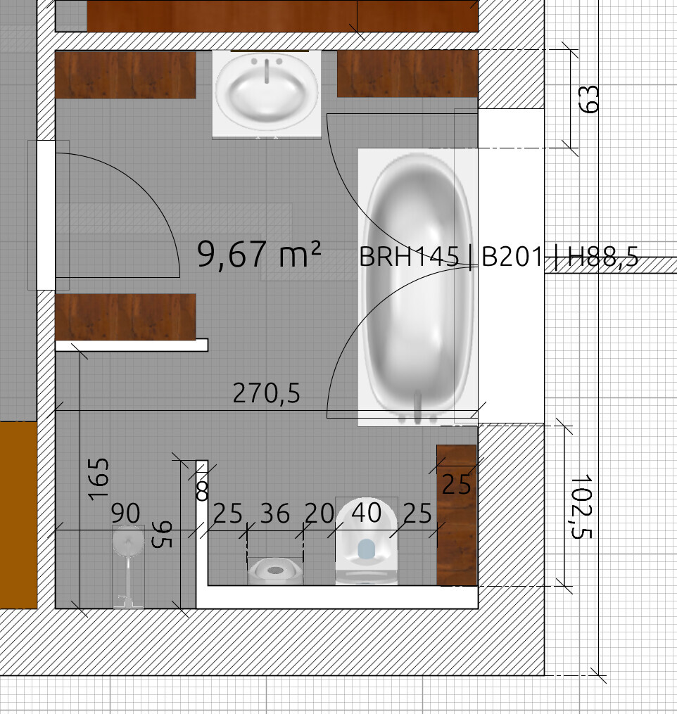

And here is a planning idea for the bathroom.
The sink could, of course, also be placed all the way to the left. It is also unclear whether the shelf behind the door is still needed.
The shelf next to the toilet is likely a wall-mounted shelf for magazines and toilet paper.

kaho6742 Dec 2019 10:08
grericht schrieb:
We haven’t made much progress on the bedroom yet.
It might be easier if you swap the bedroom and the study. That would also make more sense if the study becomes child 2’s room before the attic is finished, since then both children’s rooms would be on the southwest side, with plenty of light and sunshine.
grericht schrieb:
And here’s a planning idea for the bathroom.
The sink could also be placed all the way to the left. It’s not clear if the shelf behind the door is really needed.
The shelf next to the toilet is probably more of a wall-mounted shelf for magazines and toilet paper.
I would rather wonder how you plan to use the shelf or cabinet behind the bathtub, and whether you might hit your knees on the tub when sitting on the toilet or walking to it. Also, the shower with its walls is so dominant that it breaks up the whole room into a maze-like layout, similar to what you are planning at the entrance (although the current state of that plan is unclear).
