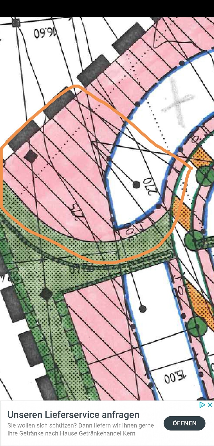

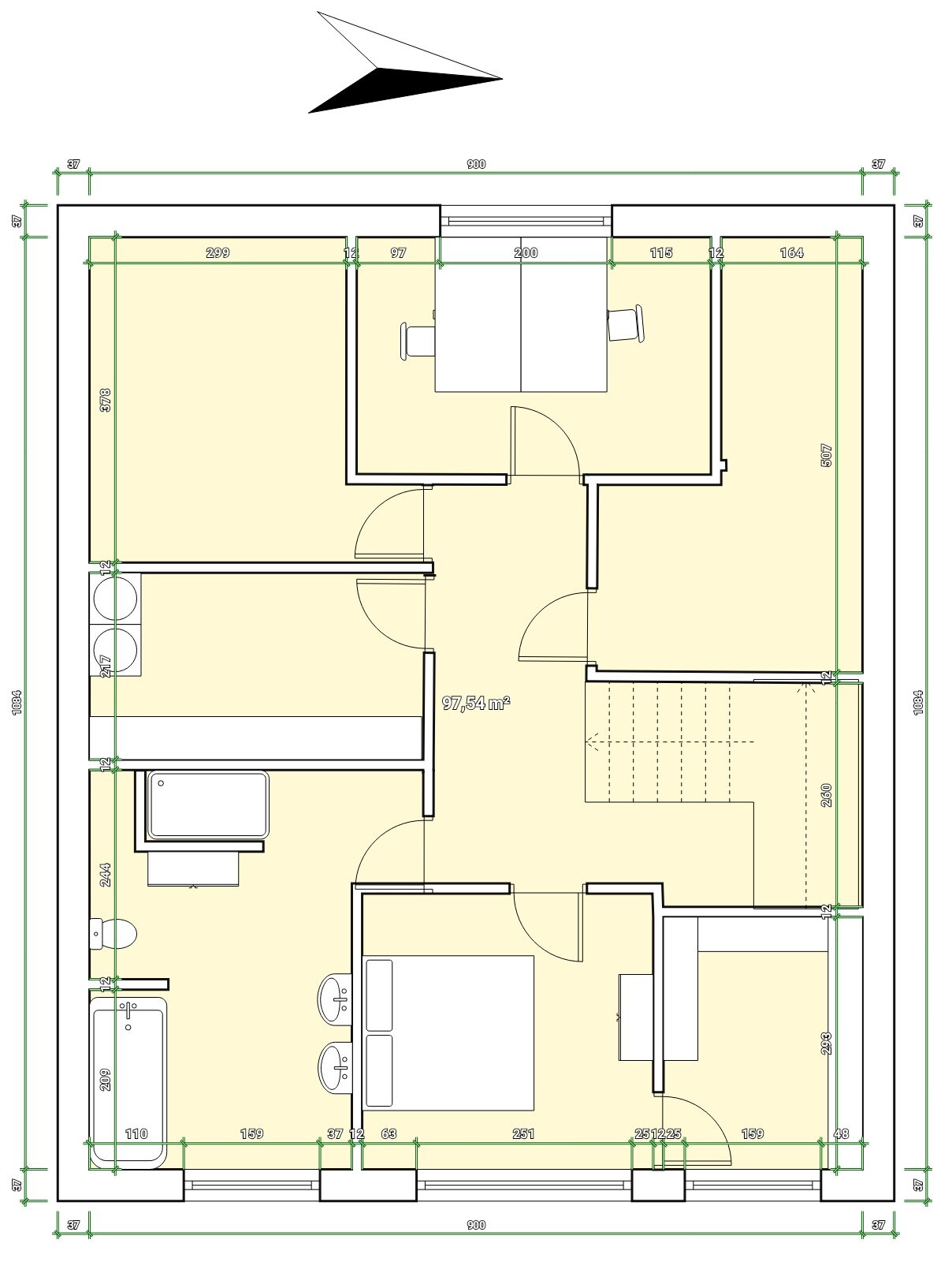

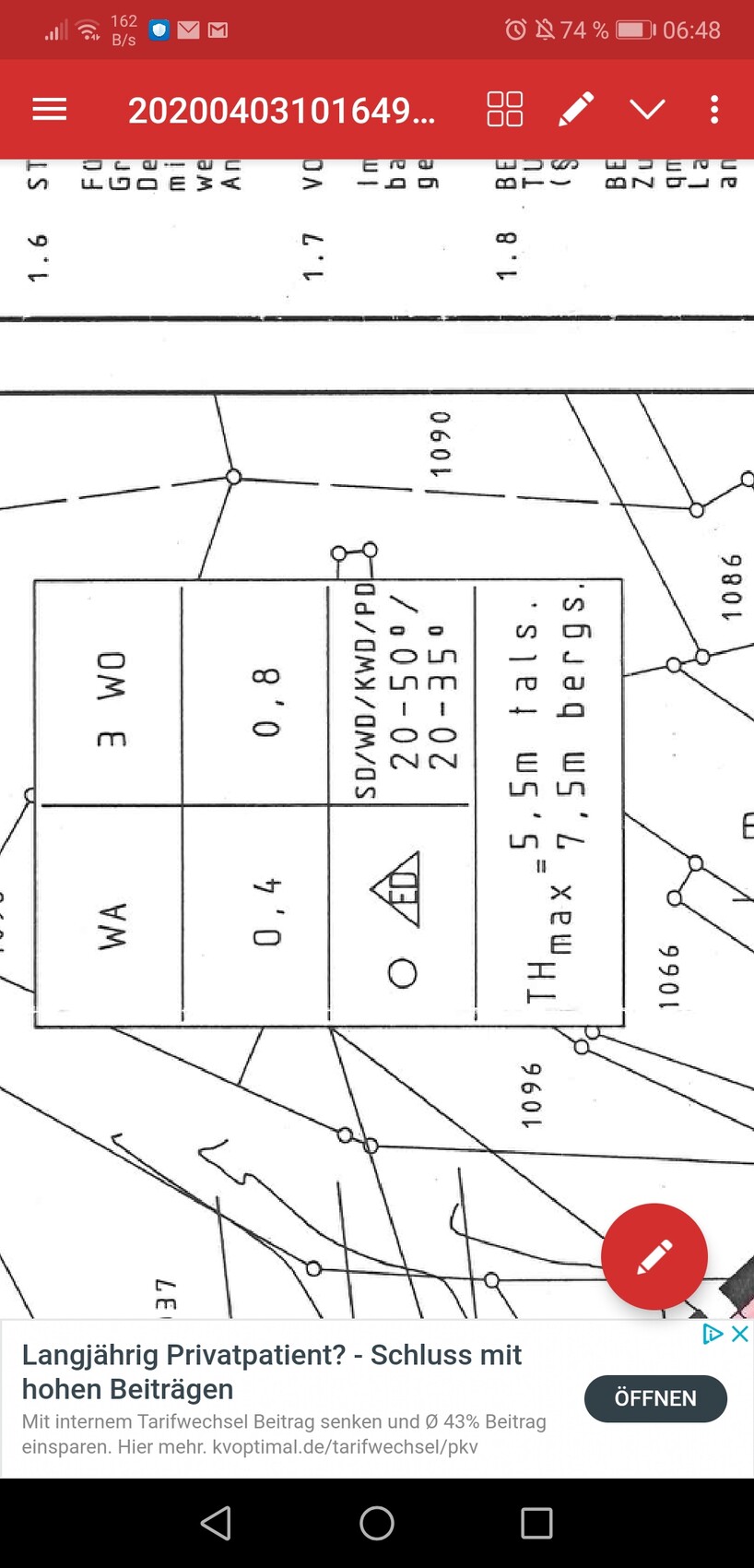

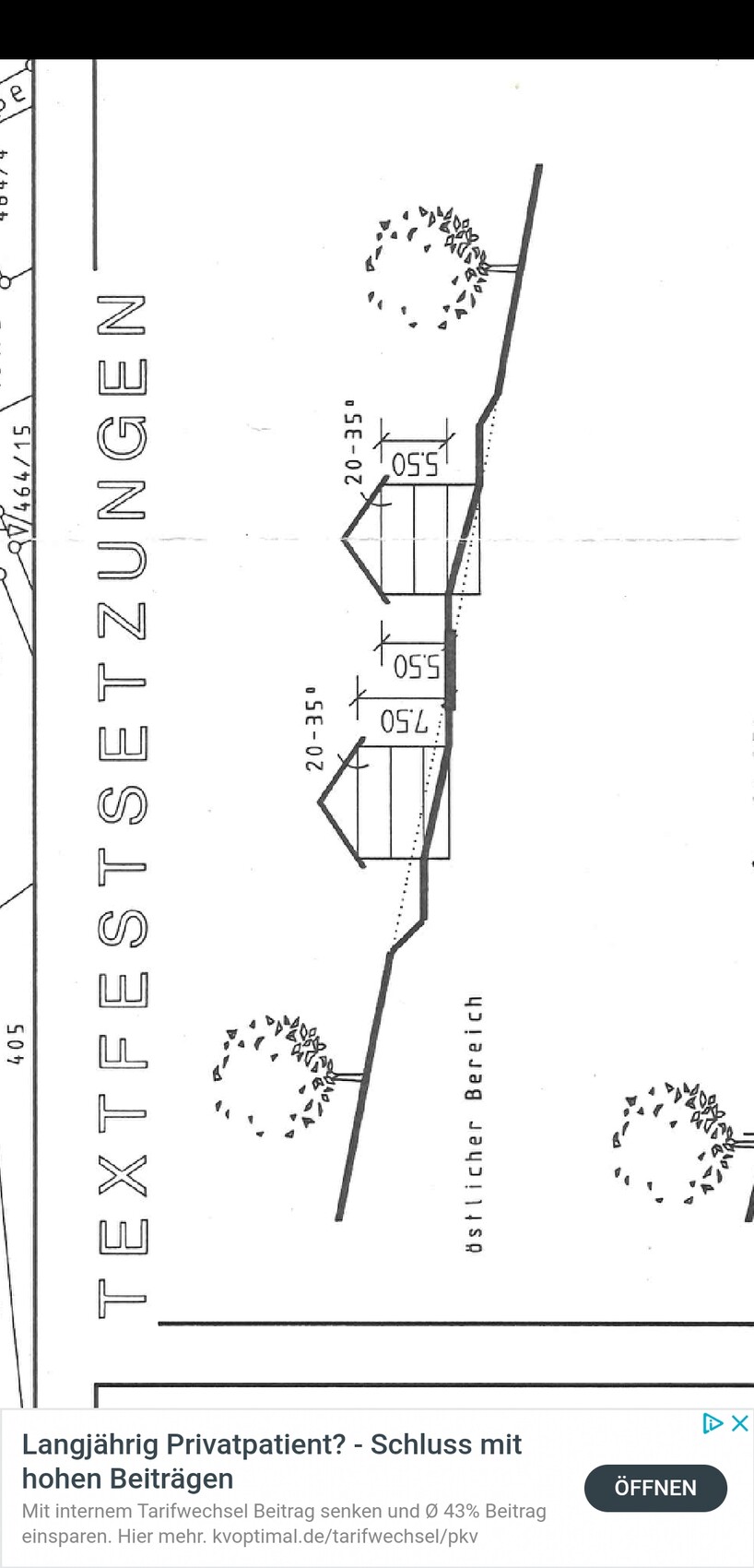

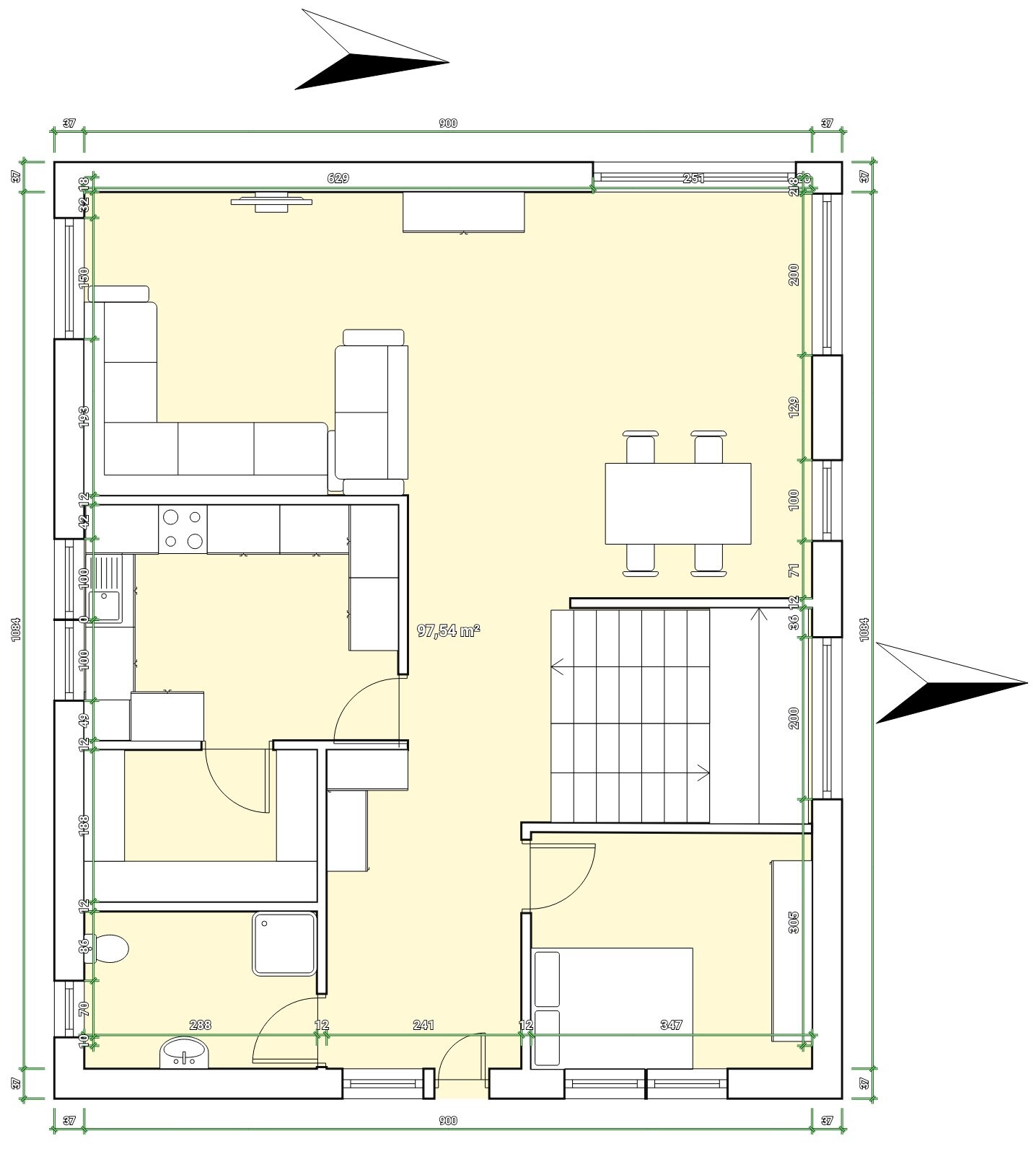

ᐅ Single-family hillside house with basement for 2 people, including a home office and hobby rooms
Created on: 15 Apr 2020 07:48
wibble
Plot Size
Slope: see attachment. Quite steep near the street at the bottom, fairly flat at the "garden" area at the top
Floor Area Ratio 0.4
Building Coverage Ratio 0.8
Building envelope, building line, and boundary: irregular building envelope, see attachment, 18 meters
Edge development: not permitted except for ancillary buildings
Number of floors: not specified
Roof shape: not specified
Architectural style: not specified
Orientation: not specified
Maximum heights / limits: eaves height (section from exterior wall to roof covering at street level) 7.5 meters (24.6 feet), ridge height not specified.
Other requirements
Homeowners’ Requirements
Architectural style, roof shape, building type: gable or hip roof, preferably with dormers to add variation to the large roof
Basement, floors: basement, then ground floor, then upper floor with 1.40-meter (55 inches) knee wall
Number of occupants, age: 2 adults around 30 years old, 3 cats, no children planned but 2 rooms on the upper floor specifically desired for hobbies
Space requirements on ground and upper floors: see floor plan

Chris2511 schrieb:
If I were you, I’d save yourself the trouble. Put it in the hands of a competent architect—I can only highly recommend that. Also, start thinking about financing early. Statements like “because I want to pay it off quickly” and “we could probably afford more” don’t sound like you’ve really worked that out yet.
Oh, and a 6m (20 ft) garage isn’t oversized. Ours is 7.15m (23.5 ft). I want some extra storage space for bicycles, tires, etc. Tires and bicycles are going in the basement. Actually, we only had financial advice and nothing more. Since I work in finance myself, I’m familiar with the whole process and didn’t really learn anything new during the consultation. They just asked how much the house would roughly cost; I said 500,000, and then they showed me some amortization tables with basic data and explained them. They kept suggesting we stretch out the loan for a very long time because interest rates are low right now, but I don’t want that (and it doesn’t make sense to me). We can definitely afford monthly payments of 2,000. According to our household budget, 3,000 would also be possible, but I’d like to keep a bit of a buffer. Currently, we pay 2,000 rent and save about 1,200 per month on average as equity.
So, my floor plan has been approved by two architects after I made a few minor changes beforehand. It still worked out today because they showed a lot of interest in the house, and another architect I don’t know was invited. I had the plan drawn freely beforehand. However, afterwards they thought mine was excellent.
I would still like to hear your specific concerns so I can address them. For that, I need more detailed feedback. For example, if you feel I have just arranged a series of rooms in a row. The architects’ key message was, “Yes, that’s exactly the point, and it’s a very good arrangement of rooms.”
wibble schrieb:
So, after a few minor adjustments I made beforehand, my floor plan has been approved by two architects. That’s odd, usually the client approves the architect’s floor plan. To me, it still looks quite amateurish. I’m also having trouble understanding the three floors and the plot layout. Here’s the ground floor, over there the basement, which still needs changes, and in between, the new designs. And now this jumble has been approved by some architects? What is their involvement in the project? Are they hired? Two of them? If I were paying two architects, I would expect a professional design, including a cost estimate. Spending well over 500,000 without relying on a professional architect experienced with building on a slope seems quite unwise to me.
kaho674 schrieb:
Strange, usually the client approves the architect’s floor plan.
To me, this still looks quite amateurish. By now, I also have trouble understanding the three floors and the plot. Here is the ground floor, there the basement, which still needs to be changed, and in between are the new drafts. And now this mess from some architects has been approved? What’s their role in the project? Are they hired? Two of them? If I’m paying two architects, I would expect a professional design including a cost estimate. Spending well over 500K while you as an architect are still experimenting on a slope site seems rather unwise to me.My wife has been friends with the architect since childhood. We’ve already had an appointment with him regarding the build. We have another scheduled for May. However, today we were invited there for a birthday and are still here. His colleague was also there, and they ended up discussing various floor plans. At the very end, I presented my floor plan after they had already drawn plan after plan because they simply enjoyed working on it.
They thought it would be very feasible to build. They would make it a bit more open, but as it is, it would be great. Definitely achievable and sensible.
