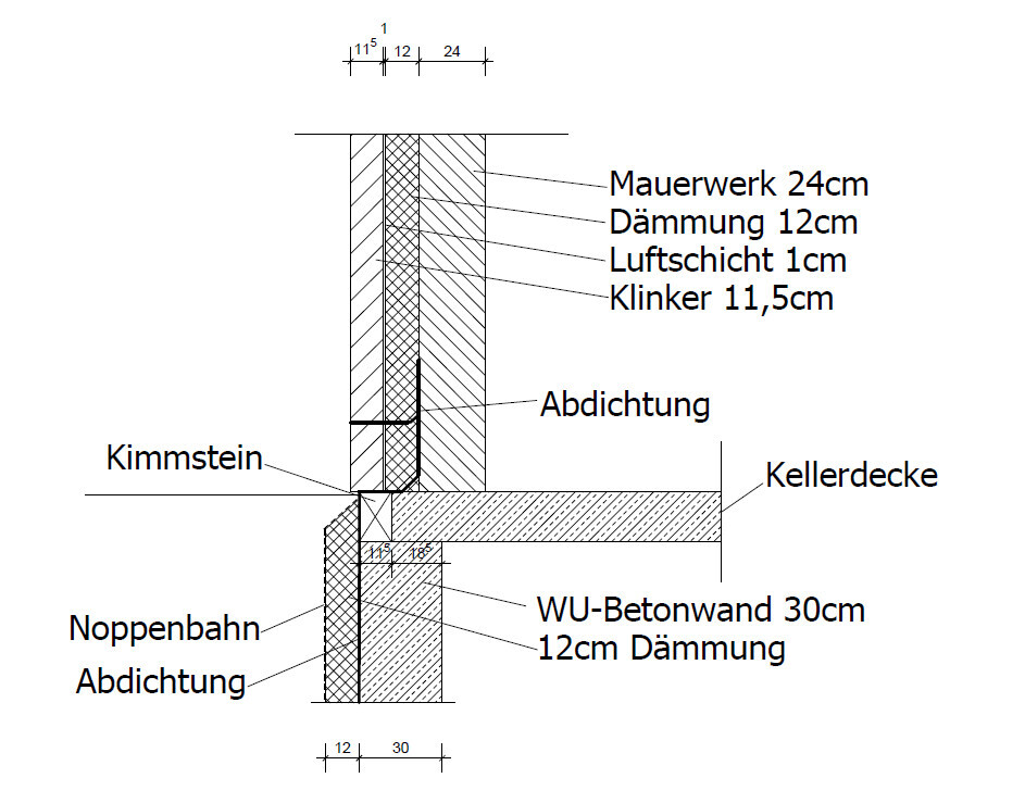

An architect who also acts as the contractor can be a cost-effective solution, in my opinion, when building properties for their own rental portfolio. However, this arrangement is less favorable for the typical client-homeowner: from the client’s perspective, the architect should advocate exclusively for the homeowner’s interests, while the contractor has their own priorities (such as completing the project cheaply “at purchasing costs”) and is content as long as the building lasts through the warranty period (which, according to the German Construction Contract Procedures – VOB, is shorter than the statutory building code warranty). This influences the choice of building materials and construction methods: concrete work requires a high proportion of skilled, experienced workers, whereas bricklaying can involve apprentices, and labor costs more than materials. Just my 2 cents ;-)
Kaspatoo schrieb:
I have now received the following proposal from the architect, and I think it looks quite solid.My initial spontaneous look at the drawing suggests: half a centimeter (0.2 inches) more "air gap," and you stay neat inside and outside within the modular grid.https://www.instagram.com/11antgmxde/
