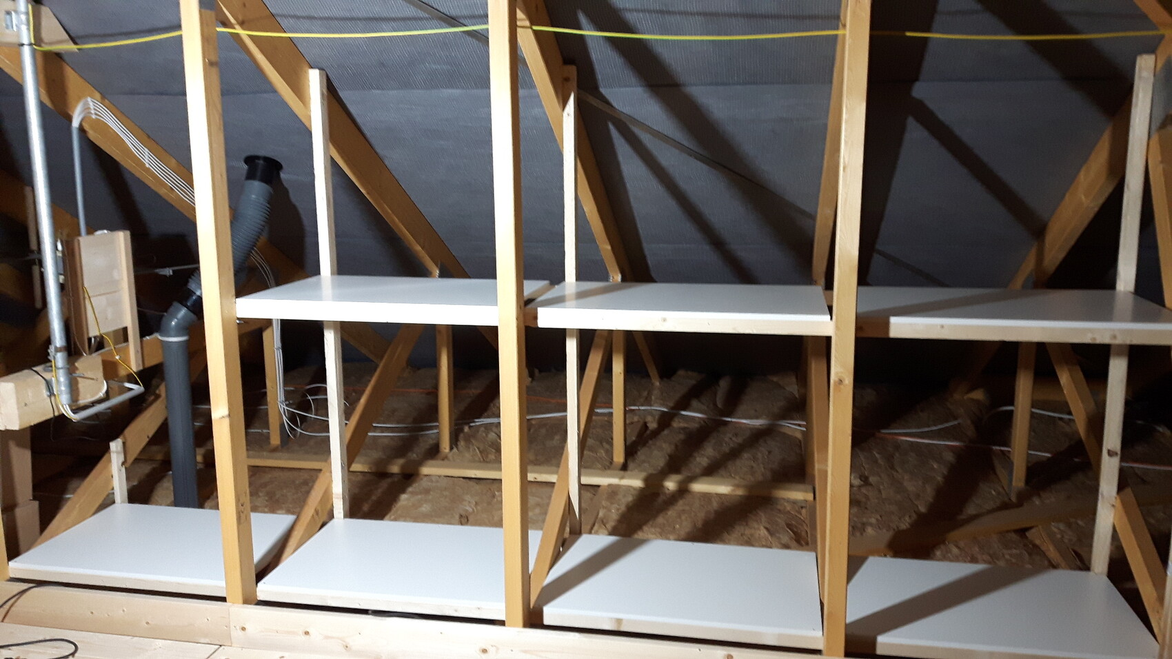

I bought some shelves and wood at the hardware store, then cut them to size and installed them in the niches. I filled all the gaps and later labeled and placed boxes there.
Unfinished attic with wooden studs, white shelves between them, cables and hoses.
Tolentino28 Nov 2022 12:17
Yes, that’s actually the smartest approach. Since there is already so much wood, you might as well make use of it...

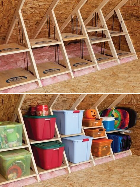

kati133728 Nov 2022 12:45
You often find something like this on the internet:
Attic storage with wooden structures and colorful storage boxes arranged in rows.
It’s not an off-the-shelf solution, but putting something like this together basically doesn’t require much more effort than assembling an Ikea shelf. 🙂
