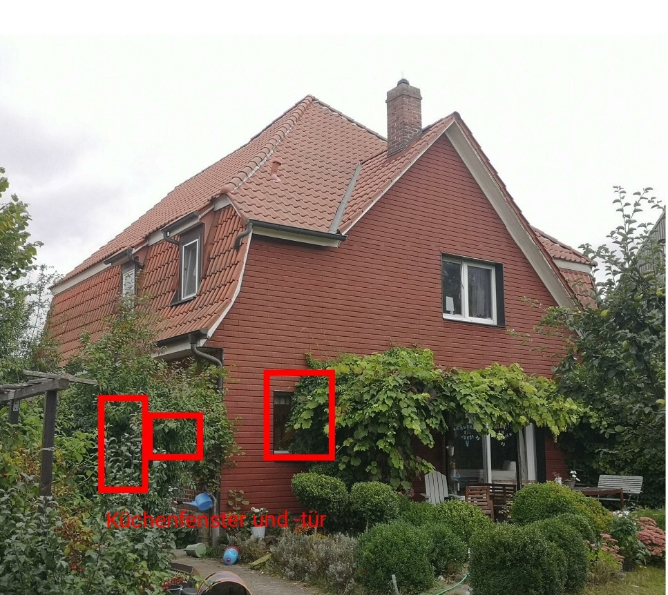

Our current kitchen
- has very little countertop space
- also serves as a dressing area
- contains the door we use most often (we rarely use the main front door since our cars are parked closer to the kitchen)
- has a beautiful window facing our neighbors’ terrace, so they can look into our home and we can admire the summer display of physical gracefulness

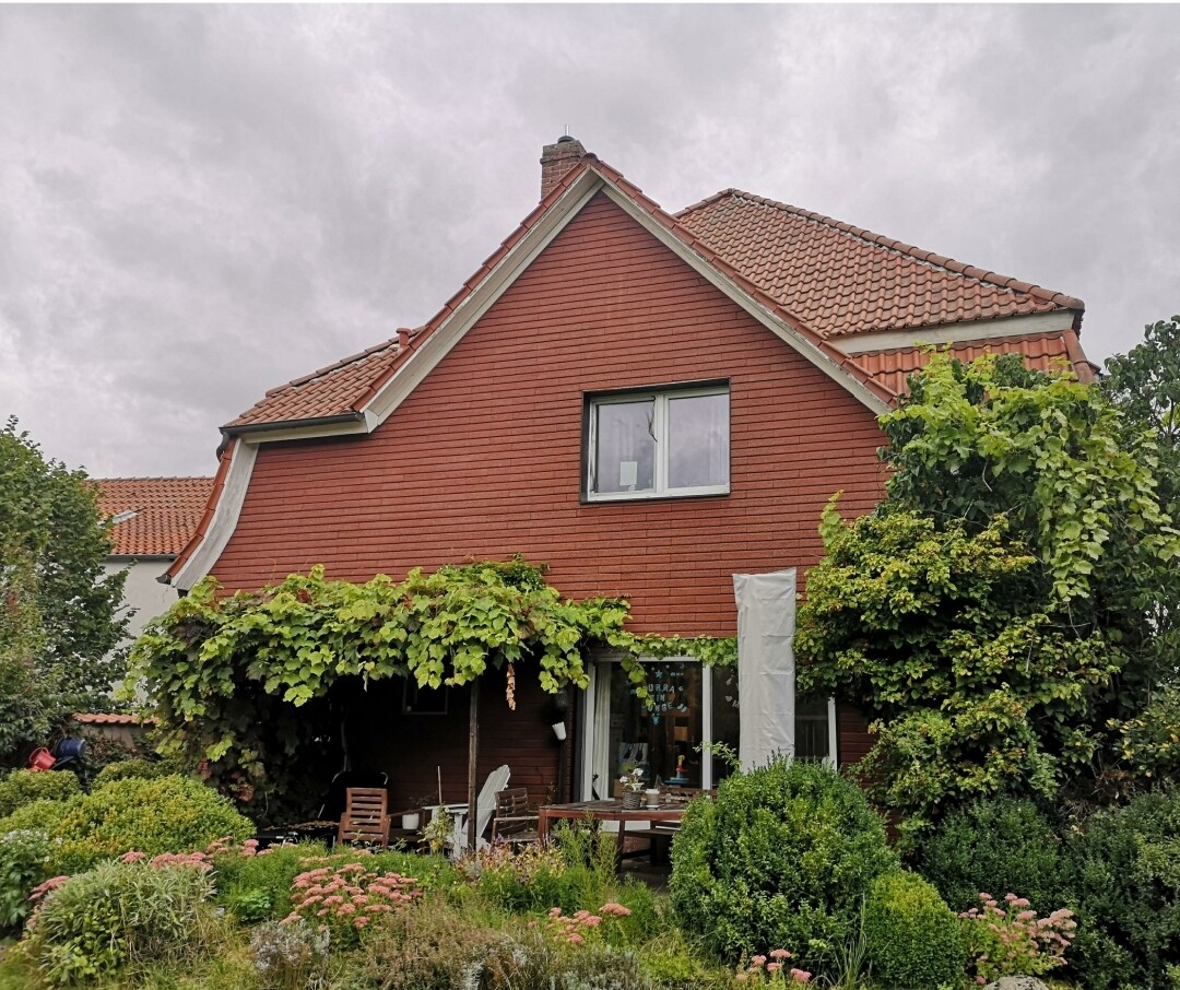

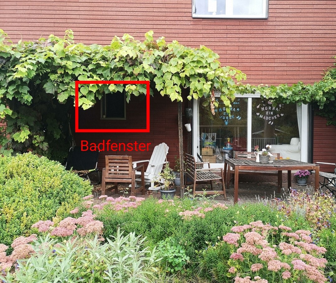

With this option, we would need to move some doors, but after entering the house, you would no longer have to walk through the entire kitchen.
The new door on the right side would then open onto our terrace, which we find very appealing (yes, currently the bathroom air vents out onto the terrace…).

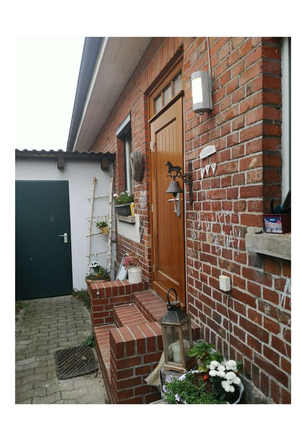

The guests enter from the other side because the street side is on the left side of the plan, so they approach the front door from there.
Our cars are parked in the driveway, which is accessible via a separate side path. This driveway is located at the lower right side of the plan, so it is much closer to the kitchen door than to the main entrance.
