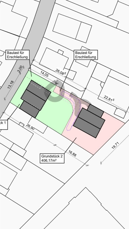

We have purchased a backland plot in the city and would like to start building on it now.
Our problem is the 3-meter (10 feet) wide and 25-meter (82 feet) long driveway.
As can be seen in the picture, a swept path curve has already been drawn to the lower area, so that we can reach the 90-degree, also 3-meter (10 feet) wide driveway in front of the house.
However, we don’t want to have to back out of this long driveway forever and definitely want an option to turn around both from the garage at the top and from the parking space in front of the house below.
Since the plot is already small and we want to keep as much garden space as possible, we are reluctant to move the house further east.
Are there also reverse swept path curves that show the driving route?
How much space do we need? Is the swept path already drawn sufficient to turn around with a single maneuver?
Personally, I see the problem more from the garage at the top than from the parking space. Do you agree?
We need to split the front part of the plot soon, and therefore we have to determine exactly how much space we require.
Our car is an Opel Astra (approximately 4.4 meters (14.4 feet) long).
Or do you think a diagonal line would even be more practical?
Thank you all in advance for any help and feedback.

Bauen189925 Sep 2023 08:37Hi everyone,
Attached is an overview of the site plan zoomed out a bit more...
I think I have found a solution. We will simply drive into the driveway, then turn around in the curve and reverse into the garage. This shouldn’t be a problem, but of course, I will test it again.
Yes, the site plan is oriented to true north.
The idea of moving the house further to the right (east) was also very interesting, and we have discussed it. However, the house shown will be parked in the designated garage, and another vehicle will be parked in front of the house. We also want to have our small terrace facing southwest and ideally just garden space for playing on the east side.
The suggestion to move the house would almost completely eliminate garden space for playing. It might be an optical illusion in the drawing, but from the south-facing house wall to the end of the property at the bottom, it’s only about 6 meters (20 feet). If you then add a terrace over 3 meters (10 feet) deep, that’s pretty much it.

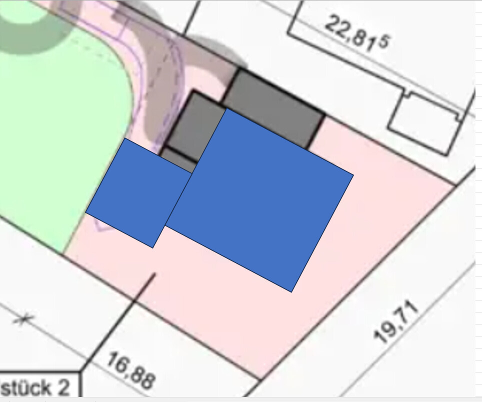

Bauen189925 Sep 2023 09:02One more addition:
If we really plan to back our Opel Astra into the garage, how wide do you think the garage opening should be to comfortably reverse in? (Opel Astra - 1.85 meters (6.1 feet) wide) The house would then need to be shifted slightly to the south, which would reduce the patio area, but constantly being annoyed by a small garage wouldn’t be ideal either.
Bauen1899 schrieb:
How large should the garage opening be to comfortably reverse in (Opel Astra – 1.85 meters (6.1 feet) wide)? You might not even know your future cars yet,
so go for a garage with standard dimensions of 3 x 6 meters (10 x 20 feet), with a standard door.
The right-angled exit onto the 6-meter (20 feet) wide street isn’t easy either if a car is parked opposite.
