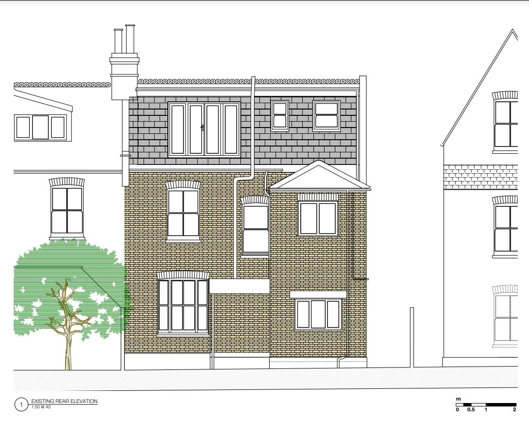

This is then what the architect develops, the rear side this time, showing both the existing structure and the extension/renovation. The entire building permit/planning application is available online for public viewing, often going back at least 50 years with most authorities. As a neighbor, even a distant one, you have the opportunity to “object” or express concerns.
I should also mention that in this case the application was submitted by a German architect based in London, and my daughter is very meticulous and knowledgeable about what needs to be submitted to the authority to avoid having to file multiple revised applications, which cost both money and time each time. Some people don’t understand this and think they can get by with minimal effort.
