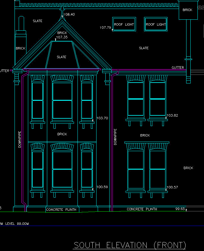

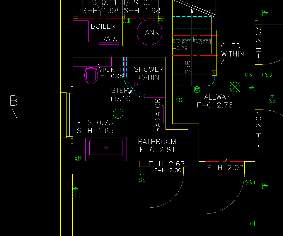

If original plans of our house existed, I would gladly share them. Unfortunately, in our region, all buildings constructed before World War I have no plans available. I’m not sure what this is called in Germany, but my daughter in the UK always has her old houses measured, both inside and out. She then receives precise plans in DWG format, accurate to the millimeter, which can be measured and edited using a DWG viewer. These serve as the basis for the architect when planning renovations. The last house was 120 years old, the current one 100. Of course, this service costs money. Without these plans, proper planning is not possible.
Excerpt
I looked it up, this is called a "Measured Building Survey."
evelinoz schrieb:
I don’t know what this is called in Germany, but my daughter in the UK always has her period properties professionally measured, both inside and out. She then receives highly accurate plans in DWG format that can be measured and edited using a DWG viewer.Measurements without including materials are only "half the job," but they still help a lot. Who offers this kind of service there, and do they really just walk through the house with something like an R2D2?https://www.instagram.com/11antgmxde/
