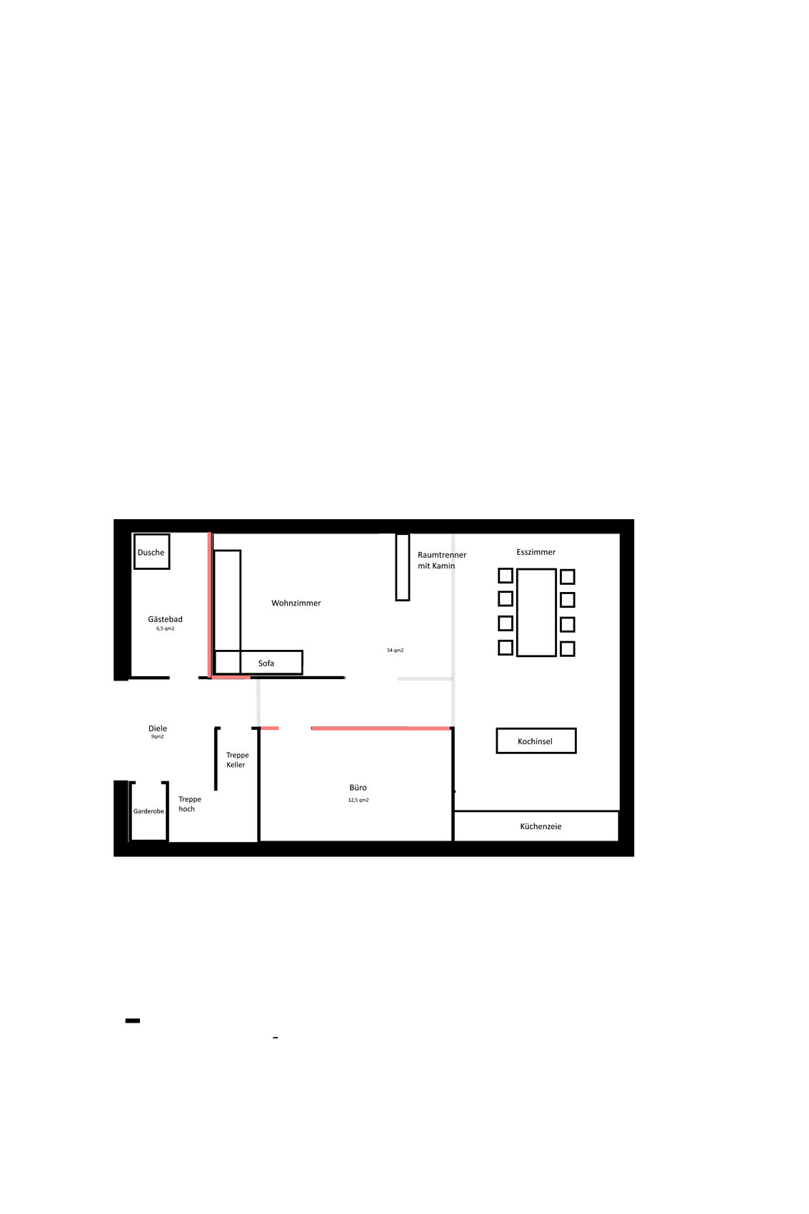

The extension is planned to be on the right side of the house. Size 4 x 8.5 m (13 x 28 feet). In the floor plan, it is basically the right part where the dining room and kitchen are located.
Light gray marks the existing walls that would need to be removed.
Light red marks the walls that would need to be newly built.

The light gray walls are the current walls that would need to be removed.From the picture, adding the extension there makes sense and essentially creates a new house, but removing the old load-bearing wall on the right seems questionable to me. I would prefer a wider opening instead.Nida35a schrieb:
but I consider removing the old load-bearing wall on the right questionableI would go as far as calling it "extremely uneconomical," but I believe in the good in people ;-) and therefore consider it a misimpression caused by poor drawing skills.https://www.instagram.com/11antgmxde/
