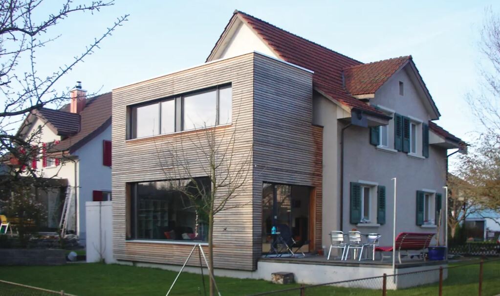

If you’re emotionally attached to the house (which I can understand), I would strongly advise against the murder conspiracy mentioned in Post #1. Would there be any objection to making the extension visually distinct? I find the following example a bit rough, but it can surely be done in a more elegant way.
Modern two-story house with wooden cladding, terrace, and garden.
Possibly combined with the dormer window with tie rods by @11ant, or alternatively, the dormer could be designed as a projecting cube:
Modern house with dark brick facade and light-colored extension, exterior view.
The most important question, however, is: what are you actually allowed to do, and is there even enough space on the property? (It looks quite tight in the second picture.)
