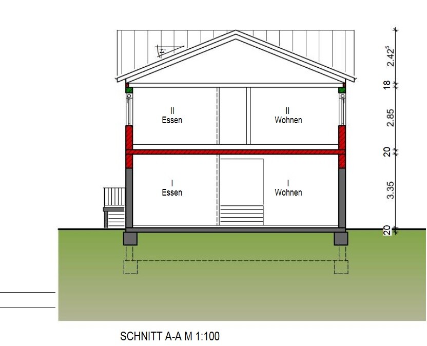

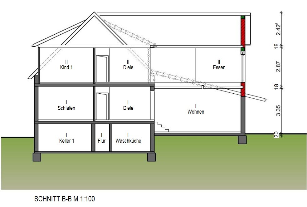

Attached you’ll find a draft created by the architect. The changes to be made are marked in red. The extension is on the upper floor, identical to the already existing extension on the ground floor (where the building is being raised accordingly).
What is still missing there is that the wall in the original building between the hallway and child’s room 2 is to be shifted about 1.5m (5 feet) to the right according to the plan, so that child’s room 2 becomes larger. I hope you understand what I mean. All doors remain as they are, only the hallway passage from the original building to the new extension will be narrower.
We were actually quite satisfied with the plan. Cost estimate: €150,000

Now it seems that we want a third child. Then there will be no space for another child’s bedroom again. I simply can’t imagine this with the existing plan. If at all, it would have to be the living room area that is already partly separated by the partition wall, although this would make the living room feel very narrow, which we don’t like even in theory.
On the ground floor, an (unapproved) conservatory has been built on the upper side of the plan, measuring about 10 by 2.5m (33 by 8 feet).
My idea is to give this a foundation and erect supporting pillars, so that the upper floor would have a gross floor area of 10 by 9.5m (33 by 31 feet) instead of 10 by 7m (33 by 23 feet). Structurally this should be fine. Then the separated living room area could indeed be used as a master bedroom, leaving a 6 by 5m (20 by 16 feet) living room. The kitchen would also be about 5 by 2.5m (16 by 8 feet) bigger, which could create a pantry or something similar, or a covered balcony by the kitchen (I would really like that for an outdoor fryer => no odors in the open kitchen,...).
The existing conservatory could remain as is; glass elements would just need to be installed between the new supporting pillars.
Cost estimate: With an additional 20m² (215 sq ft) of living space, I would estimate the project would then cost about €200,000 instead of the planned €150,000.

Can you see the pictures at all? I think I only added them but didn’t embed them properly – so I’ll do that now:

Currently, Child 2’s room is the only dedicated children's bedroom, and Child 1’s room is being used as the living room. The master bedroom is as shown in the plan, although we would probably swap them later so that the two front rooms become the children’s bedrooms, since they are the same size, etc.
I have also considered placing the new bathroom where Child 2’s room is now. The wall could then be moved slightly upward according to the plan, creating a roughly 18m² (193 sq ft) third bedroom – or if that doesn’t work out, it could be used as an office, TV room, or something similar.
However, as mentioned, if we need to add an extra room in the planned extension, I see only one option: extending the addition beyond the current building line upwards to include the conservatory – that is, extending the addition by about 2.5 to 3 meters (8 to 10 feet) upward across the entire width.
