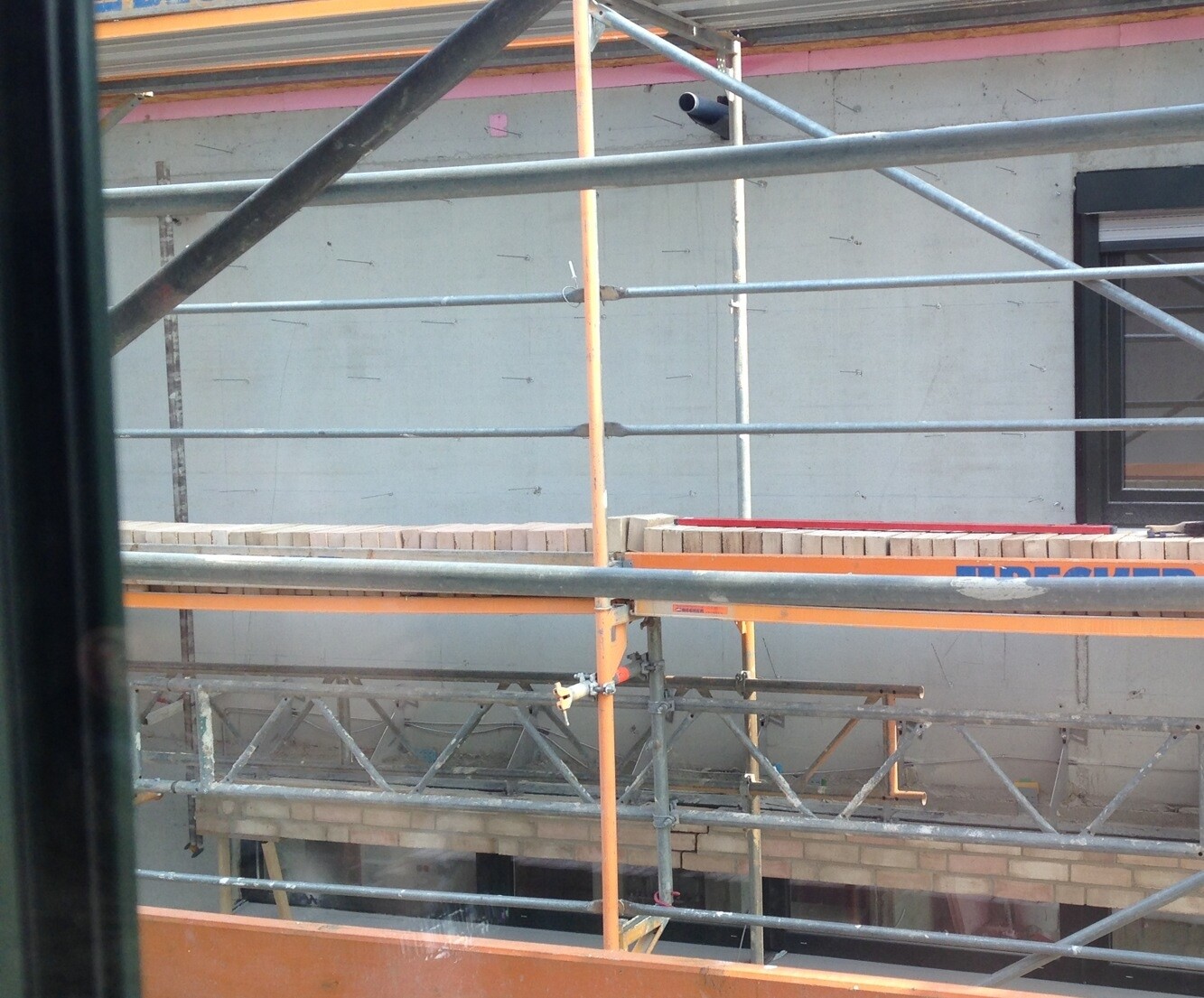

italiano8327 Apr 2014 21:58So, we are currently building as well.
For us, the facing bricks will be installed over insulation (I think 12cm (5 inches) insulation).
Beforehand, spikes will be attached to the walls to ensure the insulation adheres properly.
It will not be glued. The bricks will be applied, among other methods, onto a supporting structure.
So, it’s not that simple.
Our walls are precast concrete, 25cm (10 inches) thick.
How many square meters of facing bricks are you planning to install?
Just glued on?
Just glued on?
