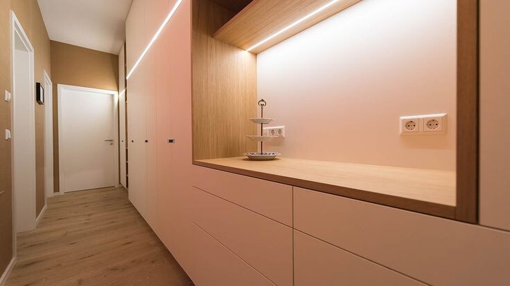

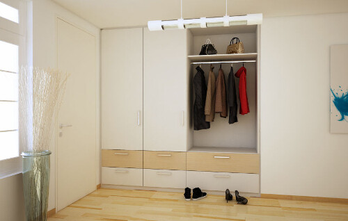

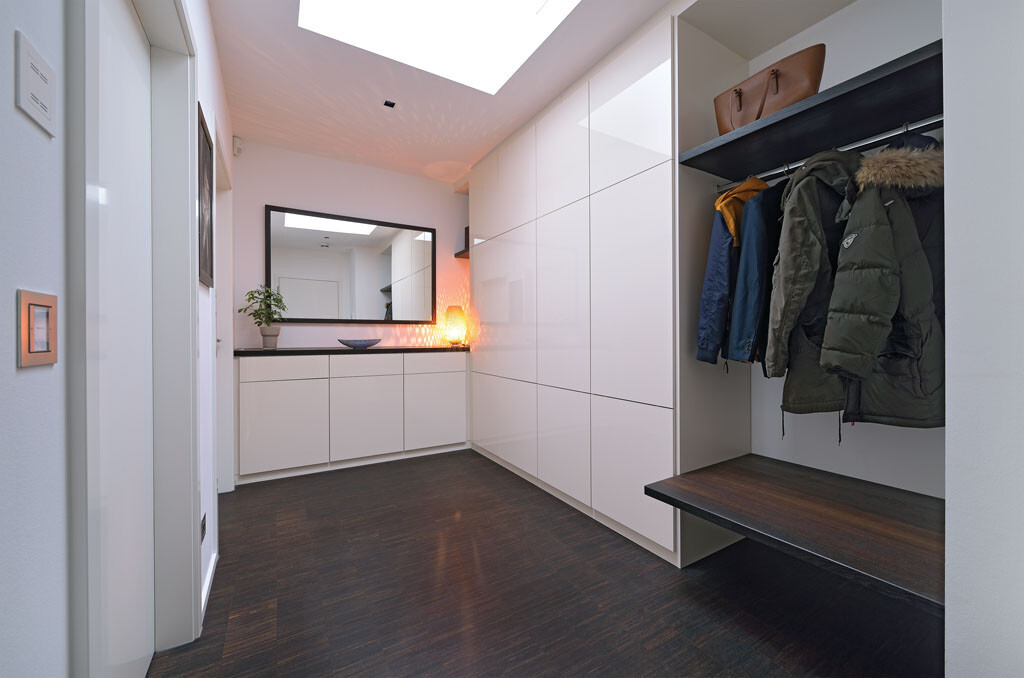

Alessandro29 Jul 2020 08:00Yes. Just not all elements fully enclosed. It can also be designed to appear more open and airy.
For example:
Or like this:
Or here with an integrated bench:
You can either leave your doorway completely open or install wall cabinets above the door up to the ceiling to further avoid the appearance of a closet. Then it’s simply a passageway. The storage space up there is typically used for off-season clothes or other items you rarely need to access, or things you want to keep out of children’s reach—or to make it difficult for yourself to reach (self-discipline). Light bulbs, vacuum cleaner bags, snacks, tobacco, 50-year-old single malt, leather whip...

Yes, the pictures look nice. However, we would prefer to keep everything behind closed doors and not have jackets hanging out in the open. The niche in the first picture is really cool, but unfortunately, we can’t fit such a large continuous wardrobe in our space.

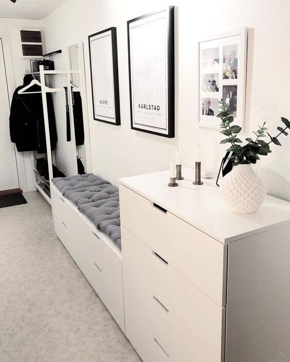

I was thinking of initially planning a lower cabinet on the right side only, which can also be full height if needed. That would be almost like two large Pax wardrobes, enough to accommodate all the jackets currently in use. Inside the lower cabinet, I would include inner drawers for accessories. In the top right corner, I would start with just a coat rack where guests can hang their jackets, for example. If the lower cabinet eventually isn’t enough, we could add an upper one later.
On the left side, a 1m (3.3 ft) wide cabinet about 1m to 1.2m (3.3 to 4 ft) high. It should fit at least as many shoes as our current shoe cabinet, or probably even more. On top of this cabinet, a shallow drawer for keys and small items. The top surface can be used as a place to set things down when entering. Right next to it, 1m (3.3 ft) lower cabinets that double as a bench with storage underneath for shoes. Basically like this:
Alessandro29 Jul 2020 16:28A properly positioned mirror makes a big difference, as seen in the top picture. I would include that as well.
