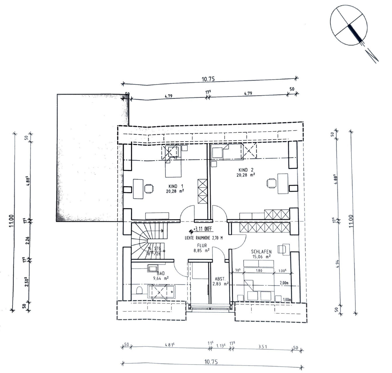

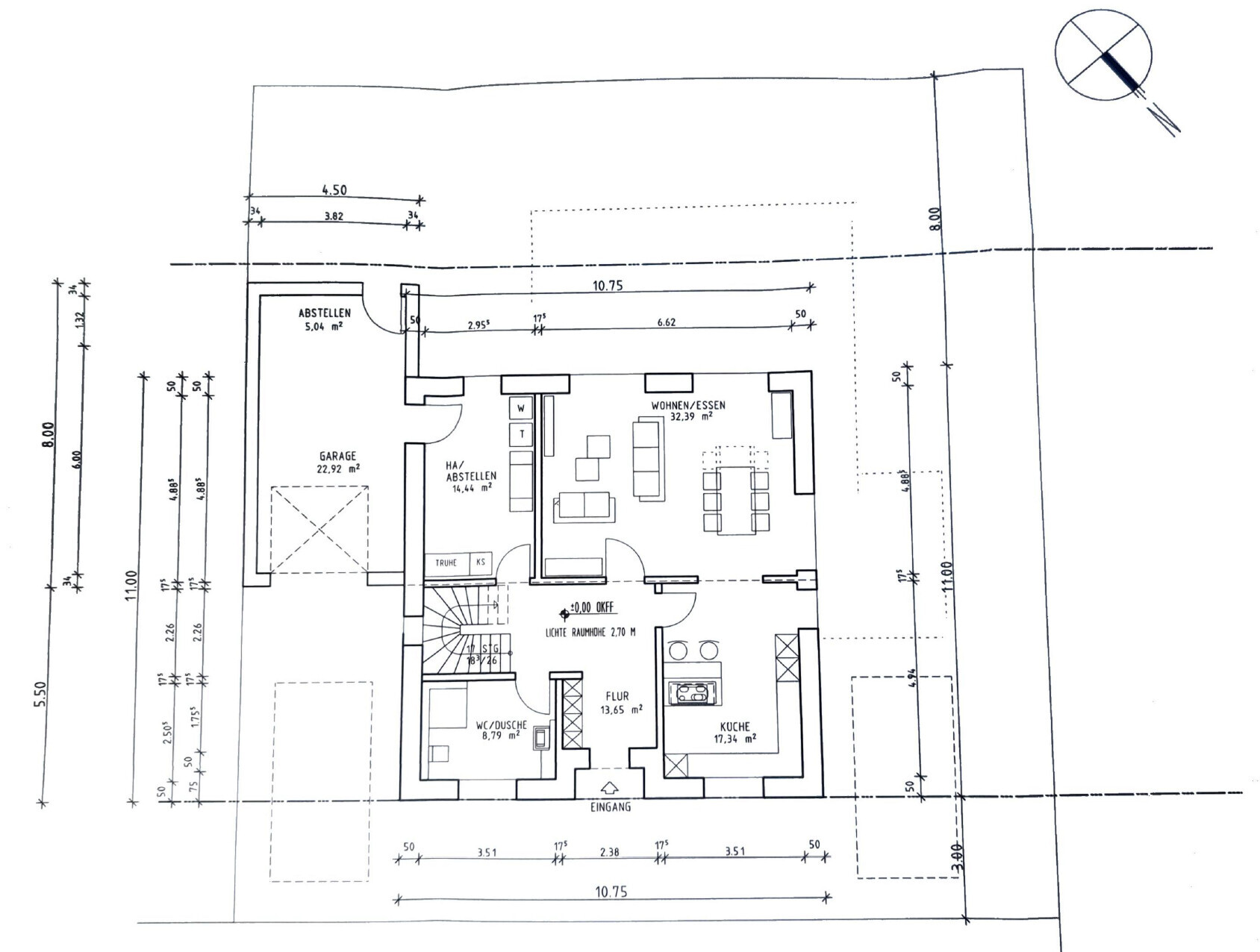

In the meantime, we have gone through a second round with our architect. He sketched a new floor plan, which in our view still has some major issues. We would like to hear your opinions to see how we can steer the design planning in the right direction.
Second Draft
Alternatives
We would appreciate any additional ideas or suggestions you might have.
-Malte-
Second Draft
- Key adjustments
- Inclusion of the attic for office use
- Omission of projecting dormers/bay windows
- Stairway entrance not in the mudroom area
- Orientation of living rooms towards southwest
- Issues we see
- Too large footprint (total living area approximately 186m² (2000 sq ft) including attic living space)
- Ground floor basically okay, though the large bathroom is not necessary
- Upper floor doesn’t work: children’s rooms are significantly too large, bathroom is long and narrow due to stair placement under the sloped roof, dormers not practical
- We doubt that the problems on the upper floor can be solved by just rearranging rooms. The house would actually need to be smaller in its exterior dimensions, but this would further worsen the upper floor issues caused by the stair location (especially the narrow bathroom).
- It is good that the existing attic is being utilized – but this does not lead to a reduction in the house’s external dimensions.
Alternatives

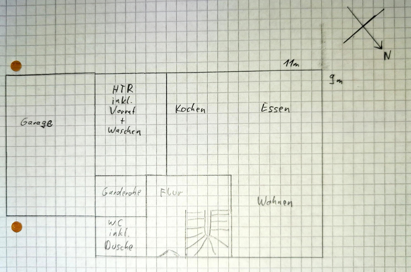

- Therefore, we are considering alternatives that could be sensible and bring the design closer to our preferences.
- In general, we believe we would be happy with a standard floor plan similar to Rensch-Haus models "Lichthaus 152", "Rensch-Haus Life 159", or "Rensch-Haus Clou 159".
- Rectangular footprint of about 11m by 9m (36 by 30 feet)
- One full story (requirement of the development plan), steep roof pitch (~45°) to allow a knee wall of around 1m (3 ft)
- Double-wound staircase centered on the eaves side with some distance from the main entrance
- Ground floor: living/dining/kitchen arranged around a corner, large utility/technical room, cloakroom and small shower bathroom
- Upper floor: 2 children’s rooms, 1 master bedroom, office, bathroom
- Attic: purely storage space accessible via pull-down ladder
- We have roughly sketched two versions with different entrance locations (one from the side, one from the front) as we imagine them.
-Malte-
Is this supposed to be a joke? Did I miss something? The architect isn’t delivering anything.
... and what do you call what he keeps tracing over?
In this design, I see at least 50cm (20 inches) less on the sides as well as... wait... about 100cm (39 inches) in depth that could be saved without significant loss of usefulness and function. Excluding the attic roof.
However, I also immediately notice the mistake that the house is planned quite deep and, with the (always centered?) entrance, everything feels very spacious. The side entrance is better.
Every general contractor offers a house like this. For a fraction of the planning costs, because it’s standardized.

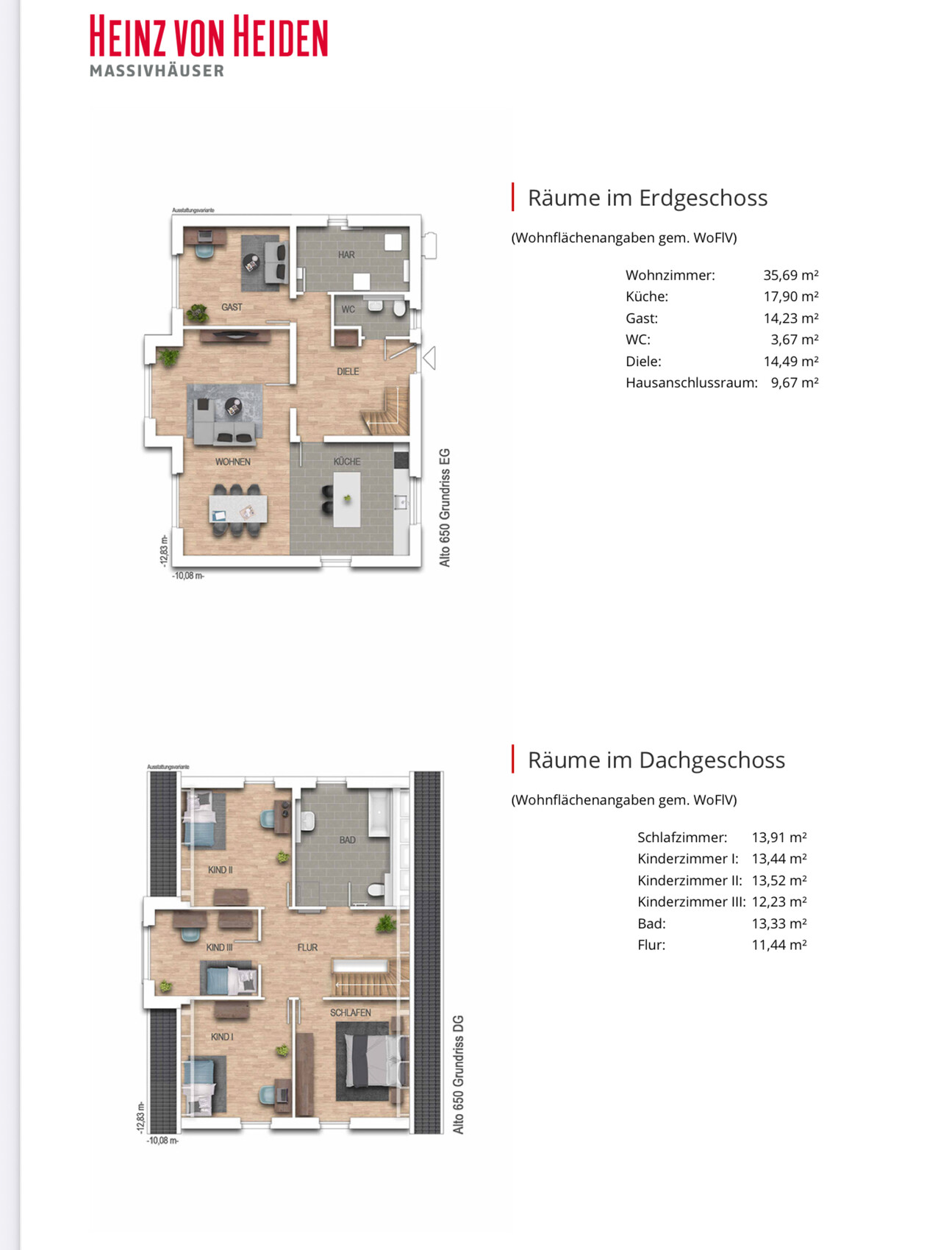

We are quite disappointed with the proposal we just received from the architect. Our assessment was also that the design, as it stands, is simply professionally inadequate and doesn’t make sense. This has now been confirmed here as well. Yes, we mentioned in a conversation that it might be worth considering including the attic as an office. However, we clearly pointed out that this should only be done if it actually makes sense, which is difficult for us to judge as laypeople. It now seems like there is an attempt to connect the attic at all costs. As an architect, I would have said, “No, it probably doesn’t make sense,” or in this form would not have even put the floor plan design up for discussion but rather rejected it and looked for other solutions.
We will review standard floor plans thoroughly again over the weekend. We also believe that there is no need to reinvent the wheel for our requirements. A one-and-a-half-story house for a family of four plus an office is quite common. You linked two examples again.
Our wishes and requirements have somewhat crystallized to include not wanting the staircase entrance in a dirty area and also not wanting a long, narrow “tube” layout for living/dining/kitchen. This does limit the options somewhat since the staircase entrance is located at the front door in about three-quarters of all floor plans, at least it feels that way. The floor plan by Tolentino, for example, is actually quite suitable—also because living/dining/kitchen would all face the south garden—but it is a large open space that does not separate the areas. Probably a living/dining/kitchen area arranged at a corner like in the previously linked Alto 650 is better for us.
Every general contractor offers this type of standard house. For a fraction of the planning costs because it is standardized.
