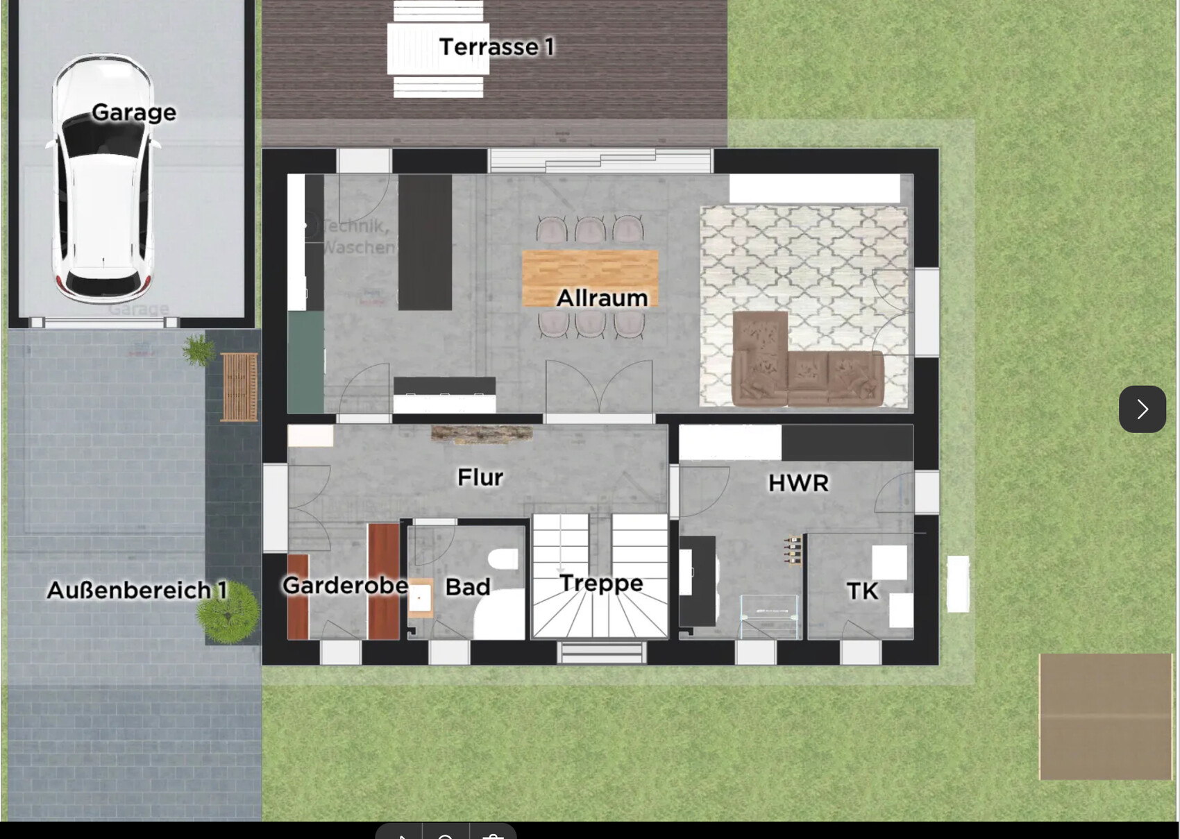

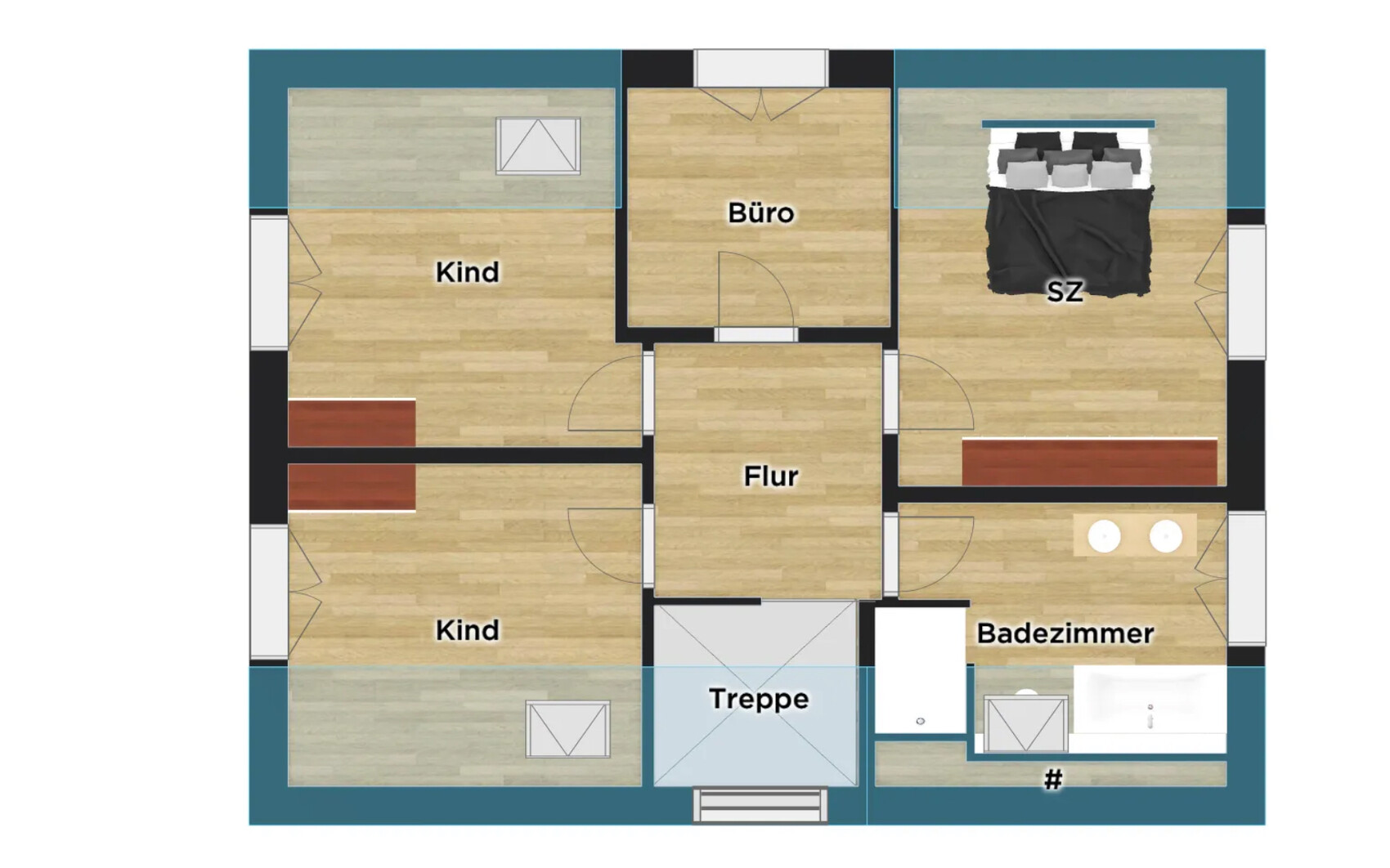

Here is my alternative. I have changed the wardrobe.
The dormer above is centered, so the projections and recesses of the walls must be as shown. The windows on both floors are also arranged in almost symmetrical alignment.
The kitchen island is 2.40 meters (7 ft 10 in) long, and the kitchen door is just an example, etc.

Dear @ypg, thank you very much for the further development and additional suggestions! It’s great to see how much effort you put into this and how well you support us. We really like the design.

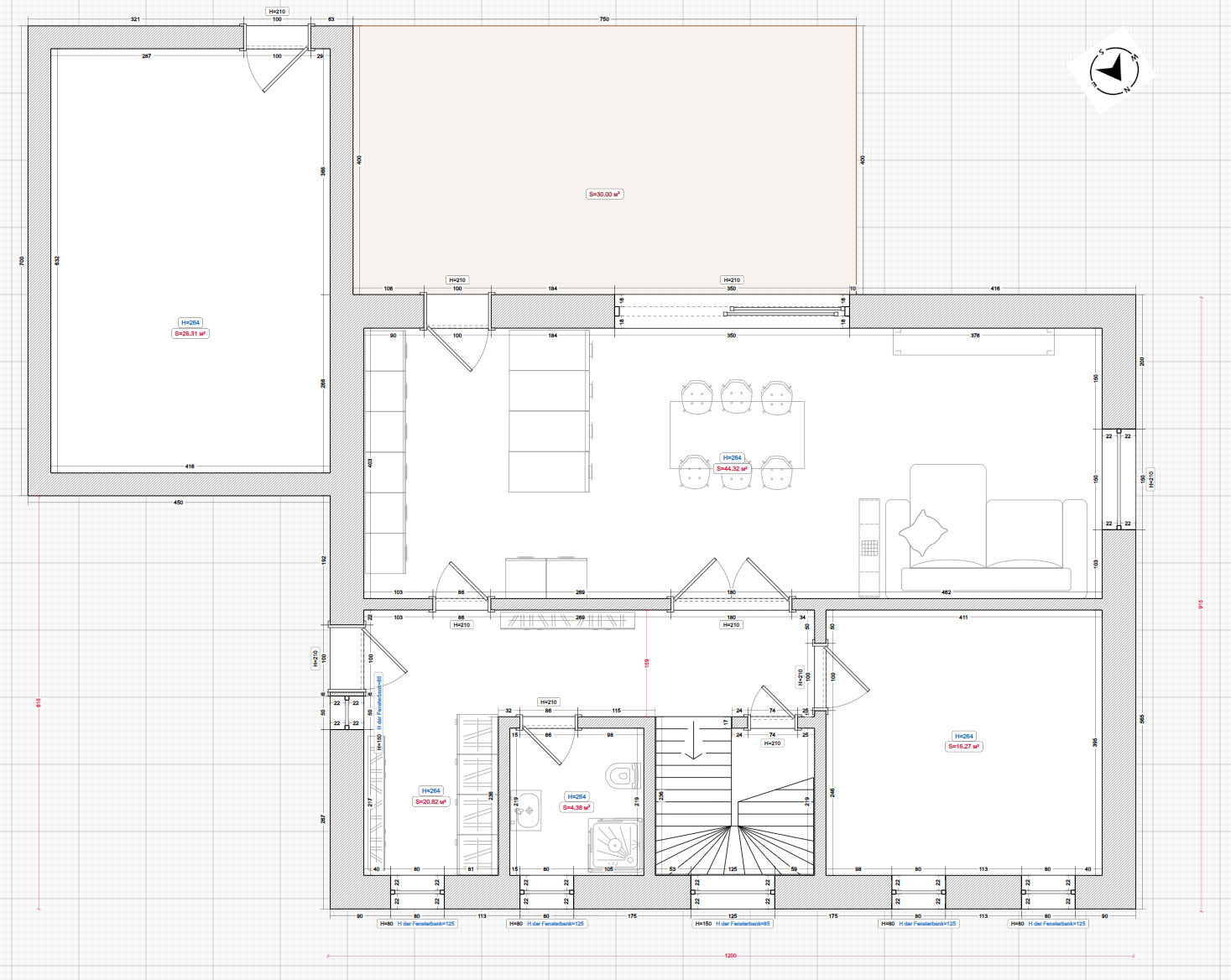

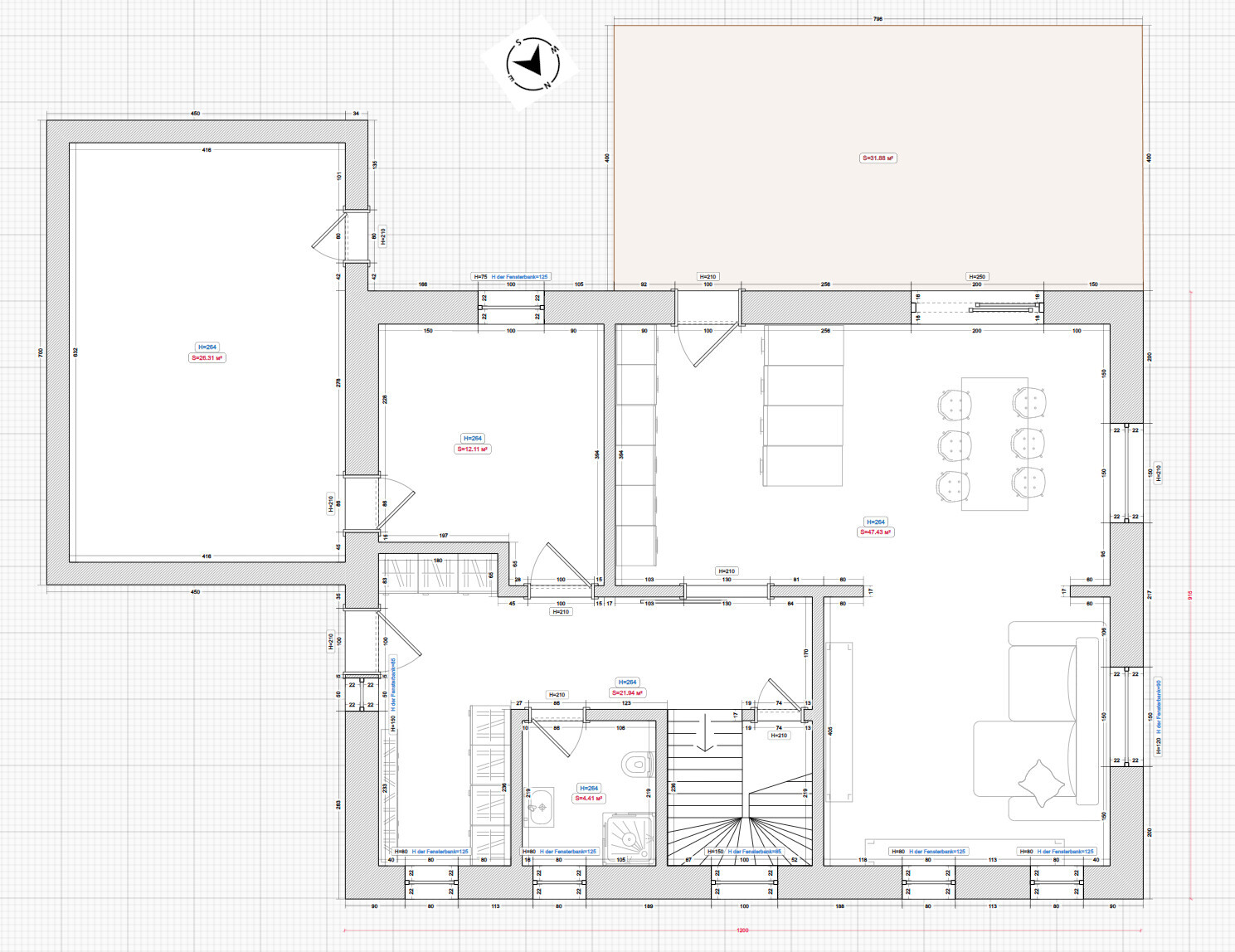

we are currently using the quiet season to further consider the proposed floor plan. We are happy with the current rough draft but are still thinking about the layout of the open-plan living area.
The latest design by @ypg shows the open-plan area as a linear sequence of living/dining/kitchen. This layout was originally not what we wanted, but now we can imagine it. Nevertheless, we are also considering a corner arrangement where the utility/housekeeping room is placed in the opposite corner of the house, and the living area is somewhat separated around the corner toward the front side of the building. Both versions are roughly sketched out here:
“Linear arrangement” of living/dining/kitchen:

“Corner arrangement” of living/dining/kitchen:
Floor plan of a house with living room, kitchen, and dining area
The main differences we see between the “linear arrangement” and the “corner arrangement” are:
  • Different living atmosphere
    • One version is an open-plan area in a row without strong visual separation of the zones; the other arranges the space around a corner, slightly separating the living area.
  • Orientation of the living area
    • In the linear layout, all living spaces face the south garden, while in the corner layout, some face the south garden and others the west garden.
  • Terrace placement
    • In the linear layout, the terrace is placed more to the east, directly adjacent to the garage. In the corner layout, the terrace would be located at the house’s southwest corner and would not be enclosed by the garage.
  • Size of the open-plan area
    • With the corner layout, the open-plan area can be slightly larger (probably about 4m² (43 sq ft)) by reducing the utility/housekeeping room slightly (approximately 12m² (129 sq ft) vs. 16m² (172 sq ft)).
  • Kitchen storage space
    • The linear layout likely offers more storage space, as two additional tall cabinets can be placed against the central wall.
  • Entrance to the open-plan area
    • In the linear layout, the entrance is centered in the dining area, while in the corner layout, the entrance leads into the kitchen.
  • Windows in the open-plan area
    • The linear layout features one large central window in the dining area, while the corner layout tends to have several smaller windows.
  • Placement of utility/housekeeping room
    • In the linear layout, it is located on the street side (advantages: easier utility connections; if using an air-to-water heat pump, the outdoor unit can be placed at the front; the bathroom upstairs is located above the utility room on the ground floor)
    • In the corner layout, the utility room faces the south garden (advantages: possible door to the garage; easier access to the garden for drying laundry; possible disadvantage is that the upstairs bathroom would have to drain via the downstairs WC)
Ultimately, we keep coming back to the fact that it is probably a purely personal decision based on the living atmosphere. Numerous discussions with family and friends have not helped much either.
Therefore, we would like to ask for your impressions. Do you see clear pros or cons for one of the options, and which would be your preference?
Malte

-Malte- schrieb:
Ultimately, we keep coming back to the fact that it is probably purely a personal decision regarding the feeling of living.
You’re right. It needs to feel right as a whole. Maybe you know some things from the past or other houses – there is no absolute right or wrong when it comes to such a layout. Condition: the latest explanation about the utility/technical room location in this thread is the main guiding factor for me. Once that is more or less fixed, I rely on intuition based on how I assess the homeowners.
Here are my intentions:
  • For terraced houses, all living rooms face the south-facing garden, while for corner houses some face the south garden and others face the west-facing garden.
Variant I also has a window facing west, just none facing north towards the street.
-Malte- schrieb:
Placement of the terrace
  • For terraced houses, the terrace is located farther east, directly next to the garage. For corner houses, the terrace would be placed at the southwest corner of the house and would not be "enclosed" by the garage.
A corner terrace is often seen as cozier, especially since the wind usually comes from the west. A terrace roof or canopy can also be installed more easily there.
  • For corner houses, the open-plan area can be made slightly larger (probably about 4m² (43 sq ft)) by making the utility/technical room slightly smaller (about 12m² (130 sq ft) instead of 16m² (172 sq ft)).
Your strongest desire (and big concern 😉) was to have enough storage space in the freezer/utility room.
  • For terraced houses, probably more storage space, since two more tall cabinets can be placed against the interior wall.
Yep. Personally, I might even skip the kitchen door and mark it as “just for you”. You could install a whole wall of cabinets there.
  • For terraced houses, entrance is centrally into the dining area, whereas for corner houses, entrance leads into the kitchen.
I always prefer a large passage door or opening at dining room height if possible. A loft door or even no door, practically open to the stairs. For me, the dining area is the meeting point for all occupants. The kitchen entrance could be an issue with small children during parties, surprises, or birthdays. Also, if you’re not the tidiest person in the kitchen, you can simply avoid the kitchen and guide guests around it instead of through it.
  • For terraced houses, a large central window in the dining area; for corner houses, generally several smaller windows.
Yep, the large open view towards the garden is usually preferred. I’ll take a look at how you have it drawn. I’d say: whether the patio door is 2, 3, or 4 meters wide (about 6½, 9¾, or 13 feet) it’s always better than narrow “shooting slit” windows, unless you add those additionally. As you like. With me, you almost always have the garden in sight.
-Malte- schrieb:
Placement of the utility/technical room
  • For terraced houses, it’s located on the street side (advantages: easier house connections; if using an air-to-water heat pump, the external unit can be placed at the front of the house; bathroom upstairs above the utility room on the ground floor).
Where we are (Lower Saxony), it’s not allowed to build over any utility lines. That would only be possible with a carport. That’s why it is often located at the front. Also, you usually don’t want to waste south-facing space for storage.
-Malte- schrieb:
For corner houses, the utility/technical room faces the south garden (advantages: door to garage possible; easier access to the garden for drying laundry; disadvantage(?) upstairs bathroom would need to drain through the downstairs toilet).
The door through takes up storage space. You don’t really need it because a freezer room is not a corridor. It is perfectly located behind the entrance door, which is right next to the garage door. In our region, it’s frowned upon to dry laundry in the main garden. It is usually placed somewhere to the side where it is not directly visible. For an L-shaped layout, the bathroom would drain through the living room (which) would not be good. But you could mirror the upstairs layout.
The tendency on your side is towards the L-shape. I can provide you with some bird’s-eye views of the I variant again. Possibly also of the L.
