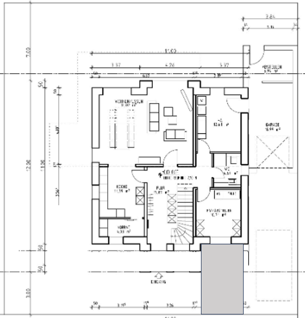

after some time spent on the selection of our plot in the new development area, we have now started the planning phase. We have found an architect, and a very first draft (without incorporating our feedback yet) has recently been presented to us. We would like to gather ideas and suggestions here.

- The design fully covers our room program/specifications; all necessary rooms and sufficient storage space are included.
- Preferences such as the arrangement of kitchen/dining/living “around the corner” and similarly sized children’s rooms are included.
- The design as a gable roof house with two small gable projections (dormers/gables) is visually very appealing to us.
What do you not like? Why?
- Overall, the floor plan—especially the upper floor—does not appear efficient to us. The hallway area is clearly too large. The total living area is about 179m² (ground floor 94m² and upper floor 85m²), but it does not feel like that. For cost reasons alone, we aim for around 160m².
- The house is currently designed as 11m by 11m (36 by 36 feet) square, but we feel it should be stretched somewhat (e.g., 12m by 10m or similar) to better separate the kitchen and master bedroom. Probably the square shape was chosen to make the roof easier to develop.
- We suspect the current draft does not reach one full storey height yet (North Rhine-Westphalia: 3/4 rule) — adjustments to knee wall height and roof pitch may be necessary.
- Details need adjustment (e.g., remove pantry in kitchen to enlarge kitchen; doors; possibly add more roof windows; etc.).

- Make the current design with the small dormers and room program on two floors more efficient and reduce it to about 160m². The attic would not be developed.
- Request an alternative design where the house is overall more compact and the attic is fully integrated (ground floor kitchen/dining/living, guest WC, utility room; first floor 2 children’s rooms, master bedroom, and bathroom; attic office and storage).

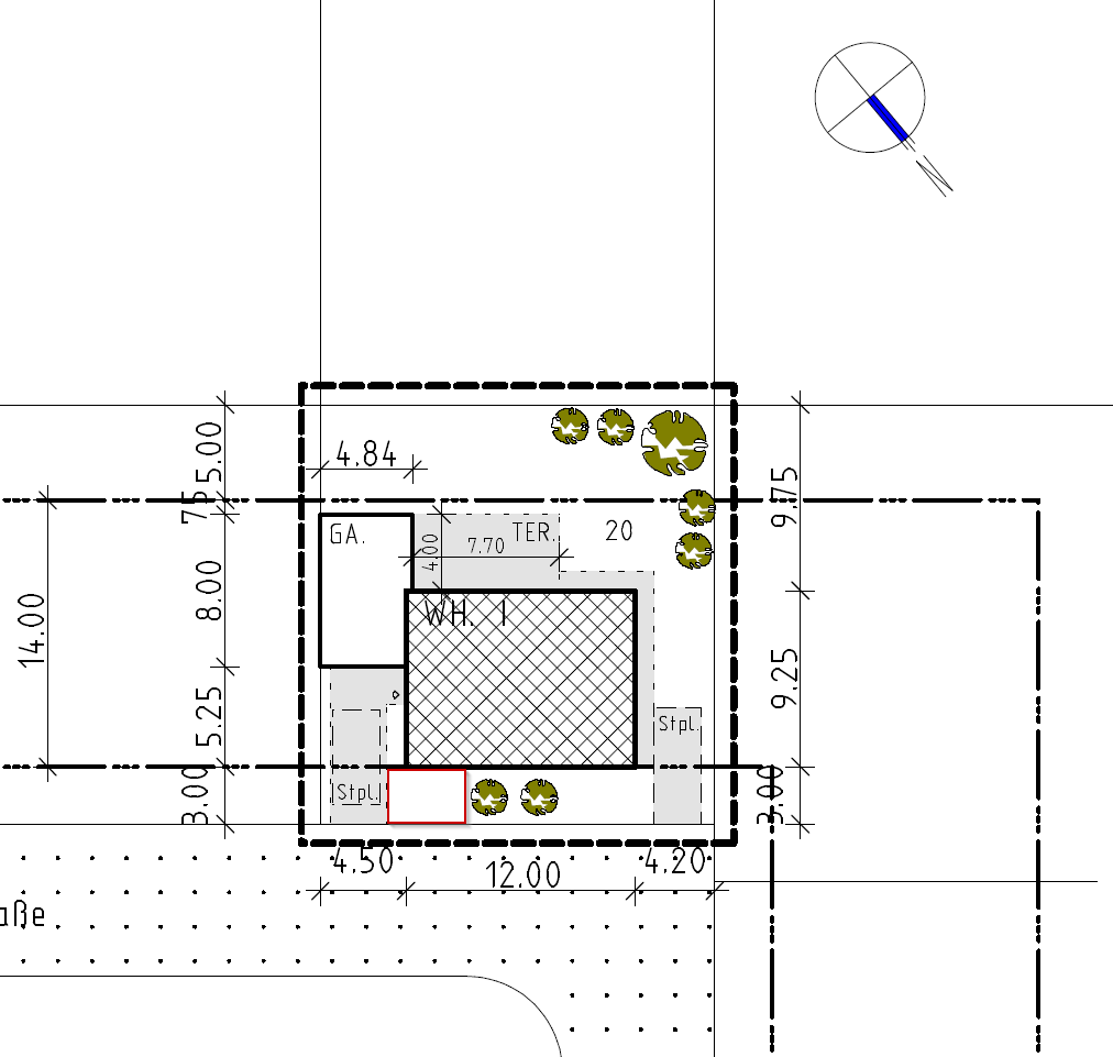

Thanks for pointing out "a different local ordinance" – I suspect that’s the key issue. I found out that the city of Bocholt has had a "parking space regulation" for two years, which covers all kinds of details about parking spaces. Under §7 (2), the following is stated:
From a layperson’s perspective, it's again not entirely clear to me ("if consolidation is not necessary from a traffic standpoint" – how exactly is that defined…), but I think this is what they are referring to. I’ll wait for the written response and follow up if necessary, or have our architect do so.
@11ant, we do have a local architect and we followed the usual recommendations (offers all service phases; recommended by acquaintances; good rapport in the initial meeting; down-to-earth and basically suited to the construction project). Still, the planning process so far has shown that this was a poor choice. That’s enough on this topic, which I don’t want to expand on here.
Malte
Access drives to properties and parking spaces must be consolidated. If consolidation is not necessary from a traffic standpoint – especially regarding the ease and safety of traffic – an exception can be made.
Malte
hanghaus20233 May 2026 10:31An architect who is not aware of or does not check zoning regulations in advance?
I don’t even want to imagine what else might have gone wrong there.

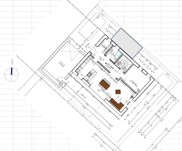

hanghaus20233 May 2026 10:46Building the house further back would of course be an option (by the way, the latest house plan is on page #9 – it is completely different from the plan on the first page), but it is not an option for us. With an already small plot of land (456m² (5,000 sq ft)), this would significantly reduce the size of the garden.
Currently, we are actually leaning towards placing the second parking space perpendicular in front of the house (marked in red on the site plan).
