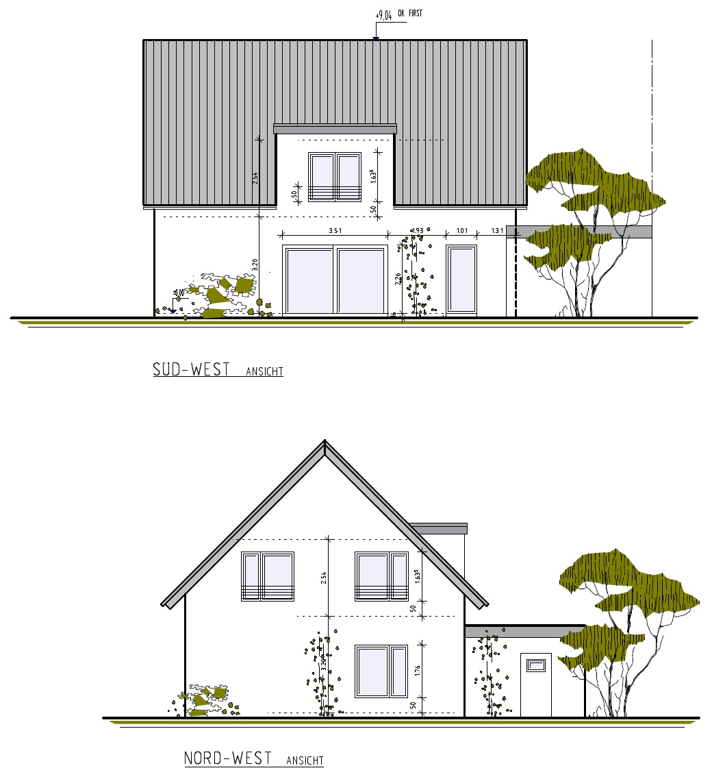

The design is based on our wishes/room program and generally meets them. The staircase could be extended up to the attic in the draft, but for this layout, a finished attic would not be needed for space or cost reasons. It would likely remain as an unfinished attic accessed by a folding ladder.

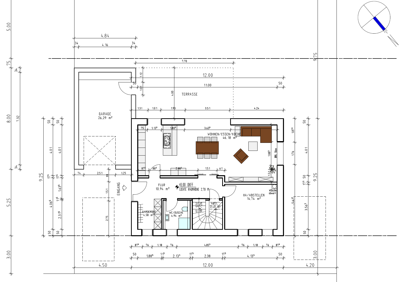

- The design fully covers our room program/specifications; all necessary rooms and sufficient storage space are included.
- Preferences such as the arrangement of kitchen/dining/living “around the corner” and similarly sized children’s rooms are included.

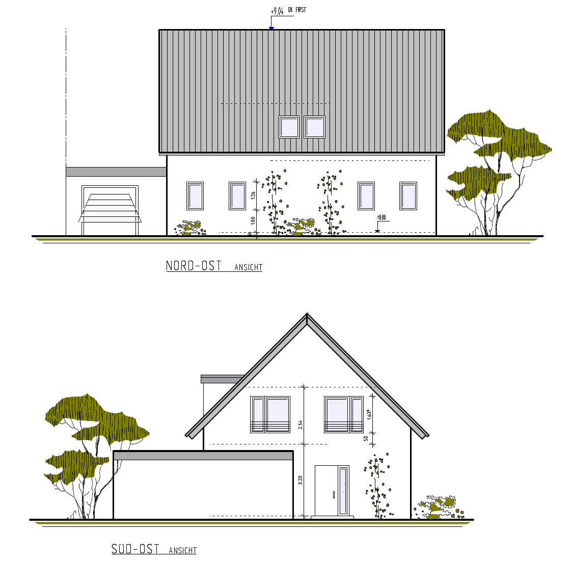

- The design as a gable roof house with two small gable projections (dormers/gables) is visually very appealing to us.
What do you not like? Why?

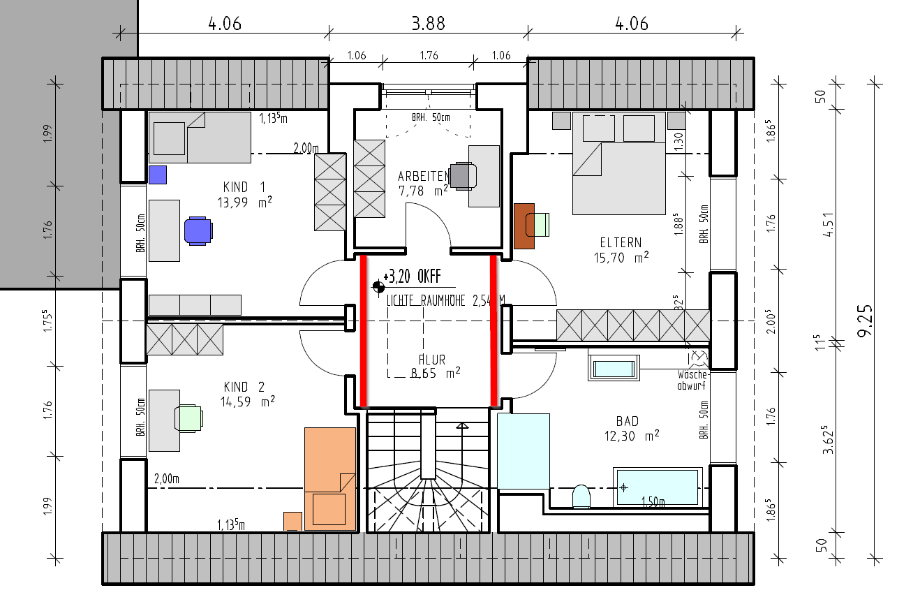

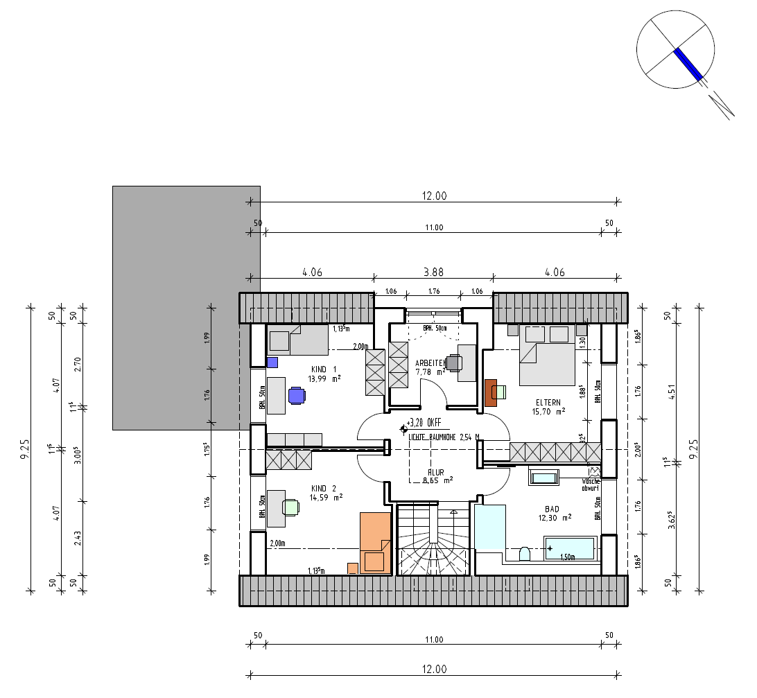

- Overall, the floor plan—especially the upper floor—does not appear efficient to us. The hallway area is clearly too large. The total living area is about 179m² (ground floor 94m² and upper floor 85m²), but it does not feel like that. For cost reasons alone, we aim for around 160m².
- The house is currently designed as 11m by 11m (36 by 36 feet) square, but we feel it should be stretched somewhat (e.g., 12m by 10m or similar) to better separate the kitchen and master bedroom. Probably the square shape was chosen to make the roof easier to develop.

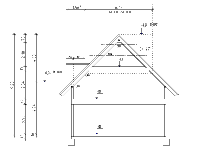

- We suspect the current draft does not reach one full storey height yet (North Rhine-Westphalia: 3/4 rule) — adjustments to knee wall height and roof pitch may be necessary.
- Details need adjustment (e.g., remove pantry in kitchen to enlarge kitchen; doors; possibly add more roof windows; etc.).

After some further consideration, we see two options:
- Make the current design with the small dormers and room program on two floors more efficient and reduce it to about 160m². The attic would not be developed.
- Request an alternative design where the house is overall more compact and the attic is fully integrated (ground floor kitchen/dining/living, guest WC, utility room; first floor 2 children’s rooms, master bedroom, and bathroom; attic office and storage).

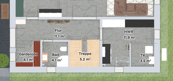

Thanks in advance for your feedback, and it’s good to hear that, as we have become somewhat “blind” to the project, we apparently haven’t missed any major mistakes.
Topic Stairs: I would really prefer a staircase with a landing instead of the half-turn stairs. However, from my point of view, this doesn’t fit the floor plan in terms of space (we would need at least about 80cm (32 inches) more stair depth).
Topic door HTR/utility room: We have also considered this, but it would take up even more wall space. Because of the two windows facing the street at the front, we already have a lot of wall area that is difficult to use effectively. At the same time, we believe we can’t do without the windows facing the street without making the house front look “odd,” since then windows would only remain left of the WC and cloakroom. Alternative suggestions are very welcome!
Thanks for the suggestion, ypg! Unfortunately, it doesn’t appeal to us regarding the wardrobe and also the exterior appearance. I think we will skip the door in the utility/housekeeping room and stick with the four small windows on the front facade.
Currently, I have a thought on my mind:
In the attic, there is currently a small offset planned between the outer walls of the stairs and the rooms (continuous wall concerning the office). In theory, the offset could probably be removed—I have roughly sketched a possible alternative wall layout in red. Child 2 would no longer have an annoying wall projection, but for Child 1, there would be a small projection on the right when entering. In the master bedroom, the door would definitely lead in front of a 3m (10 feet) wardrobe (otherwise, space is quite tight). At the same time, all rooms would gain a little extra floor area. The downside is that when exiting the bathroom, you would be quite close to the first stair step. We currently have that as well and don’t see it as too critical. Of course, the hallway would be a bit smaller, but that is just a passage area.
Are we missing something? Structurally, it shouldn’t really matter.
-Malte- schrieb:
Are we overlooking something? The light switch next to the staircase.
Whether an advance or setback. It is minimal and hardly noticeable in a negative way.
