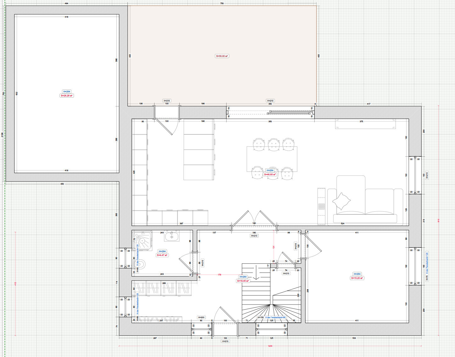

Since early December, our preference has been leaning toward the I-shape ("linear layout"). We see clear advantages in many areas, which you have now also highlighted in large parts (more attractive entrance to the open living area, increased kitchen workspace, simpler utility connections, "framed" terrace). The L-shape ("corner layout") has still been on our minds from time to time, mainly because we originally thought we didn’t want everything completely open in one large room without any separation. However, we now believe that we want to proceed in the direction of the I-shape ("linear layout"). In further detailed planning, we will look at how to visually and functionally distinguish the different areas in a subtle way.
However, a related question has come up that I held back in my post two days ago. Should we position the entrance at the side of the house or at the front? I have sketched both variants.
Entrance at the front (street side):
Floor plan of a house with living room, dining room, kitchen, hallway, and staircase.
Entrance at the side (driveway):
[ATTACH alt="2025-12-27 Reihenanordnung - Eingang Seite - bearbeitet.png"]94625[/ATTACH]
The general floor plan is surprisingly little affected by the entrance position. The open living area and the utility/technical room remain practically the same. The cloakroom and guest bathroom are arranged differently but keep almost the same shape and size. The hallway area probably does not differ significantly either, although we are uncertain about suitable passage widths for the different options.

Our thoughts on the side entrance:
- More direct/quick access from parking into the house
- Additional door from hallway to kitchen possible (convenient for bringing in groceries or quickly fetching something from the kitchen)
- Entrance/hallway less visible from the street
- Easier access from entrance to garage
- Roof covering for the entrance is unclear (e.g., a carport in front of the garage may not comply with the 9m (30 ft) setback building regulation)
We would appreciate any suggestions or ideas on this as well.

I believe both options are clearly visible and functionally quite similar.
Basically, I prefer an entrance on the gable side, and I’m less fond of the combination or "conflict" between driveway and main entrance, especially considering personal experiences with safety. In the plan and the image shared by @ypg, the layout seems too cramped for my taste, and I wouldn’t build it without a platform anyway. We have a similar setup (but on the gable side), and there are only two of us without children. The mentioned advantages mostly come down to the "better" connection between garage, kitchen, and groceries. However, this could also be achieved in the floor plan if you have a door on the side at the rear of the garage, allowing access to the kitchen via the terrace.
I simply like a nice and properly designed entrance area.
I often see the word “nicer” associated with the front entrance version, whereas it is rarely mentioned for the side entrance option; that alone is already important to me, especially considering the benefits mentioned for the interior layout.

2 Jan 2026 20:40
First of all, Happy New Year! 🙂
To understand better: Which safety aspect are you referring to exactly? Is it about the risk that children or people coming out of the house might come into conflict with cars entering the driveway? Honestly, I hadn’t considered that a potential hazard before, and currently, we have a similar side entrance without a step or anything like that. In our new development area, everyone drives slowly, especially when turning into the driveway.
From your two responses, I gather that this decision is probably just a matter of personal preference. 😉
