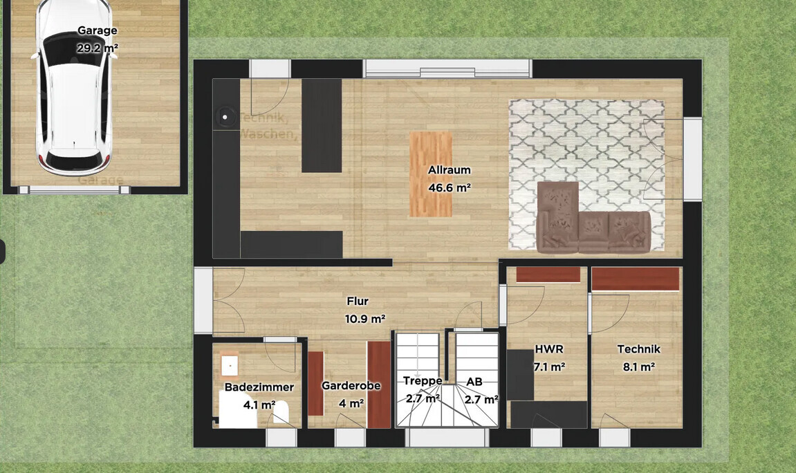

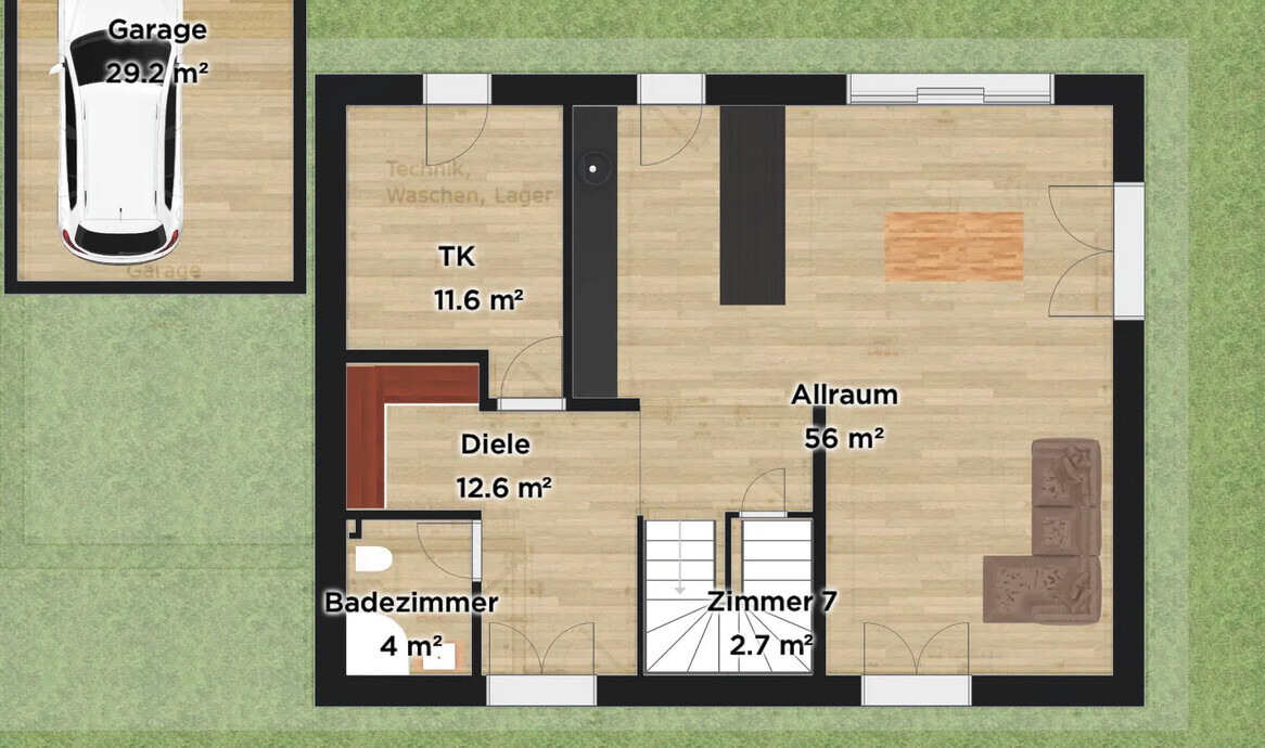

@-Malte- This is how your ideas might look in my version. Maybe there is something here that suits you.
If the garage is moved back (the building envelope allows for this), you can also create a side entrance. This would be my version 2 for you.
However, I want to mention that having a central gable usually imposes some constraints. This often makes the upper floor a bit awkward in a single-story house.
I wouldn’t enclose the kitchen or use false doors/pseudo islands. I would rather do that with the living room. But it’s not necessary! You can zone spaces well with a large rug.
My favorite option for you would be version 2. It’s a well-thought-out design. Whether or not you want to separate the hallway with a door is up to you. I find it ideal as it is. Also, your concern about not having enough storage space in the freezer/laundry room is addressed well. The layout is practical and functional.
Here is a top-down view to illustrate.

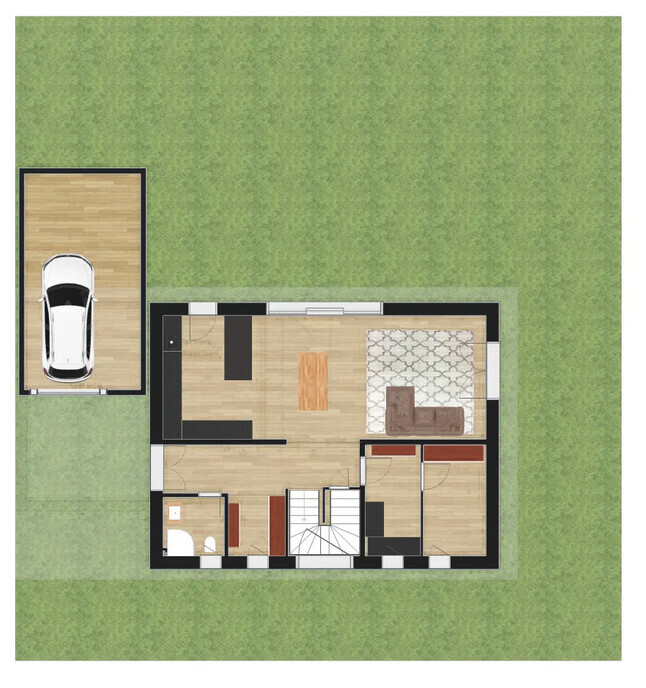

-Malte- schrieb:
We spent the past two weeks reviewing standard floor plans to develop an idea that we can then discuss with the architect and use as a basis. We would really like to get your feedback beforehand to see if this is generally going in a sensible direction.Putting an architect on the (almost always wrong) track with specific example floor plans is never a sensible approach. In fact, this is often listed as the number one most discouraged idea here. Proven building concepts are only truly beneficial when the person who tested them also executes the build. Conversely, blindly copying them—such as building the Huber house by Meier or vice versa—is consistently a recipe for serious mistakes.https://www.instagram.com/11antgmxde/
Putting an architect on the (usually wrong) horse with specific example floor plans never leads in a useful direction However, as you can read, the original poster actually got on a donkey. Moving from the slow donkey to a galloping horse may not only be brave but also sensible, although it is not something everyone can handle.
Wow, many thanks @ypg for your work and valuable suggestions! We really like your latest design. In fact, we had sketched a side entrance in almost the same way a few days ago ourselves. Currently, we also have a side entrance and are fans of it.
Our design from a few days ago, before we knew yours:
We had swapped the cloakroom and guest toilet compared to your design (probably not as favorable for natural light in the hallway as yours). Otherwise, living room and kitchen were also switched. Our layout had the advantage that the kitchen is directly next to the pantry, and we planned a light strip or some kind of window integrated into the kitchen unit. The disadvantage of our layout regarding the living area is that the sofa is placed with its back to the rest of the space. We like your layout better in this respect. Did you size the house roughly the same (about 12m (39 feet) * 9m (30 feet))?
Ultimately, we initially dismissed the idea of the side entrance and didn’t include it in the discussion here, because we felt that the long hallway was not as charming as the entrance from the front. In our drawing, the hallway is 6.7m (22 feet) long and we planned it to be 1.6m (5 feet) wide. Don’t you see a risk that it might feel “tunnel-like”?
A significant factor is probably the passage to the open-plan living area, which you designed wide and completely open. That surely works great during the day, but in our current house we miss the option to close off the living area to the stairs in the evening when the kids are sleeping and guests are over. I think it would be important for the spatial feel to design the passage from the hallway to the open area generously. What would be sensible options here? A large sliding door running along the hallway side? A standard door opening towards the sofa combined with a fixed glass panel or similar? Whatever door design is chosen, it would presumably be open most of the time and therefore should not get in the way.
Malte

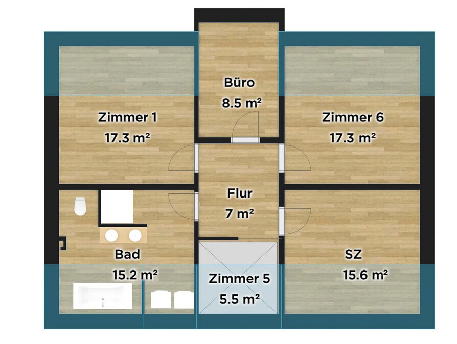

PS: Of course, we would be very happy and grateful if you could also take a look at the upper floor to match the sketched ground floor 😉
